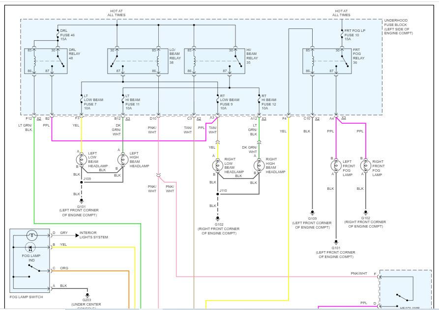

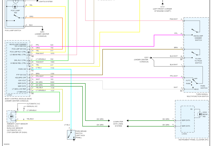

I turn off my auto lights in the daytime and my headlight switch is not working. The only time my lights go on or off is when I turn the car on or off. Also, my third brake light is not working so I wasn't sure if this is connected together.
Mar 17, 2023 at 7:49 AM
  • 110,194 POSTS
Do both the high and low beam work or is it just one or the other? This is with the switch off. I ask because each beam has its own relay which may have failed. I attached the headlamp wiring schematic below (pics 1 and 2)

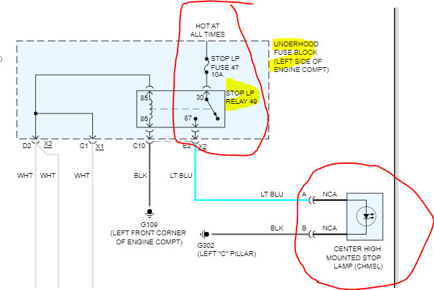

Next, I went through the headlamp schematics and there doesn't appear to be any correlation with the third brake lamp. See pic 3. Once again, there is a relay and fuse.

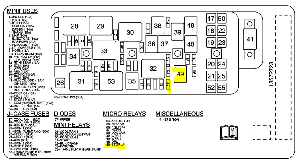

Check the fuse and relay in pic 4 (under-hood fuse box).

Hi Joe! Thanks for responding. Yes, it was just the low beam bulb. My husband and I just replaced the bulb yesterday and it seems to be working just fine. I did purchase a new headlight switch as I am not able to turn the lights on and off with the switch. Hopefully that is the problem! I really appreciate your help!
