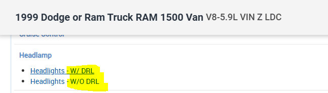

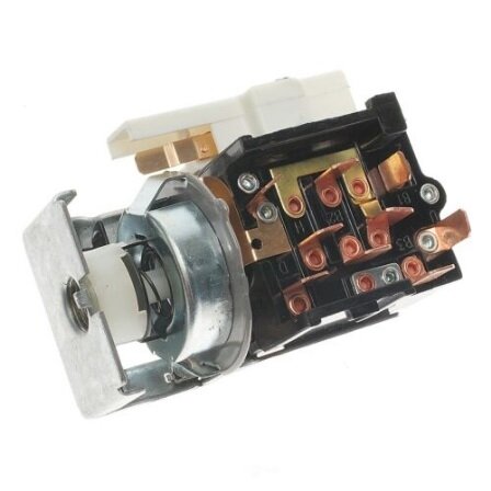

I'm requiring a headlight switch wiring diagram with colors. The GN/WT feed got really hot, and I don't know why. The RD/WT got really hot too and I don't know what that wire feeds.
Nov 23, 2024 at 2:45 AM
  • 110,244 POSTS
I need some general information from you. First, is this a full-size van? Also, I need to know if you have daytime running lights (DRL) or not. The wiring schematics are different. See pic below.
Let me know if the wires you mentioned get hot only with the lights on as well.
See pic below.

This is a full-size van. And too does it have daylight running lights. 1999 Dodge Ram Van Wagon B3500 is a complete description. It is in fact a full-size van. The wire that got hot is not the wire that feeds the headlight. I have ordered a new headlight switch. I will now figure this out on my own. Thanks!

Nothing above indicated this is a B3500 van. It says wagon. People refer to caravans as wagons. Also, the B3500 came with both with and without DRL. If you provide that information, I can get you the schematic you need. If you decide you don't need them, that is fine, too.

Now please allow me to make another comment for the benefit of others researching this topic. Do not get angry when I mention the connector. I see you are going to replace it. The problem with most competent do-it-yourselfers is they do not understand the need to replace the overheated terminals. They find the defective switch but go only as far as replacing it. That will work for a while, but eventually the burned connector terminals will create excessive resistance which translates into heat. That heat migrates into the new switch's contacts and causes a repeat failure over time. The same thing happens quite often to ignition switches and a little less to dimmer switches. I've done this repair to dozens of '90s front-wheel-drive vehicles.
When it comes to replacing the connector, for us, time is money. To keep the customer's bill down, it is common to reuse the old connector after cutting out the melted cavities. Cut off at least four inches of the two old, overheated wires because solder won't adhere to those hardened sections. You need to go back to nice shiny copper. Solder on new sections of the same diameter, then use a pair of universal crimp-style terminals, but solder them too for the best connection. Plug those two terminals onto the switch individually.
If the thought of a chopped up connector body doesn't sit well with you, consider that the terminals in the new connector are usually the same style as the old ones. Instead of cutting and soldering all the wires, it's faster to pull the good terminals out of the old connector body, and pop them into the new one. The two that need to be replaced will already be on the new connector with a few inches of wire, so those are ready to splice.
Before splicing any wires, slide on pieces of heat-shrink tubing to seal the joints. Never use electrical tape as it will unravel into a gooey mess on a hot day. For this application, the heat-shrink tubing doesn't have to be the moisture-proof kind. The backs of the terminals are already exposed, so sealing out moisture from the splice has no advantage.

I did purchase a new switch from eBay. I ordered a new connector from O'Reilly's, but on second thought, I will abandon that $40+ charge and go with individual crimp-on terminals that are soldered and heat shrunk. For proper placement, I will keep a diagram in the glove box in my maintenance book. I would never use an old, overheated connector, as the terminals have been annealed and could never provide a proper connection and further, lead to yet another failure or maybe fire. The Van is 25 years old. I replaced the water pump, only to have it start leaking again. All the plastic pieces are breaking from age. I'm replacing the rotary switch that controls the rear fan motor. Luckily serendipity stepped-in and I found a nice heavy duty one on Amazon on the first try. All these automotive problems I'm having are caused by an external and invisible agency.

You have the assessment of overheated connector terminals correct. Most people don't understand that, but a detailed explanation usually takes care of that. The same thing happens to heater fan speed switches when they're carrying the full motor current. Newer models do that with a tiny switch and a computer module. The most common place I've seen this is with ignition switches. They appear to cause the most trouble for people in the habit of turning the ignition switch on or off while the heater fan is set to one of the higher settings. Switching that much current on and off leads to a lot of arcing on the ignition switch contacts. There's usually three or four separate switches built into the ignition switches, so the engine will still crank and run. It's the "accessory" circuit that fails, with the heater fan, radio, and wipers as the most noticed dead systems.
