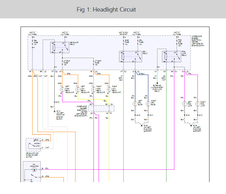

Headlight schematic
1999 CHEVROLET 1500
298,000 MILES • 5.0L • V8 • 4WD • AUTOMATIC
JJMISH
Weird flickering problem.
Sep 15, 2019 at 1:01 AM
SCGRANTURISMO
  • 4,897 POSTS

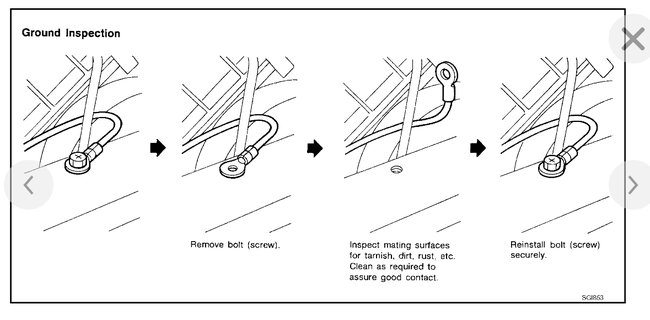

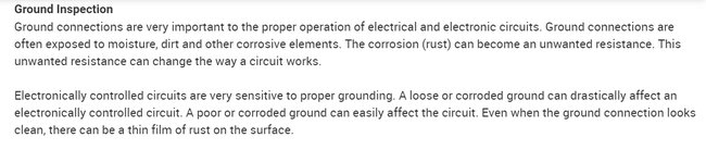

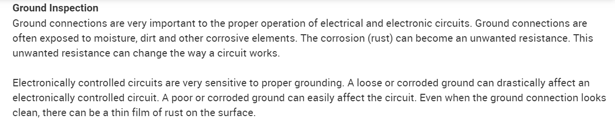

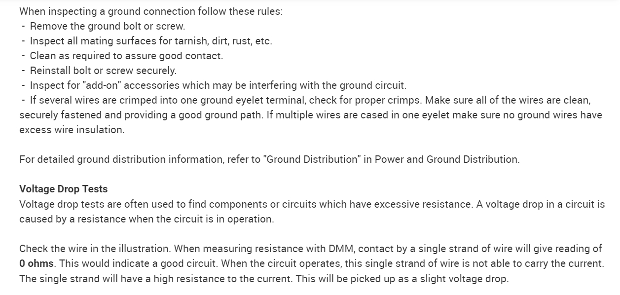

This could be a problem with Ground 202 under the left side of the dash. In the diagrams down below I have included a wiring diagram of your vehicle's headlight circuits and a guide on how how to inspect ground connections. Please go through these guides and get back to us with what you are able to find out.
