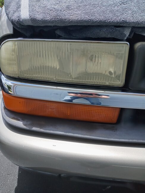

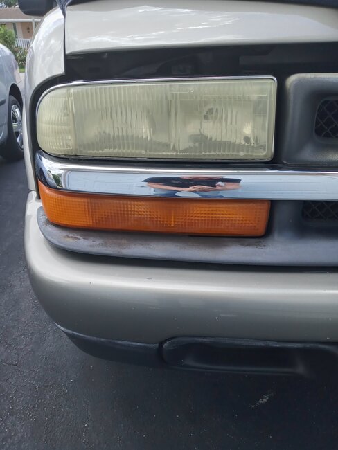

Trying to remove grille which requires headlight removal. I had a bit of a hard time getting the drivers side out and spent 30 minutes trying to get the two vertical tabs back into the slots and then putting back the two removable slides after it is seated back in. Your can't even tell if they are in the slots. Very poor design and if they just gave you another 1/4" it would have made all the difference. Now?I went to the passengers side and the battery had to come out first. Tried to remove that but it doesn't want to come out either. I can't see any way if I get it out where I could view those slots to put it back in so I reseated it and wondering how the hell Im going to get it out and back in without breaking something. Just another s*** design by GM.Any help would be appreciated. Went on youtube and they make it look easy but not for me.

With the retainers off the light tips forward and up at the same time. Then to put it back the tabs go in and you rock the light into position and line up the upper latch posts. Unless someone has replaced parts with aftermarket they almost fall together. Can you take a picture of the light and the front of the truck so we can see if it's stock or something else?
Aug 17, 2026 at 2:34 PM
ROBERT WALBROEHL
  • 122 POSTS
Picture of headlight. Left hood open as sun burns the paint in south FL. And I cover it with a towel. Hopefully you can see enough.

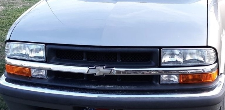

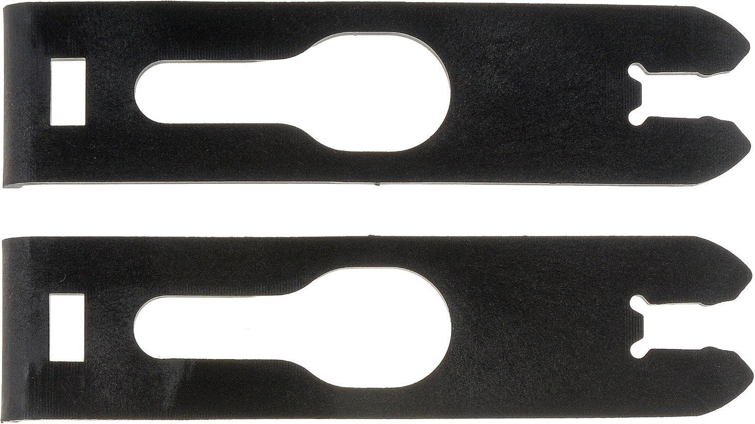

Have the same light design on my 02 Blazer. Actually replaced the turn lamps on mine with ones from an Oldsmobile Bravada as those had built in fog lamps (see picture) I can pop the lights out of that truck in a couple minutes just by pulling the retainers. Never touched the battery or anything but the retainers shown in the other picture. They pull up and then off the tab on the light, then the light pulls out and up as you tilt them forward and pull the tabs out of the support.

Not problem getting the retainers out. I did that on both side in 5 minutes. But tilting the light forward seems to hit at the top and will not pull out.

The Olds Bravada, Chevy Blazer and GMC Jimmy in the S Series are all the same vehicle with some minor trim differences. Just like the Chevy and GMC trucks are the same thing with different options. 99.9% of the parts will interchange. The biggest change in the Bravada is that it was sold to a more "sedate" crowd so that instead of having the shift on the fly 4X4 they put and AWD transfer case in it.
The lower tabs come out last and on install they go in first, the light won't even go into place if they are not in. As for the sticking, just push down as you pull out. The holes in the panel are a tight fit sometimes and they don't just fall out.
