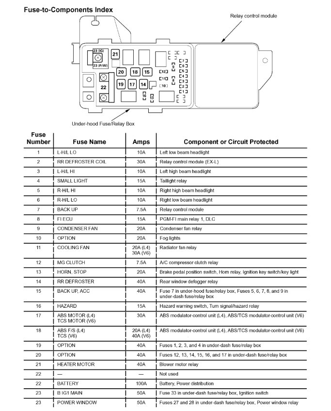

Trying to check the right headlight relay, but I cannot find it
2004 HONDA ACCORD
133,357 MILES • 4 CYL • FWD • AUTOMATIC
ANGEL HINOJOSA
Trying to check the right headlight relay, but i cannot find it. Where is the relay for my right head light located?
Feb 9, 2017 at 12:07 PM
HMAC300
  • 48,601 POSTS
there is only high and low beam relays check fuses five and six under hood fuse box. if not that then it may be a ground or bulb issue. It may also be your multi function switch on steering column which a mechanic should check if everything is okay elsewhere. Here is a guide to help test it and the headlight relay location in the diagrams below.
