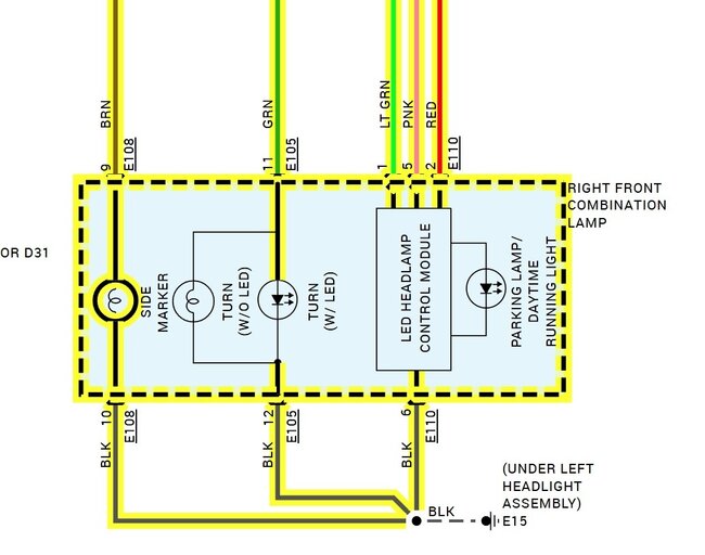

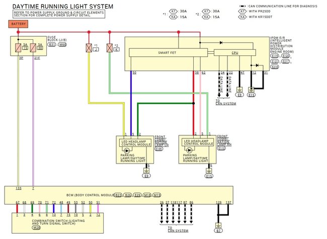

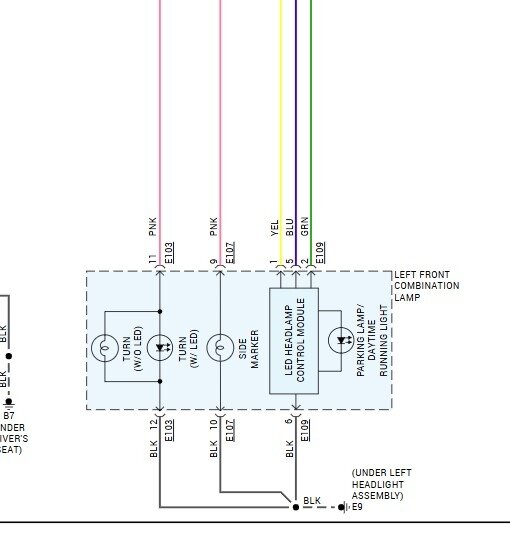

DRL went out and gave warning on dash. Ordered new, found out fuse is blown and blew a second when replaced. Plug going into headlight got hot, lack wire going in seem to be melted. Possible short? Anyone have a wiring diagram. It’s a job to pull front clip off of car to trace and replace light housing.
Aug 16, 2025 at 1:09 AM
STEVE W.
  • 15,423 POSTS
This is the OE diagram for the system. Which fuse was blowing? Which side of the DRLs is going out? From the diagram it looks like the issue could be a bad lamp module.

Passenger side, installed new lamp as well, black wire coming from harness is one that got hot and melted coating.
Aug 16, 2025 at 6:58 AM
STEVE W.
  • 15,423 POSTS
OK, the Black wire is a ground, Did the wire get hot before you replaced the lamp? If the module shorted out it might have started pulling a lot of current and melted the ground. Does the fuse open or the wiring get hot with the replacement lamp or was that with only the original lamp?

OK, from that description I'm thinking that the wire got hot enough that it melted through somewhere in the harness and is now a dead short. The only way to figure out where would be to strip open the harness to find the bad location. The problem is that it could be shorting more than one wire. If you look at the wires can you determine which pin the burnt wire connects to? It might be possible to find where the other end of it connects to and disconnect it there and see if the short goes away.

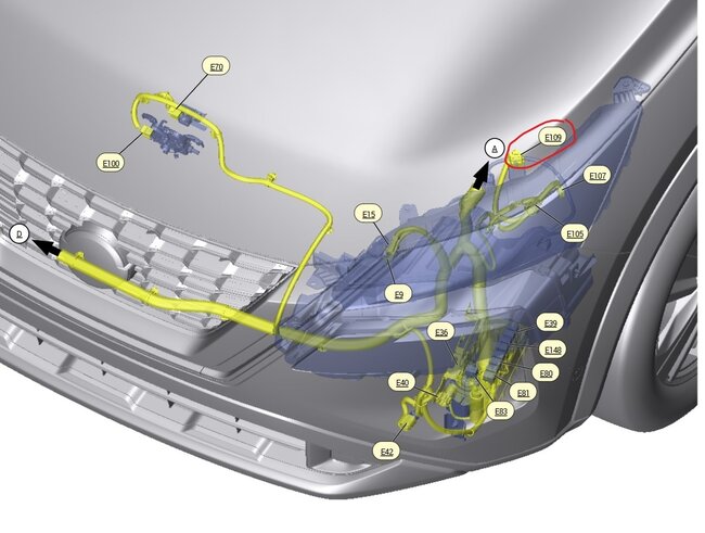

E109 it seems
Aug 17, 2025 at 10:15 PM
STEVE W.
  • 15,423 POSTS
OK that one goes into a splice and then out to the ground point under the headlight. It's a mess but I would open up the harness and trace it to the opposite end. That would be the only way to be sure it isn't causing other problems. Then run a new wire from the terminal on the light to a good ground and see if the light now works. If it still gets hot it could be that the replacement is defective. Not an uncommon thing with aftermarket parts. I've seen new parts that were wired wrong.
Aug 17, 2025 at 10:36 PM
ARCBURN84
  • 8 POSTS

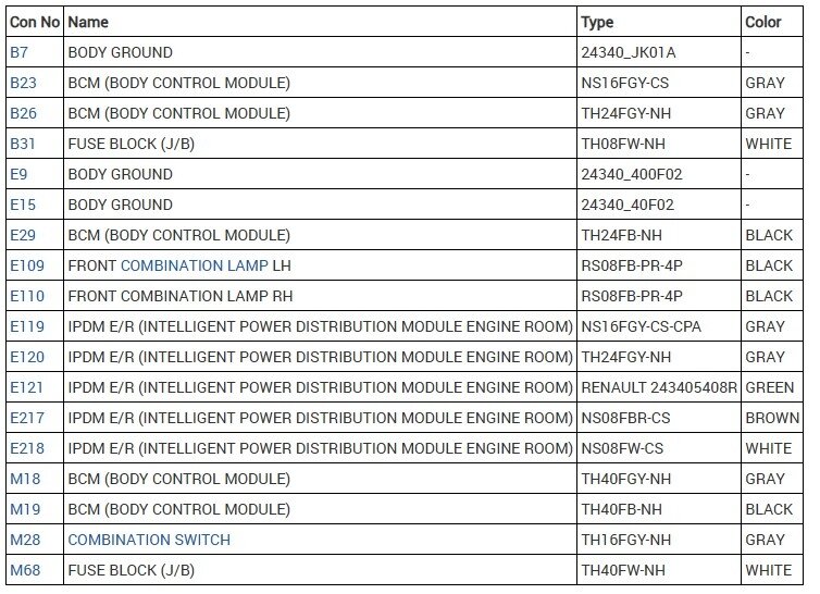

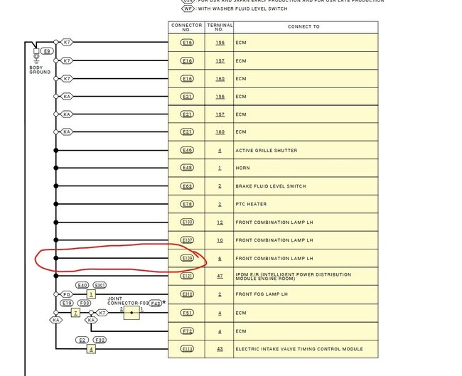

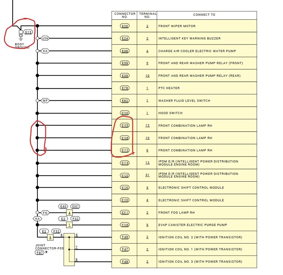

The second photo shows E109 on the drivers side, is that accurate or just the same on both
Aug 18, 2025 at 1:18 AM
STEVE W.
  • 15,423 POSTS
Both sides end up at the same ground point. I just grabbed the least cluttered side for you. The ground on the right side is E110 pin 6, goes from the light to a splice and across the car to the E15 and E9 ground point, basically everything on the harness goes those two points, which set next to each other, but they don't show where the actual splices are unfortunately.

Garage said that when the headlight was bypassed it quit blowing fuses and quit getting hot that’s why they said it’s in the headlight. We’re getting the car back and will try to order headlight. Is there a reputable aftermarket company or do I need to spend twice as much for an oem headlight!?

So after a lot of back and forth testing ruled out the wiring and found the headlight unit to be at fault, I’ve since replaced and put all back together but I’m out of the 15a Mcase fuses, would it hurt to run a 25a or 30a until the ones ordered come in?
