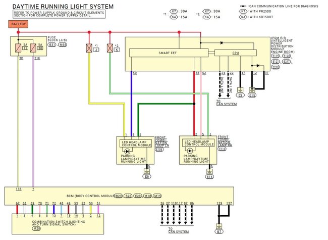

DRL went out and gave warning on dash. Ordered new, found out fuse is blown and blew a second when replaced. Plug going into headlight got hot, lack wire going in seem to be melted. Possible short? Anyone have a wiring diagram. It’s a job to pull front clip off of car to trace and replace light housing.
Aug 16, 2025 at 1:09 AM
STEVE W.
  • 15,349 POSTS
This is the OE diagram for the system. Which fuse was blowing? Which side of the DRLs is going out? From the diagram it looks like the issue could be a bad lamp module.

OK, from that description I'm thinking that the wire got hot enough that it melted through somewhere in the harness and is now a dead short. The only way to figure out where would be to strip open the harness to find the bad location. The problem is that it could be shorting more than one wire. If you look at the wires can you determine which pin the burnt wire connects to? It might be possible to find where the other end of it connects to and disconnect it there and see if the short goes away.

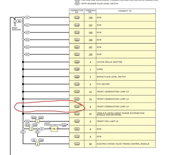

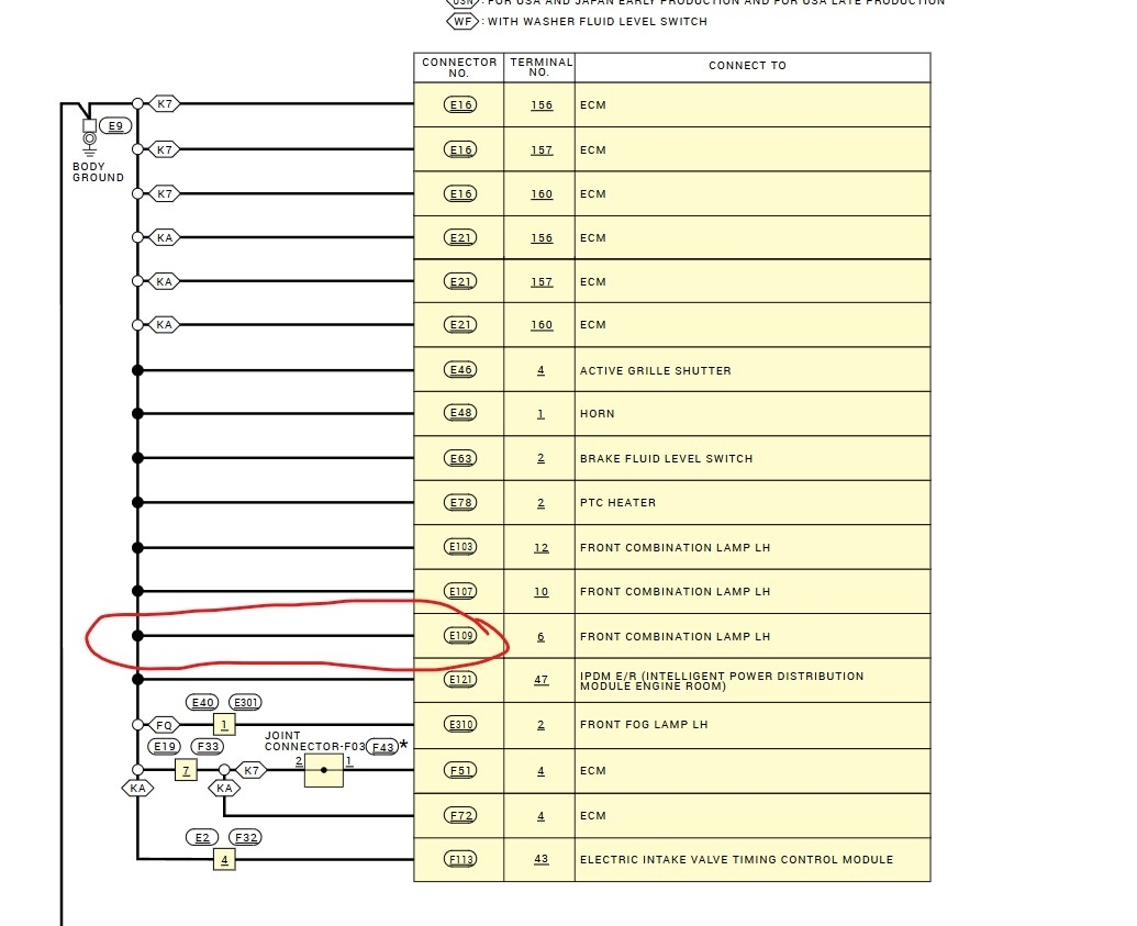

ARCBURN84
  • 8 POSTS

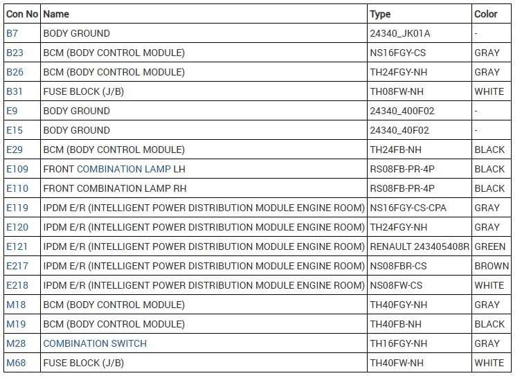

E109 it seems
Aug 17, 2025 at 10:15 PM
STEVE W.
  • 15,349 POSTS
OK that one goes into a splice and then out to the ground point under the headlight. It's a mess but I would open up the harness and trace it to the opposite end. That would be the only way to be sure it isn't causing other problems. Then run a new wire from the terminal on the light to a good ground and see if the light now works. If it still gets hot it could be that the replacement is defective. Not an uncommon thing with aftermarket parts. I've seen new parts that were wired wrong.
Aug 17, 2025 at 10:36 PM

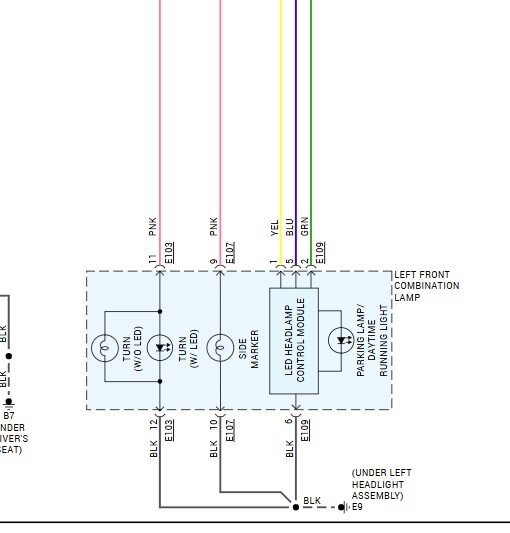

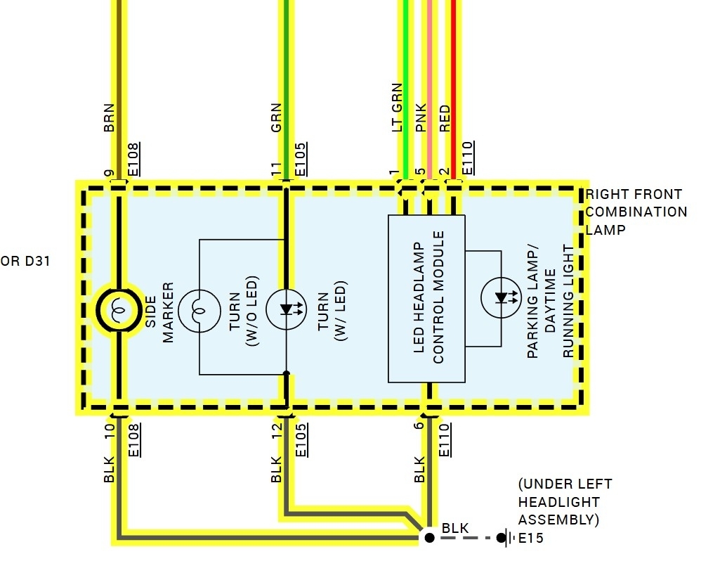

ARCBURN84
  • 8 POSTS

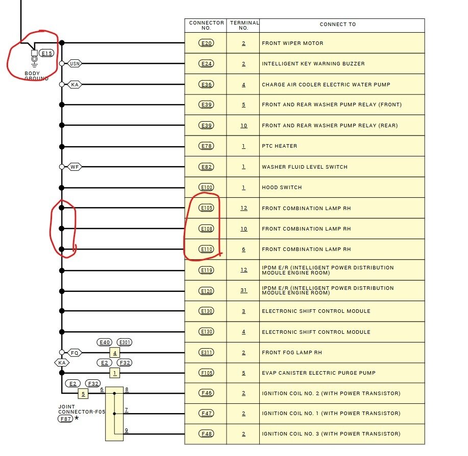

The second photo shows E109 on the drivers side, is that accurate or just the same on both
Aug 18, 2025 at 1:18 AM
STEVE W.
  • 15,349 POSTS

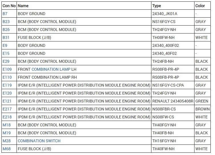

Both sides end up at the same ground point. I just grabbed the least cluttered side for you. The ground on the right side is E110 pin 6, goes from the light to a splice and across the car to the E15 and E9 ground point, basically everything on the harness goes those two points, which set next to each other, but they don't show where the actual splices are unfortunately.
Aug 18, 2025 at 2:50 AM
