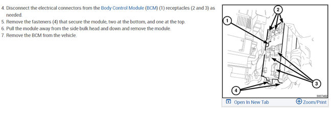

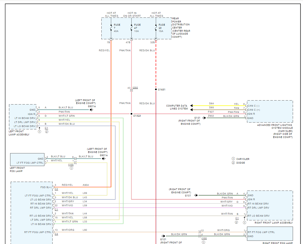

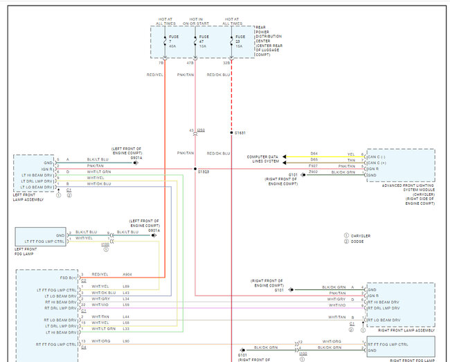

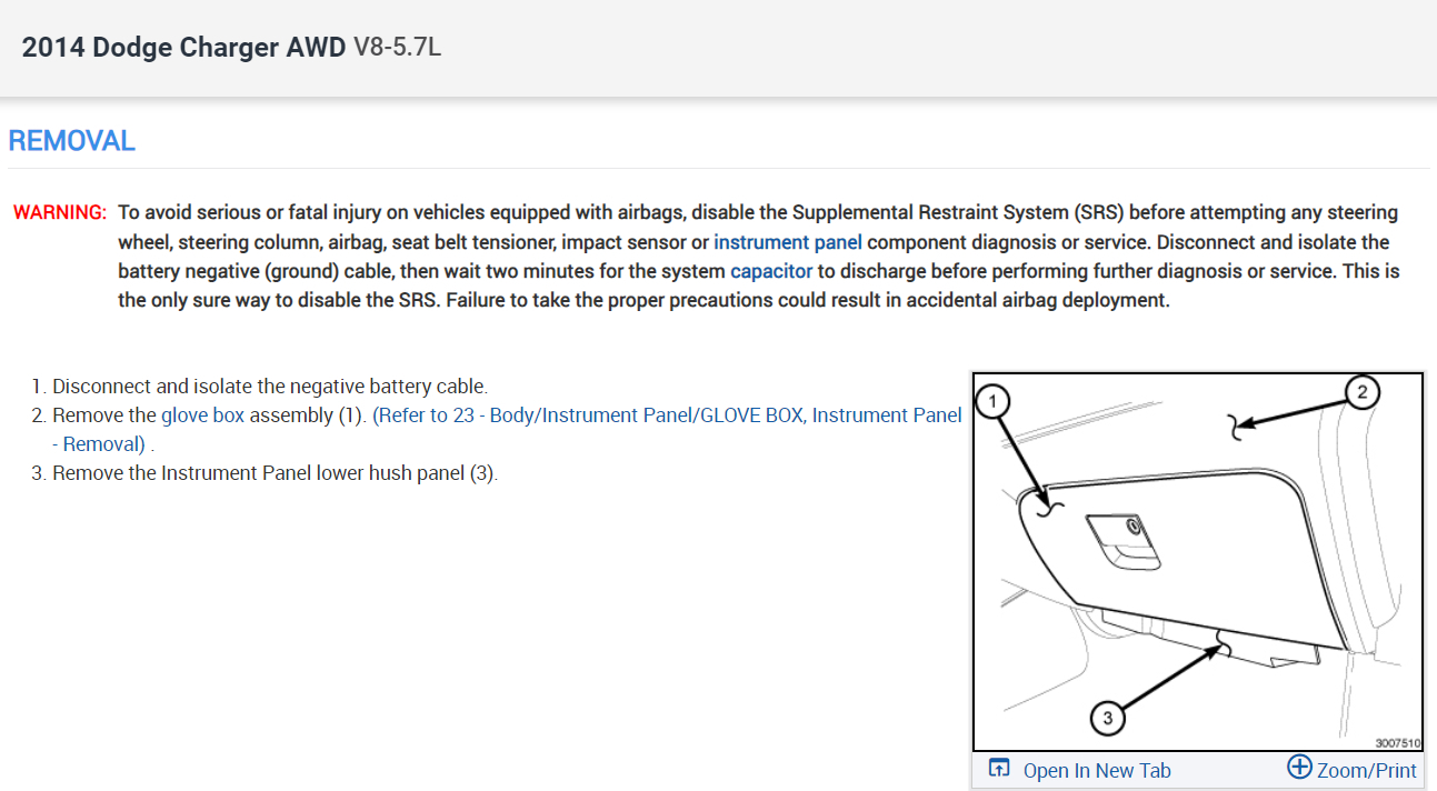

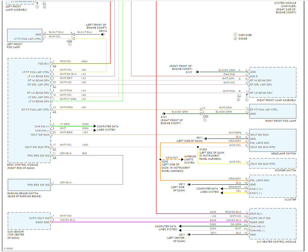

Yep, it sounds like the BCM has gone out, to be sure we should do a CAN scan which will have trouble codes stored, or you have a bad ground or connection at the headlight. You can get a CAN scanner (Controller Area Network) which will work on most cars from Amazon.
https://youtu.be/u-4syLc-ifQ
Here is a guide that will help you test for power and ground for the headlight, if the ground is good and there is no power chances are the BCM need to be replaced, here is the headlight wiring diagrams so you can see how the system works and I have included the location of the BCM and how to change it out. You can get a preprogrammed unit by searching Google or Ebay.
