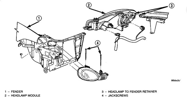

One of my headlight lens is broken. Can I replace just the lens or do I have to replace the whole light?

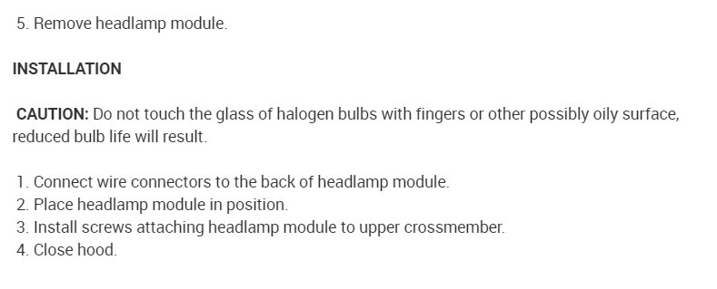

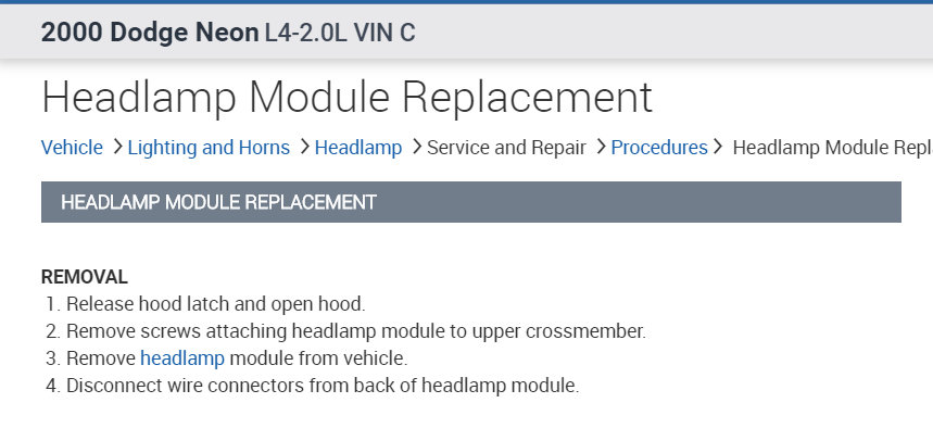

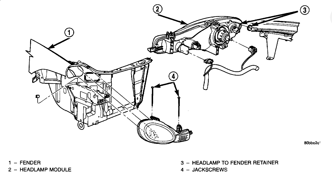

No, you can just replace the headlight module and not the bulb if you want. They are two separate parts. When handling the bulb, make sure not to touch the glass of the halogen bulb, it will greatly diminish the it's life expectancy. I have included step by step directions for the removal and installation of the headlight module in the diagrams down below. Please get back to us with how everything turns out.
