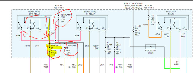

I changed the bulb and every­thing looks good, but the low beam would not work.
I'm thinking this is a pigtail problem, but just wanted to check with the experts to make sure.

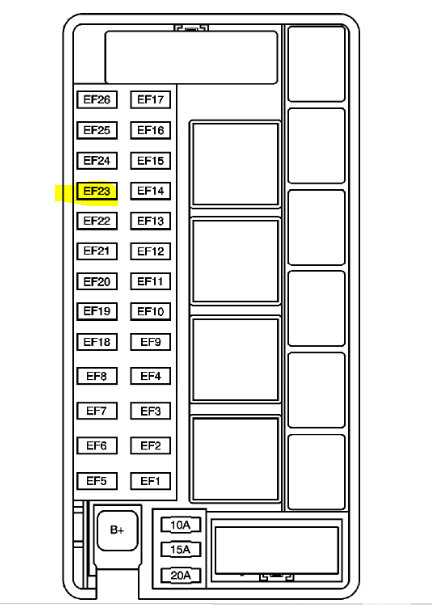

Each light has two fuses, one for low and one for high beam. Locate the fuse box under the hood.
Locate fuse EF23. That fuse is dedicated to the left low beam only. See pic below. When you check the fuse, make sure power is present on both sides.
Also, the headlamp low beams must be on for power to be present at the fuse.
Let me know what you find.
See pic below.

If the right low beam works, then either you have a faulty bulb, a wiring problem, or a connector issue. I say that because although both left and right low beams have their own fuses, power comes from the same place. The low beam relay.
Were you able to confirm there is power present at the fuse?
See pic below.

The pigtail behind the headlight was the issue. Replaced it, and everything is good.
