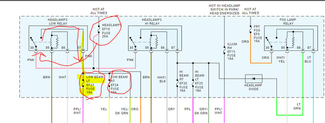

The driver side headlamp is not working?
2008 CHEVROLET AVEO
173,000 MILES • 1.6L • 4 CYL • 2WD • AUTOMATIC
RPJ
  • 109 POSTS
I changed the bulb and every­thing looks good, but the low beam would not work.
I'm thinking this is a pigtail problem, but just wanted to check with the experts to make sure.

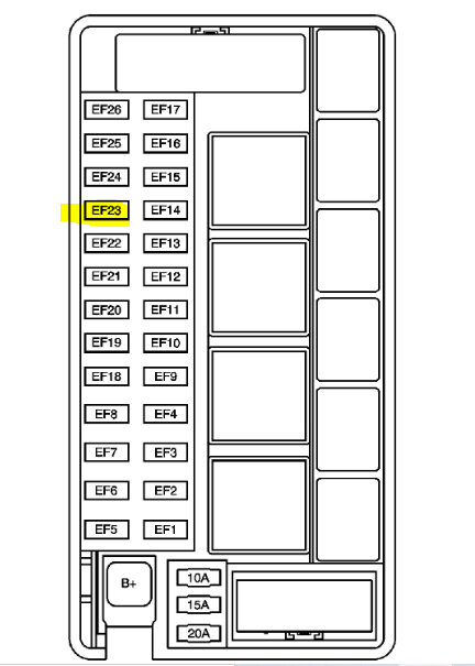

Each light has two fuses, one for low and one for high beam. Locate the fuse box under the hood.
Locate fuse EF23. That fuse is dedicated to the left low beam only. See pic below. When you check the fuse, make sure power is present on both sides.
Also, the headlamp low beams must be on for power to be present at the fuse.
Let me know what you find.
See pic below.

Hello Joe,
I replaced the 10A fuse that's for the Driver's side headlight, but still it does not operate, Either in daytime headlight mode or when headlights are on. The high beams work though.
Is it time for an electrical check at a repair shop?

  • 110,241 POSTS
If the right low beam works, then either you have a faulty bulb, a wiring problem, or a connector issue. I say that because although both left and right low beams have their own fuses, power comes from the same place. The low beam relay.
Were you able to confirm there is power present at the fuse?
See pic below.
