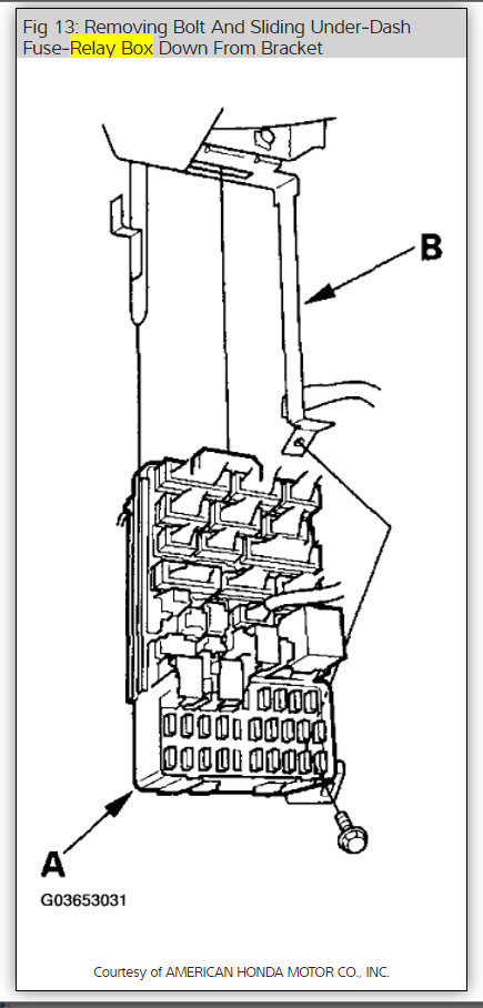

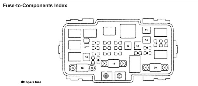

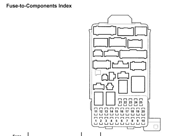

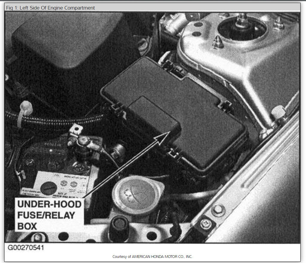

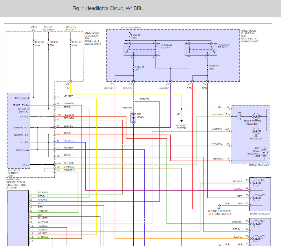

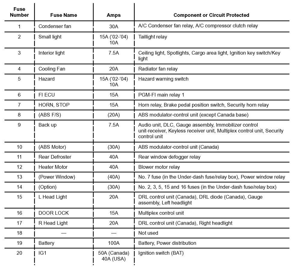

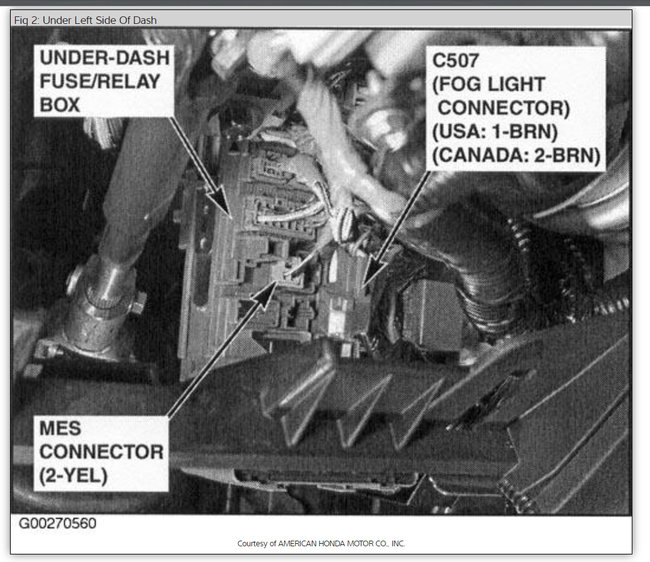

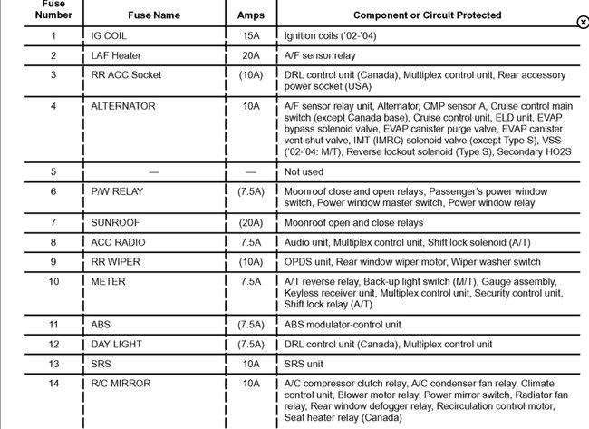

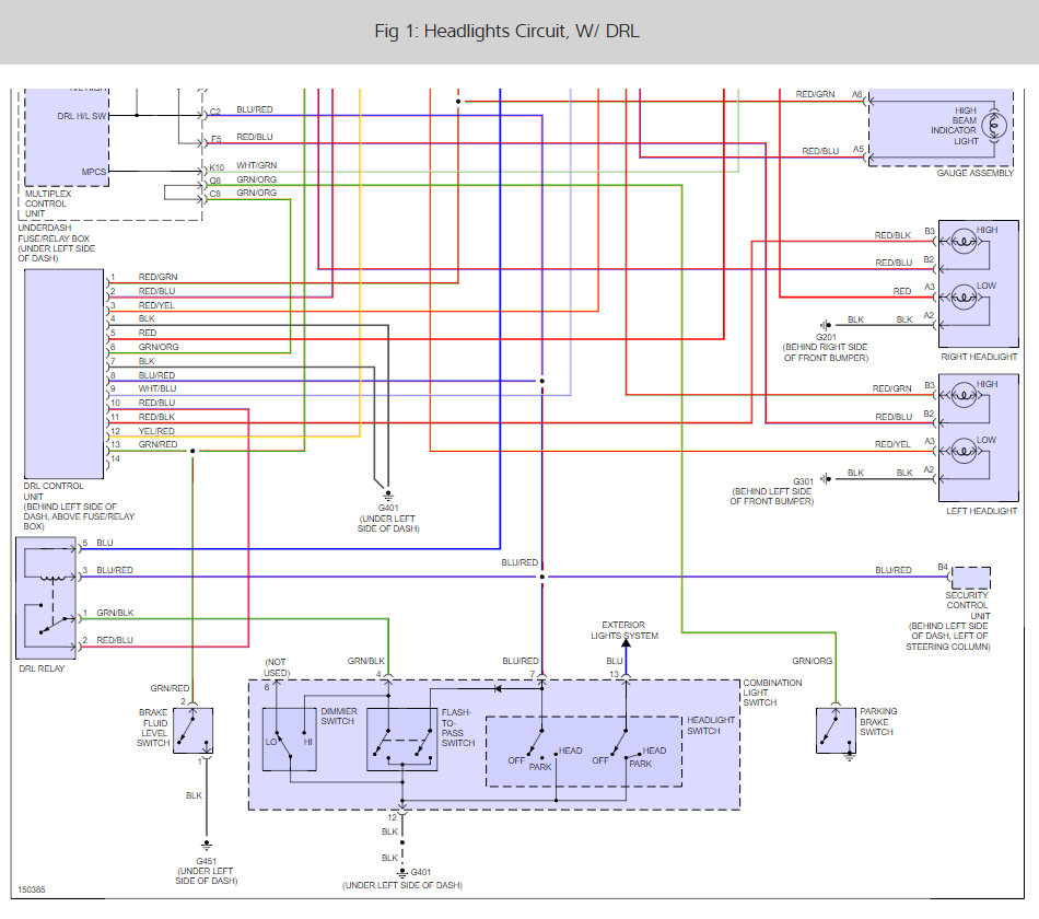

There are two relays and three fuses that run the system. Below are some guides and diagrams to help you run some simple tests and figure out what the problem is. Check fuse #12, 3 and 10.
and
If they check out test the power through the switch.

So I have tested all the fuses and the relays do appear to be working, so that all looks good. However, I did notice that fuses 15 and 17 in the under hood fuse box are not lighting the test light, despite supposedly always being hot. I have tried a new fuse in the socket and still it does not light the lamp. However, I have also found that the battery fuse is only an 80a although it's supposed to be 100a. Would this have any effect?
Oct 11, 2017 at 2:01 AM
  • 55,399 POSTS
I would replace the fuse but if it is not blown it will not effect anything. Are the relays activating when the headlights are turned on can you feel them click?

So I have confirmed that the fuses are getting power and the relays are good. However, I've noticed that when I turn the stick from drl to high beam, the high beam bulb on the passenger side come s on but dimly flickers, and the driver side on just flashes and quickly goes out. A single halo on the passenger side works as well. Could it possibly be a ground causing the flickering?
Oct 11, 2017 at 8:24 AM
MHPAUTOS
  • 31,937 POSTS
Check for any corroded earth terminals around the head light looms, check for loose or corroded head light plugs, the dim light may indicate a bad earth for the circuit.
Oct 11, 2017 at 10:14 PM
JJBURTON5
  • 27 POSTS
I assume you are referring to G201 and G301, which requires me to take the front bumper down, right?
Oct 11, 2017 at 10:35 PM
  • 55,399 POSTS
Yes, I would test for power output at the DRL controller it sounds like it has failed. Also it could be the amplifier for the headlight as well. We are loosing power somewhere keep testing until you find it. Test the switch as well use the wiring diagrams to help.
Oct 12, 2017 at 3:13 AM
JJBURTON5
  • 27 POSTS
I've heard these DRL modules are a common problem with the soldering joints breaking. I will be sure to check and let you know.
