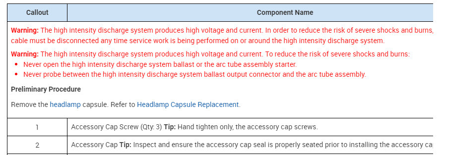

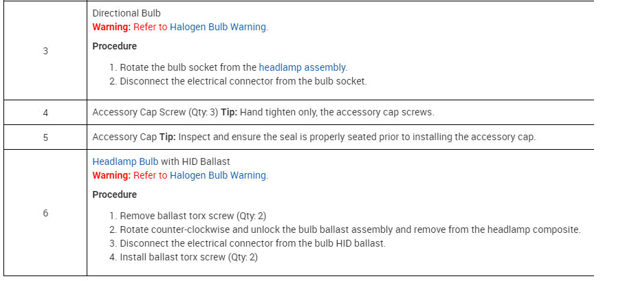

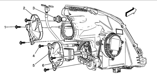

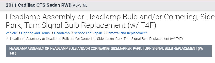

I can't take out the HID bulb.
Sep 27, 2023 at 8:41 AM
Experienced Mechanic
110,246 POSTS
Are you able to get it to turn 1/4 turn? Once that is done, it should wiggle out.
I attached the directions below. Take a look at them and let me know if they help.
See pic below.
