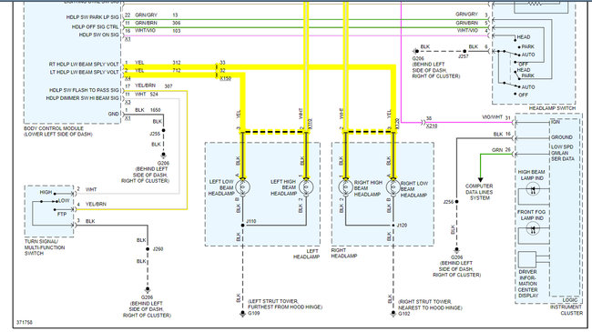

When I put a new one in it blows right away. Any suggestions on where to start to try to find the short in it? Or a route of which direction to go to find the short. Thank you
Friday, October 8th, 2021 AT 2:14 PM
  • 52,797 POSTS
Good evening,

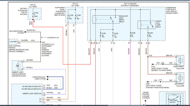

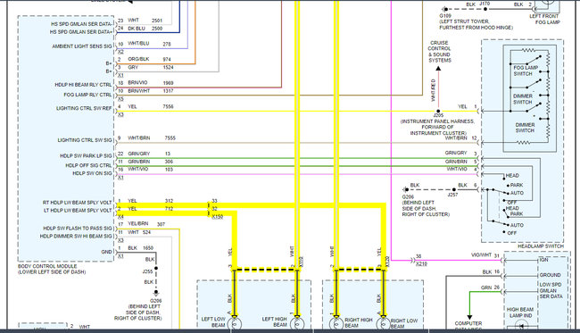

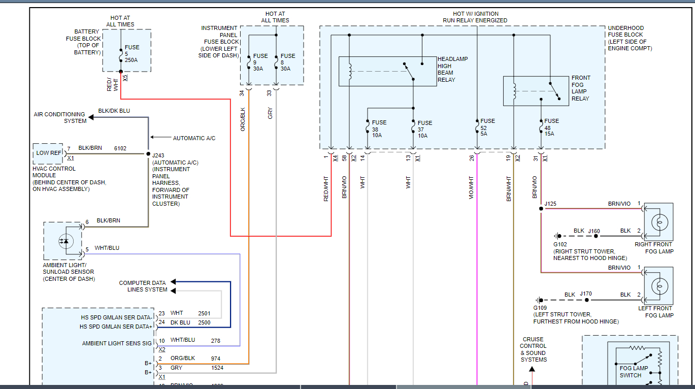

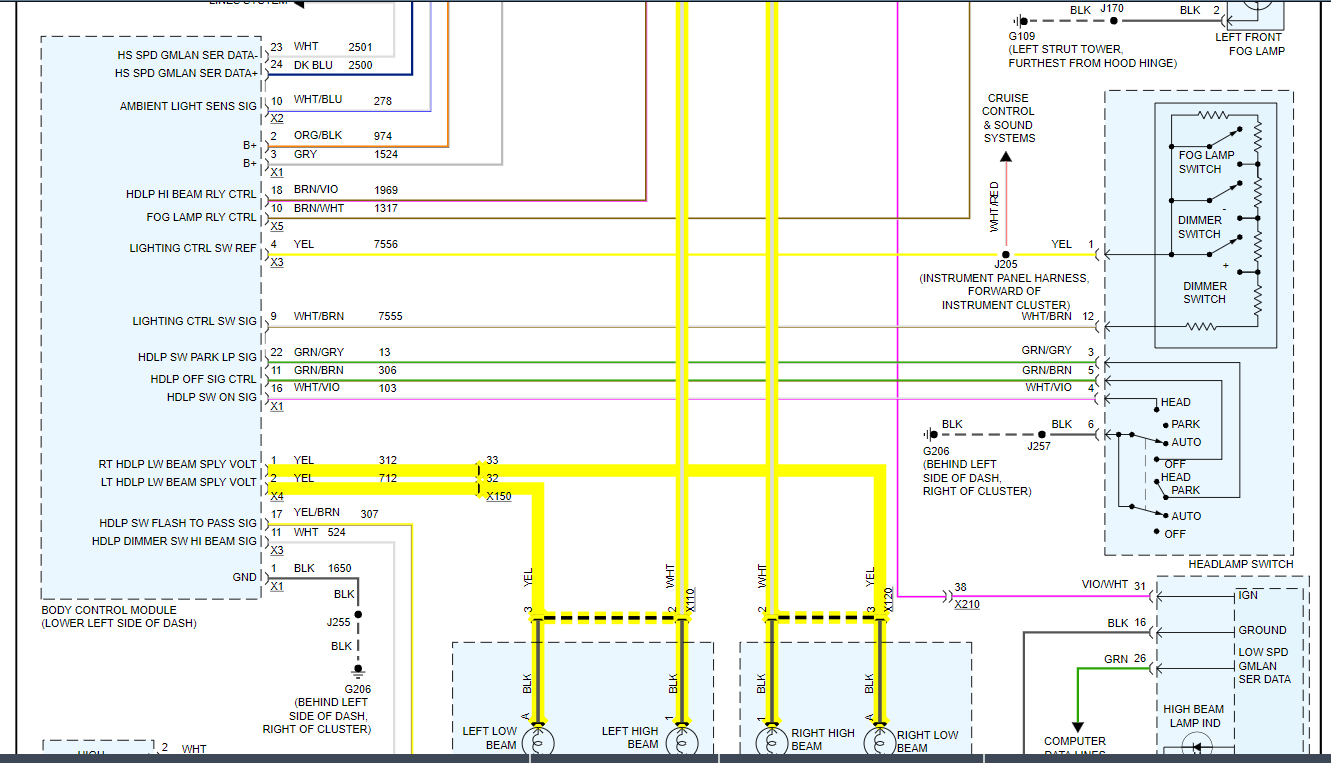

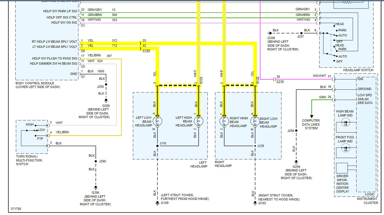

I attached a diagram for you to view. Please identify the fuse number that is failing so I can isolate the circuit for you.
I would start by disconnecting the headlights and see if the fuse still fails.
Once I know the fuse number, I can help you identify the failure. I attached some guides to help you with the checks. Let me know if you have any other questions.
