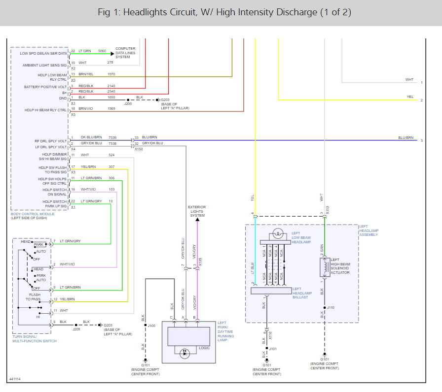

before i go searching, can anyone tell me, if my car came with factory fog lights, is the wiring still in the harness? i wanted to add them and change the headlight factory switch to the one with the fog switch. If their not there, then it's on to plan b.
May 3, 2020 at 11:08 PM
  • 55,433 POSTS

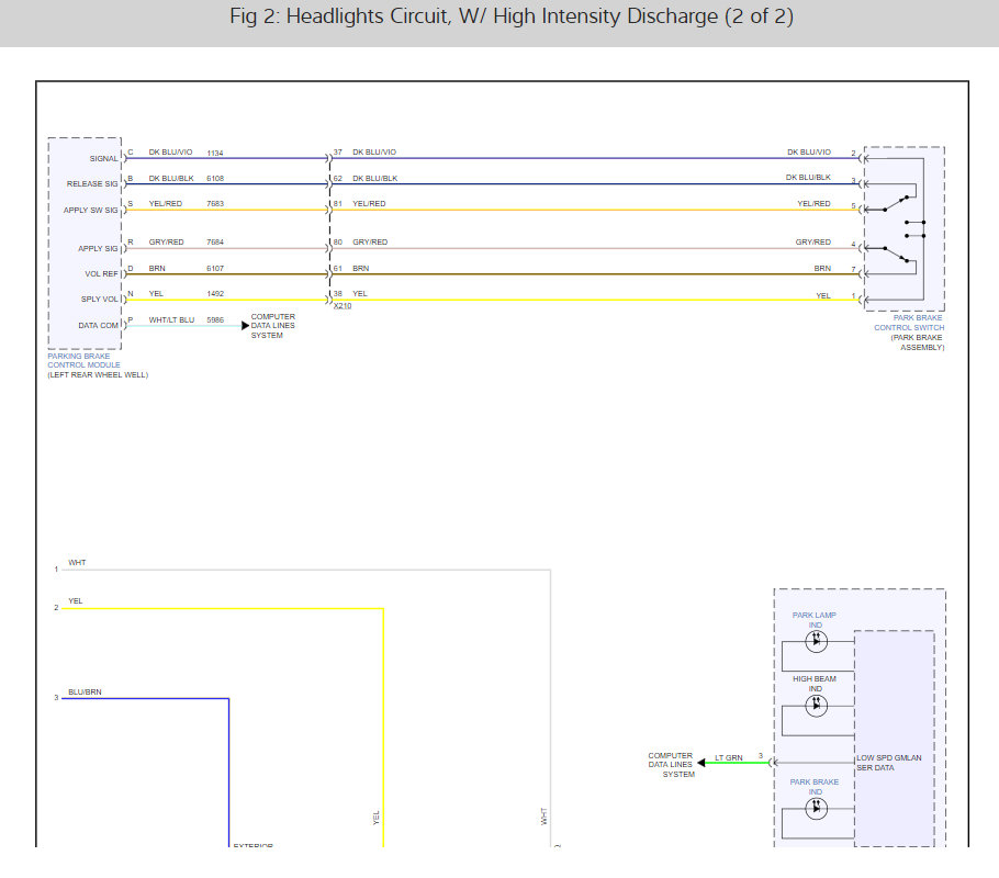

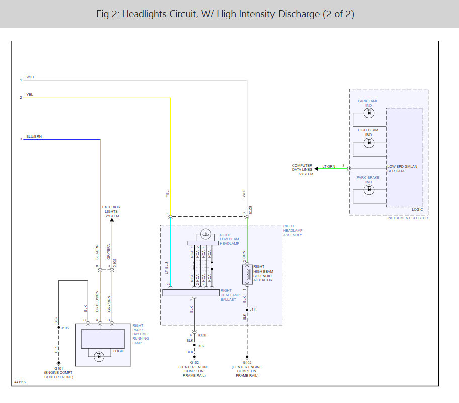

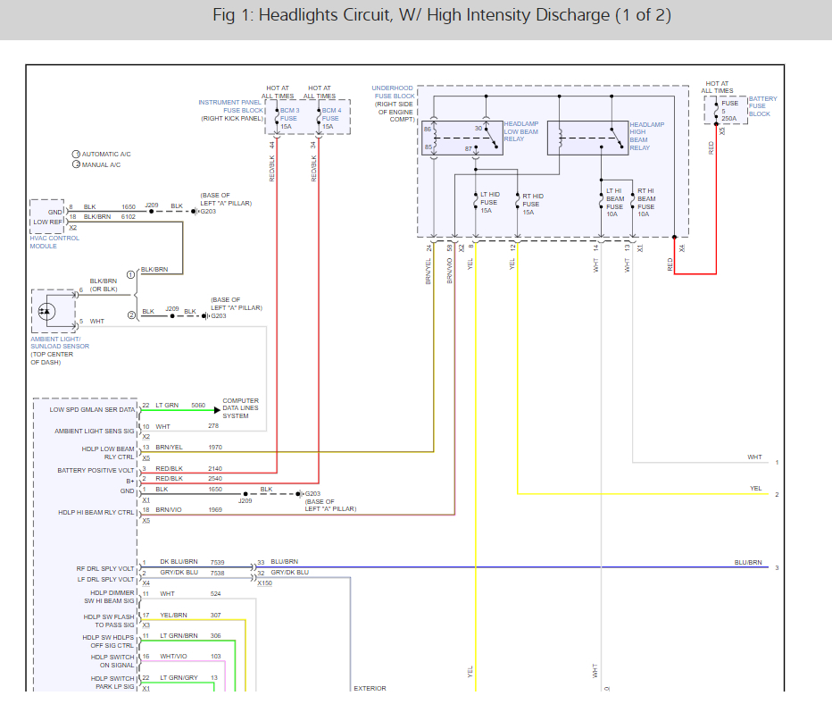

The wiring harness should be the same but the connector at the switch will be able to tell you, remove the switch to see if there are empty places where wires should be? Here are the headlight wiring diagrams so you can see how the system works. Check out the diagrams (below). Please let us know what happens.
