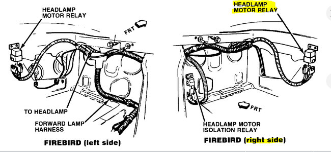

Turn on the headlights and the headlight open up, turn them off and both doors go down and then the one on the passenger's side goes back up. changed motors, and module still happens. the door stays up until I go under the hood and wind it back down.
Sep 11, 2022 at 8:29 AM
  • 110,248 POSTS
Have you checked the relay related to the headlamp motor? It has been a while since I worked on one of these, but it wasn't uncommon for the relay to fail and cause the lamp to reopen or close while driving. LOL
There are two relays to consider. One is the motor relay and the other is called an isolation relay. I attached a pic below showing locations under the hood.
Check both. Make sure they are mounted firmly to get a good ground. Also, I would switch one at a time with the opposite side that works to see if the problem moves to the opposite side.

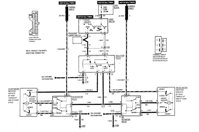

See pic below.
Sep 11, 2022 at 12:04 PM
STEVE W.
  • 15,418 POSTS
Looking at the wiring diagram it looks like either there is a short in the actuator relay circuit or possibly the gearing in the drive is failing. You say you switched a module, which one?
