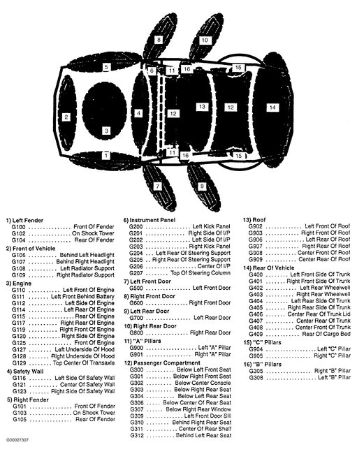

The Passenger side head light is dim and I need to know where to look to fix the ground wire problem both high and low beams are effected.
Feb 16, 2016 at 4:51 PM
CATAFINA
Experienced Mechanic
167 POSTS
Your ground point is G201 #6 Right side of I/P

On the passenger side fender is the ground for the passenger headlight
Feb 16, 2016 at 11:22 PM
CATAFINA
167 POSTS
That's what my reference says above-so go ahead and try that ground

Is it possible that the malfunction switch is causing my passenger headlight to be dim?
Feb 29, 2016 at 7:15 PM
CATAFINA
167 POSTS
You need to find that ground, it is very important that you do. I believe it goes through the dimmer switch.
