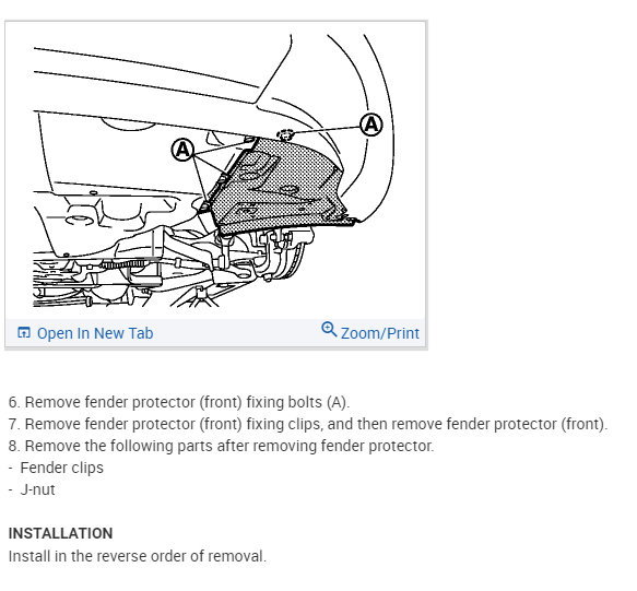

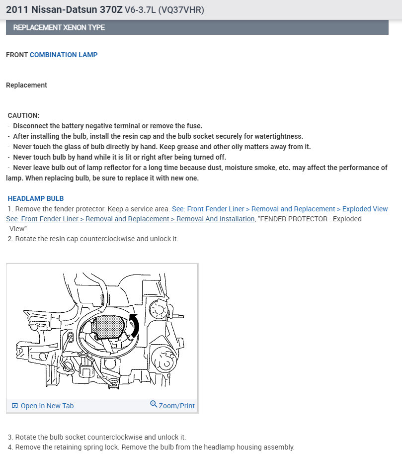

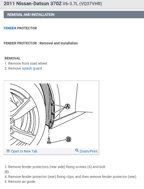

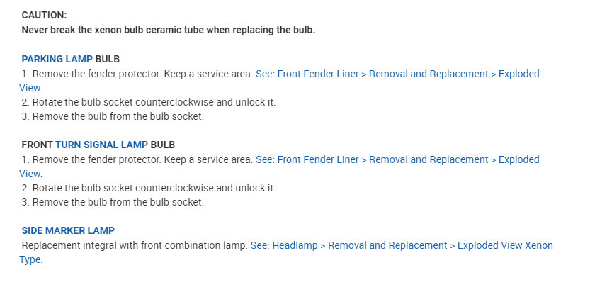

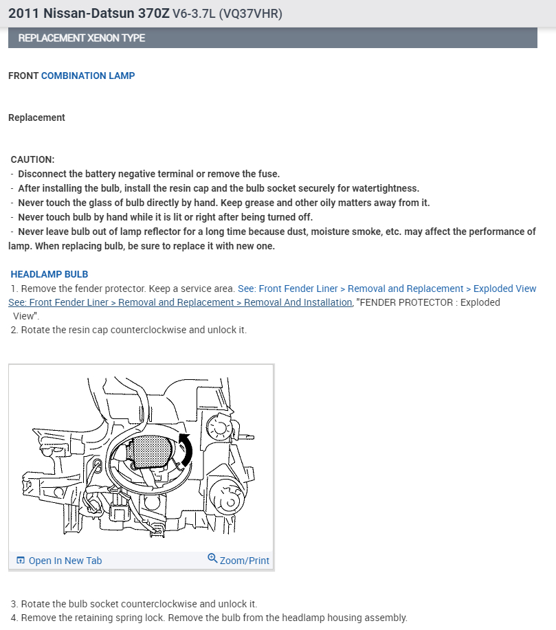

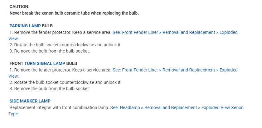

Hi, guys can I get a diagram or some sort of description on how to replace the headlight bulb in this particular year? I appreciate it.
Oct 24, 2021 at 9:48 AM
SQM
  • 6,383 POSTS
In order to replace the headlight bulb, you will have to access it thru the wheel well.
First remove the inner fender liner, this will give you access to the back of the headlight.
https://www.2carpros.com/articles/how-to-replace-a-headlight-bulb
