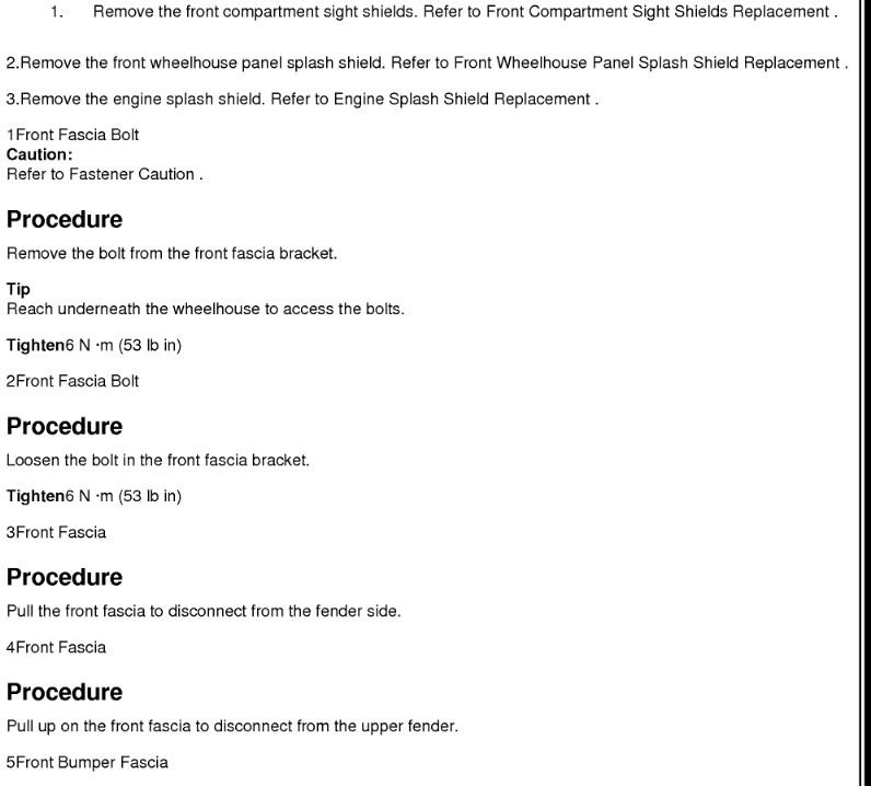

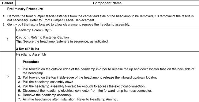

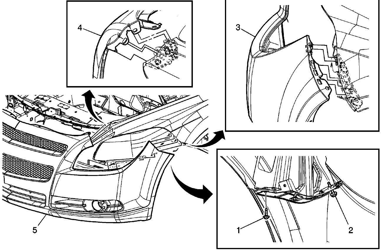

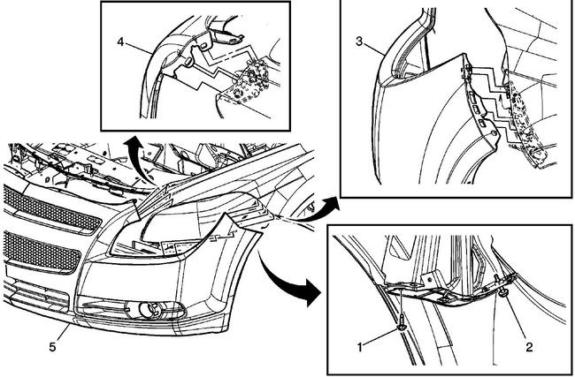

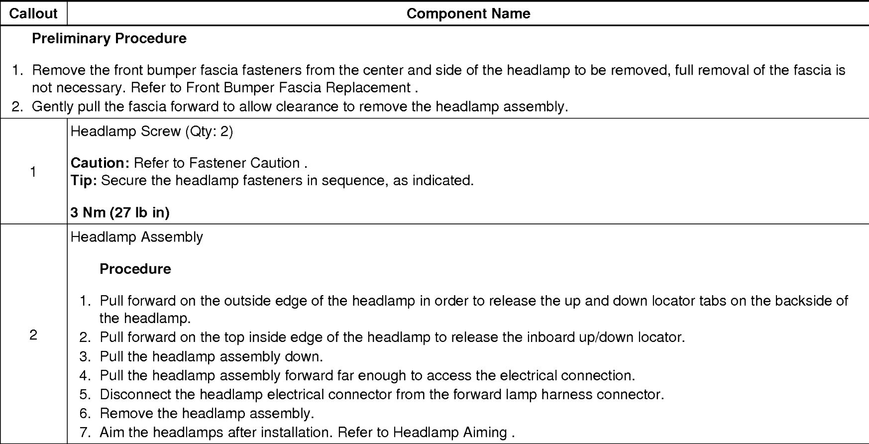

How do you replace the headlight bulb on the car listed above?
Mar 7, 2020 at 9:58 AM
STEVE W.
  • 15,200 POSTS
The easiest way is to trade the car in. LOL.
GM didn't do anyone a favor on the Malibu. You need to remove the front bumper cover assembly to get to the headlight mounting bolts so you can remove the housings to change the bulbs. You can do one side or make life easier and remove both sides and replace all of the headlight bulbs at once. That way if the new bulb is brighter or a different color output like bright white or one of the high performance types both sides match.

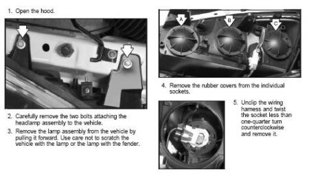

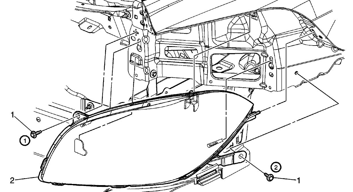

JDL
  • 16,098 POSTS
https://images.2carpros.com/forum/automotive_pictures/170934_headlamp_2.jpg
https://images.2carpros.com/forum/automotive_pictures/170934_headlamp_11_1.jpg
Hello, I found the above info in an owners manual.
Jan 11, 2021 at 11:16 AM (Merged)

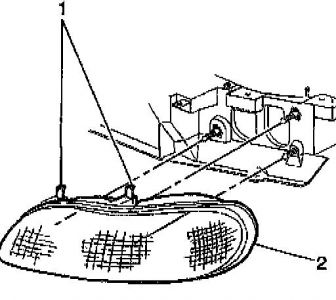

MTRDUDE
  • 51 POSTS
I own this vehicle (VIN #1G1ND52J816199867) and can't figure out how to replace the drivers/left side low beam headlamp bulb. I removed the battery to try to gain access to the bulb from the back side but there is sheet metal in the way. I don't see any screws or other fasteners that hold the bezel assembly in place.
MASTERTECHTIM
  • 4,750 POSTS
pull up pins #1 and head light assembly will slide out forward, then replace bulkb and reinstall
https://images.2carpros.com/forum/automotive_pictures/139033_gov_9.jpg
