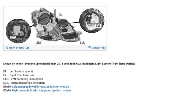

How to replace both headlight bulbs on this car? Low beams, and they are HID.
Feb 6, 2020 at 6:44 AM
JOETECHPRO
Experienced Mechanic
705 POSTS
Hey NASER NASER,

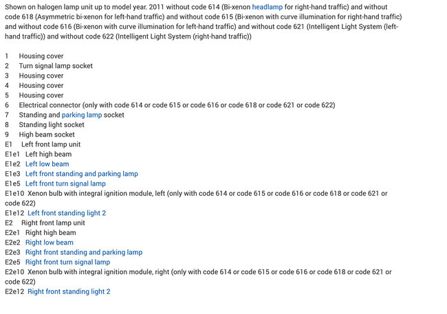

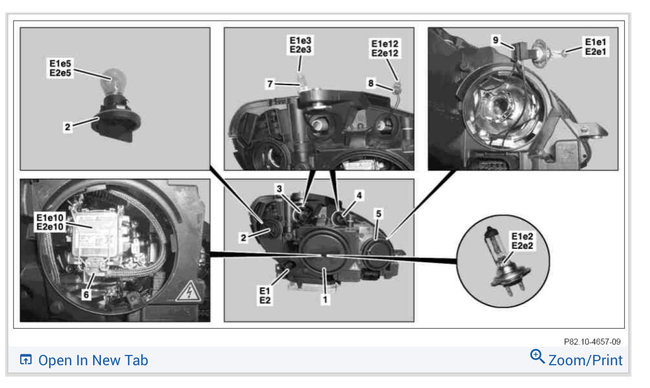

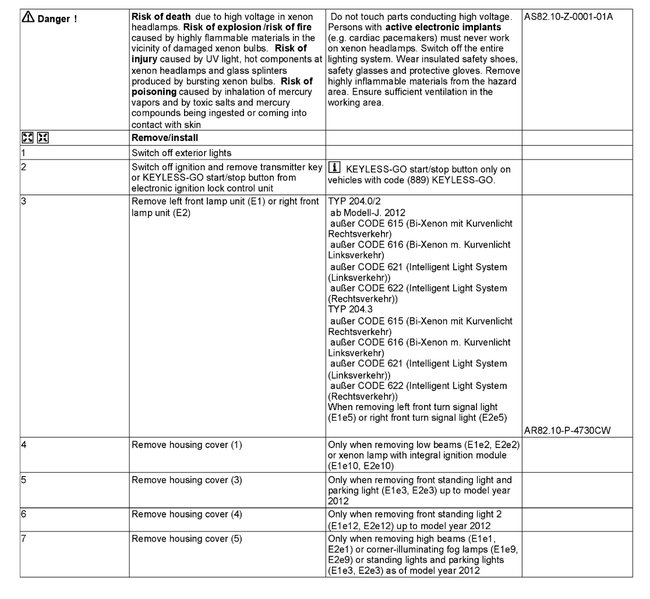

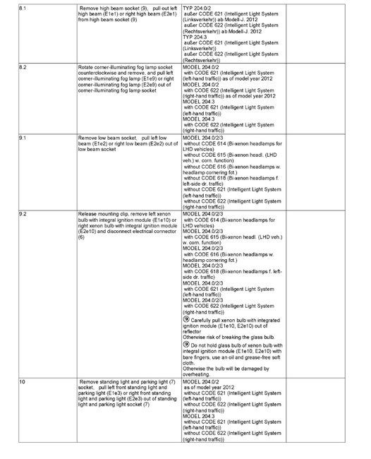

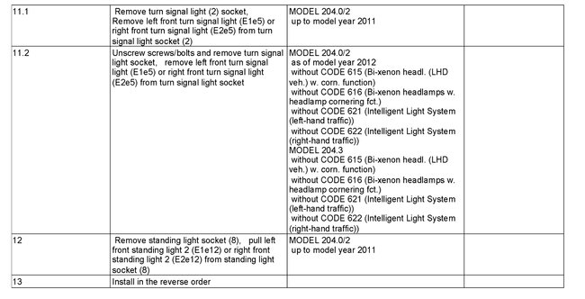

I have attached the instructions for how to replace the Xenon low beam bulbs in the front of your vehicle.
Hope that helps, any further questions please don't hesitate to ask.
Regards, Joe
