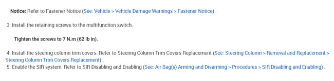

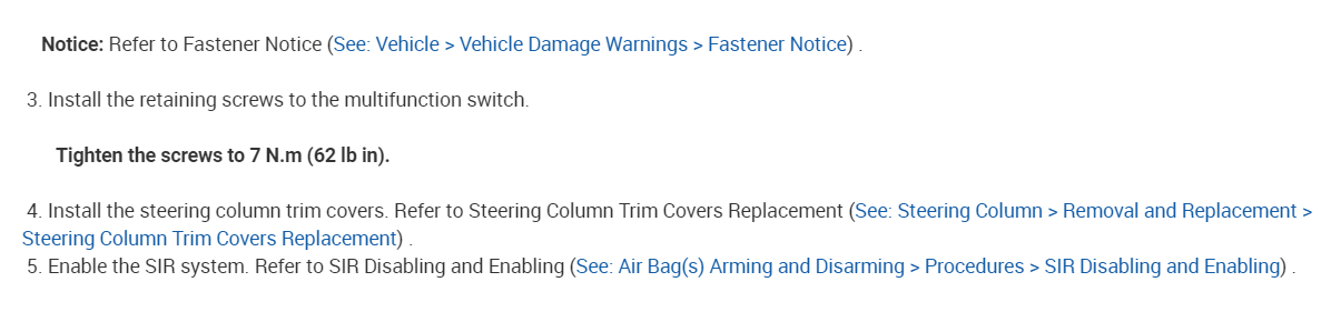

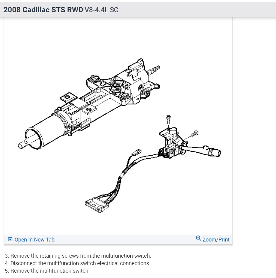

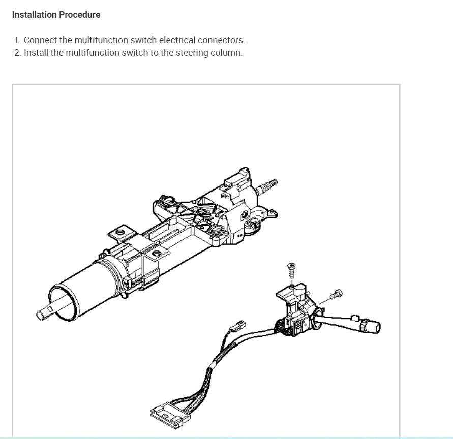

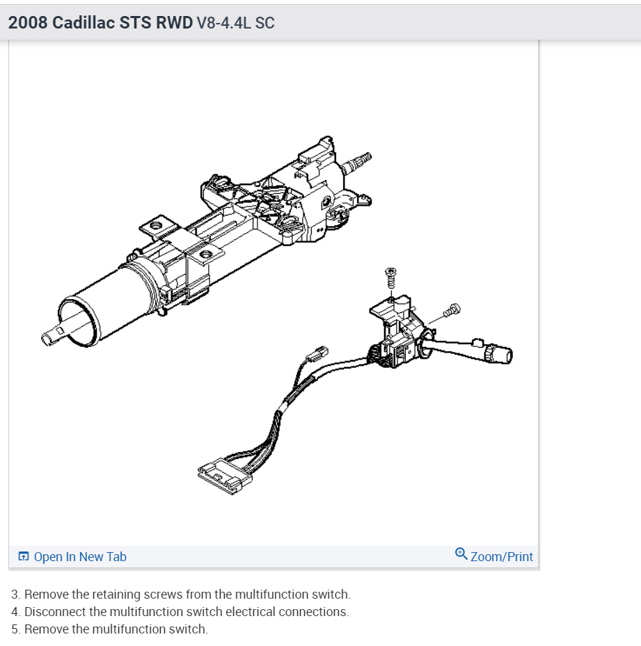

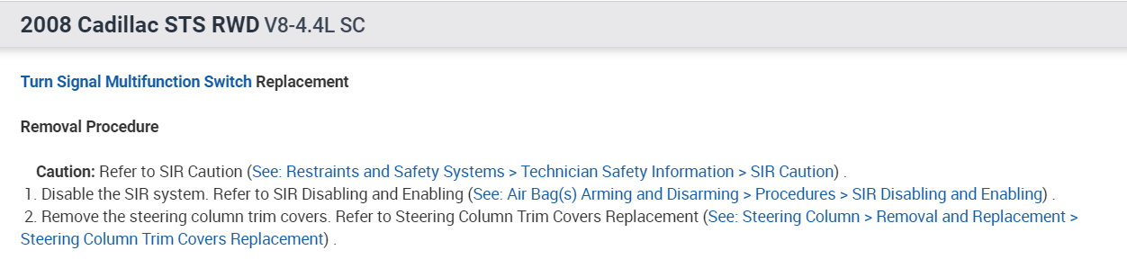

You could have a bad switch or the wrong switch, here is the correct part number for the switch and instructions on how to change it correctly.
Turn Signal Switch : 20808029 $107.04
Can I ask if the switch is aftermarket? Check out the images (below). Please let us know what happens.
