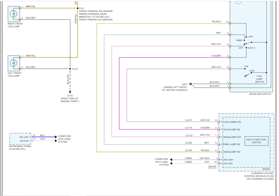

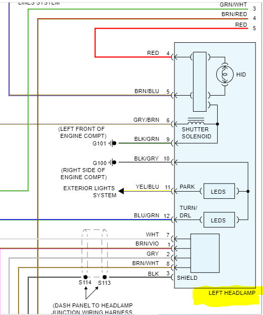

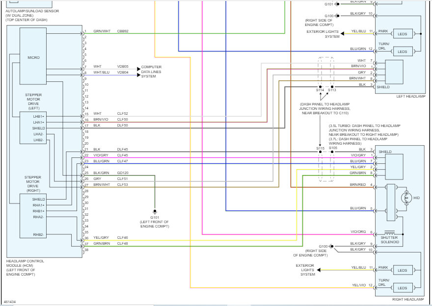

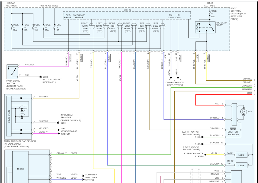

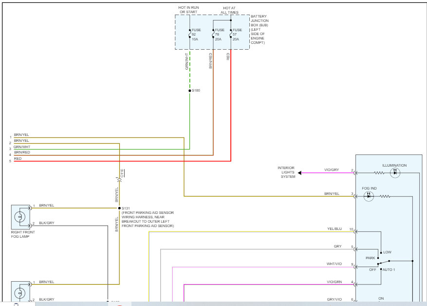

Issues with HID headlight driver's side. Replaced bulb and ballast. Fuse not blown; grounds appear to be good. Does anyone have a wiring diagram for the headlight assembly for the car listed above? Hard to find info on MKS.

Have you checked for power to the light assembly? Do other functions on the left front work?
As far as the wiring schematic, it is two pages long. To make it readable for you, I had to cut each page in half. So, the first two pics below are from page 1 and pics 3 and 4 below are from pic 2. Additionally, I enlarged the left headlamp assembly only in pic 5 below.
Let me know if this helps.
