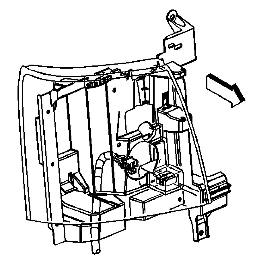

I can't get the outboard headlight assembly pin on each headlight to set properly in the lower pin opening.

Something must not be aligned. Do me a favor. Here are the directions for removal and replacement. Take a look through them to see if there is something you missed. The attached pictures correlate with the directions.

1. Remove the front grille.
pic `1

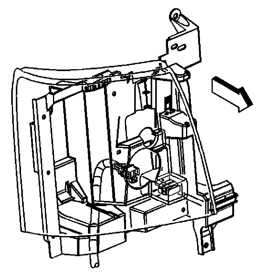

2. Remove the headlamp retainer pins.
3. Pull out the headlamp assembly in order to access the electrical connector.
pic 2
4. Disconnect the electrical connector.

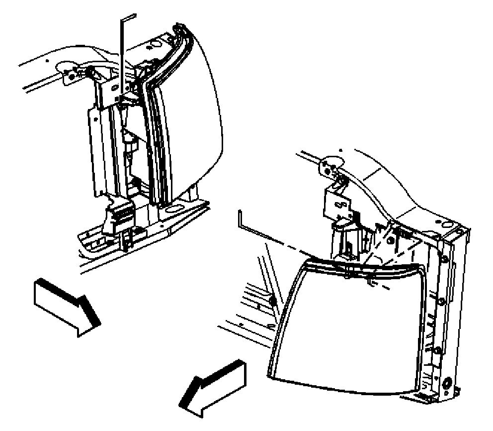

1. Install the rubber cup.
pic 3

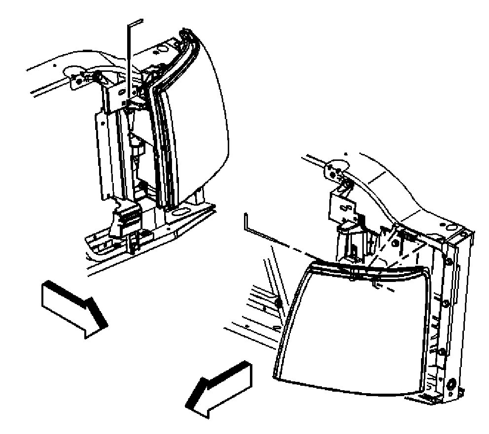

2. Connect the electrical connector to the lamp assembly.
pic 4
3. Install the lamp assembly to the vehicle.
4. Install the headlamp assembly retainer pins.
