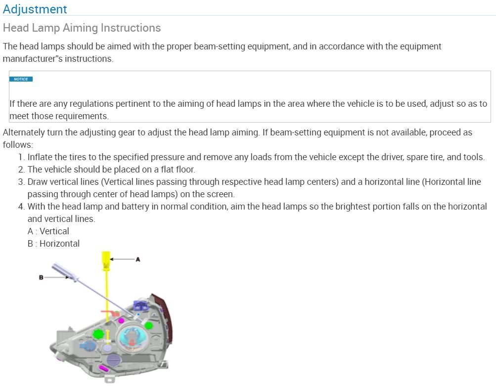

Hi, i would like to know which screw is located to make an adjustment?

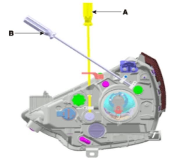

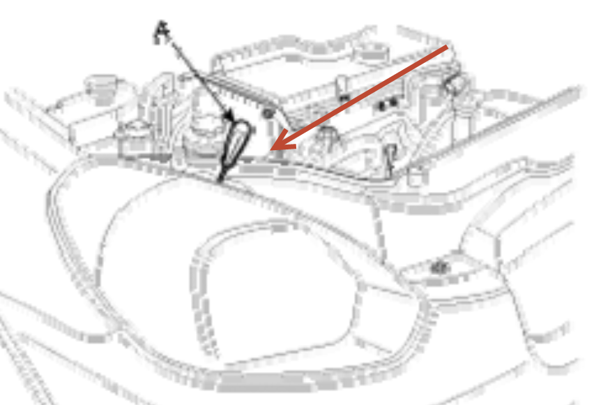

Good morning.
Attached below is the headlamp aiming procedure. The second attachment is a zoomed in few of the adjustment screw locations. Check out the diagrams (Below). Please let us know if you need anything else to get the problem fixed.

I have recently installed 6000k HID bulbs in my 2012 Hyundai Accent Active (Base Model) And after installing them I went for a drive and saw that they were point down at the road more then directly infront of me. I have been looking for a couple of hours and I cant see how I adjust the bulbs to go up a little bit.

Head Lamp Aiming Instructions
The head lamps should be aimed with the proper bea setting equipment, and in accordance with the equipment manufacturer's i
NOTE: If there are any regulations pertinent to the aiming of head lamps in the area where the vehicl
so as to meet those requirements.
Alternately turn the adjusting gear to adjust the head lamp aiming. If bea setting equipment is not available, proceed as follows
1. Inflate the tires to the specified pressure and remove any loads from the vehicle except the driver, spare tire, and tools.
2. The vehicle should be placed on a flat floor.
3. Draw vertical lines (Vertical lines passing through respective head lamp centers) on the screen.
4. With the head lamp and battery in normal condition, aim the head lamps so the brightest portion falls on the vertical lines
