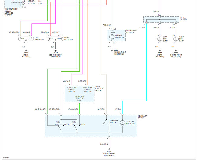

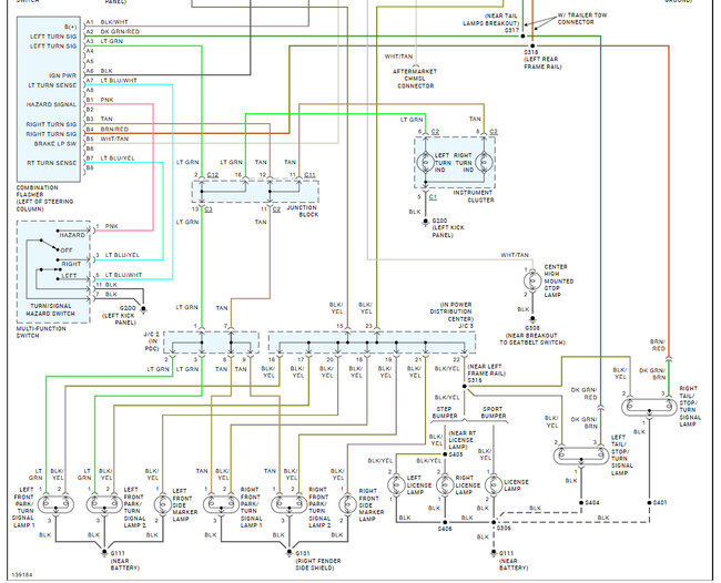

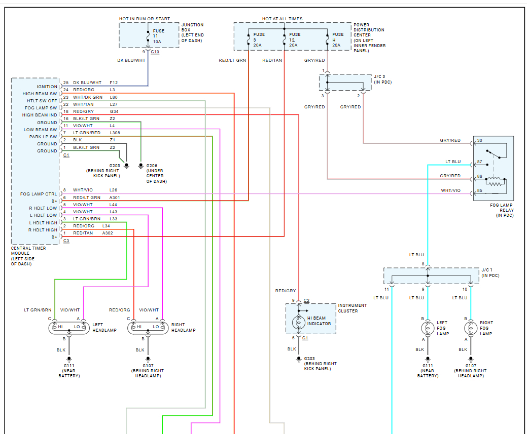

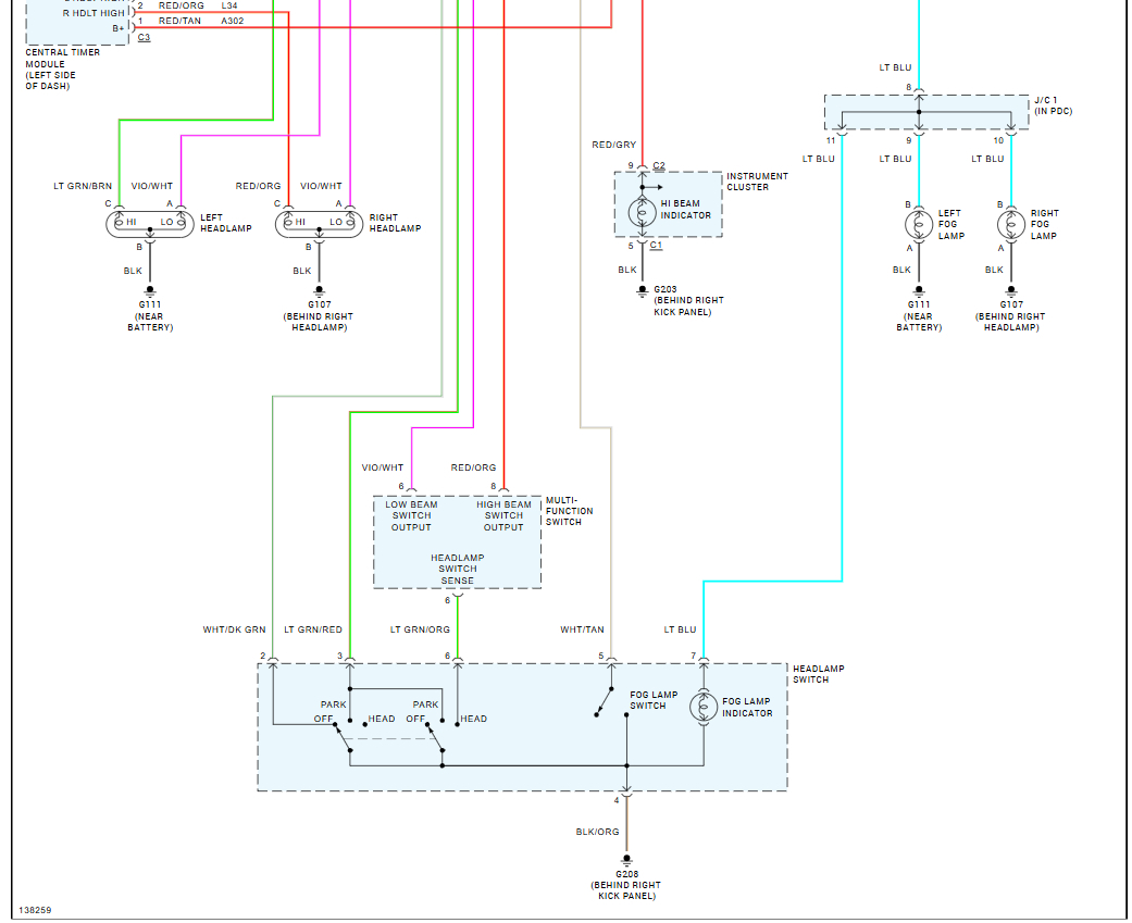

Driver side headlight wire colors from switch are 3 solid green one green with blk stripe and one violet with white stripe. I don't know which color goes where. There is no harness I'm hooking them direct. My outside marker driver side has 2 wires blk and a blk with yellow stripe. Middle marker 3 wires.
1 green
1 blk/yellow stripe
1 blk
Inside marker 2 wires
1 blk
1 blk yellow stripe
Head light
1 blk
1 blk yellow stripe
1 green

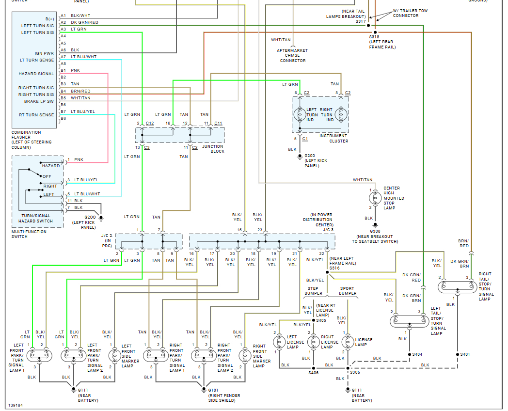

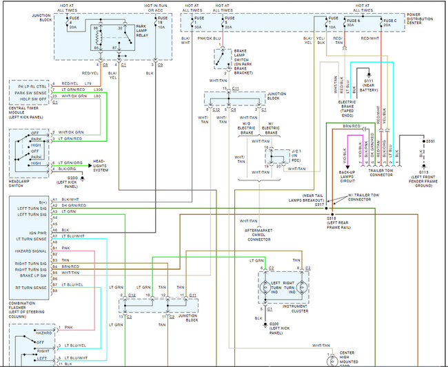

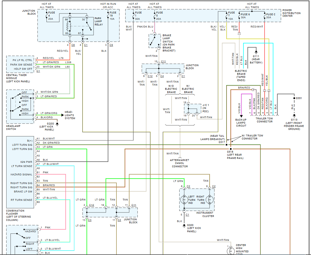

I see the side marker lighting wiring colors which seem to be correct, but I don't see the headlamp color as you have described. here are the wiring diagrams for both the headlights and running lights, (side markers).
This guide will help with the connection testing in case you need it:
Check out the images (below).
