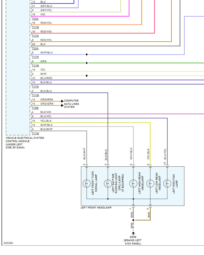

Just replaced the driver side headlight assembly for the vehicle listed above 2T 4 door. Also replaced the bulb. Everything works except for the headlight beam. Tried a second new bulb. Nothing. Fuses appear to be good. What do you suggest?

Does this car have the HID's? If not, I would test the yel/blk wire for power with the headlights on. This guide can help you:
If you don't have power, then you have a bad vehicle electrical system control module. Here are the wiring diagrams so you can see how the system works. Check out the images (below). Please let us know what happens.
