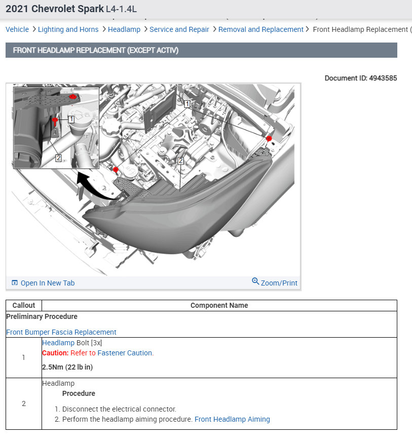

I need a headlight assembly for my car listed above. Ordered the part three times and have gotten the wrong part each time. Are there two different headlight assemblies for this car? Maybe the LED is different from the Halogen? My car has one pig tail and the ones they send have two pigtails and different lights.
Dec 4, 2021 at 9:43 PM
SQM
  • 6,383 POSTS

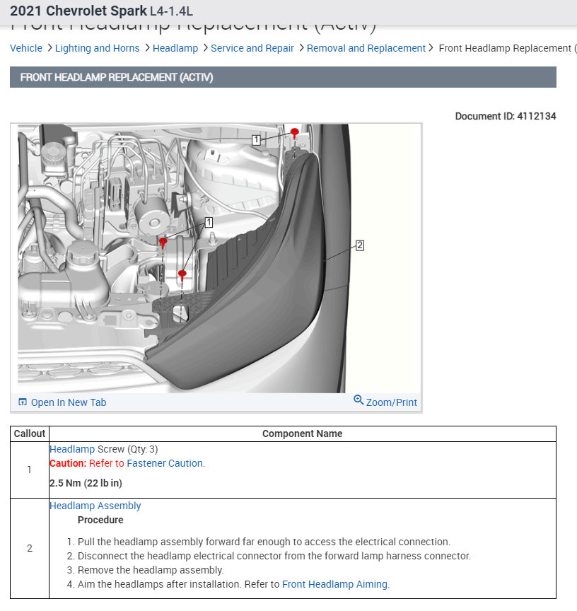

As these vehicles can come up loaded with different version headlights or any other equipment from the factory, the best option would be to call your local dealer and provide them with the VIN. They will be able to look up the exact headlight that was equipped from the factory.
This vehicle has couple of different headlights one for active headlight another standard headlight.
If you provide the VIN, the dealer should be able to tell you which version is in your vehicle.
Let me know if you have any questions.
