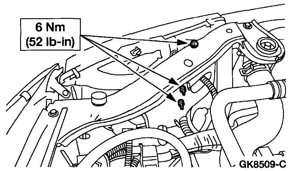

Hello, could you tell me step by step how to remove and replace a headlight assembly on the van listed above? Thank you.

Here are the directions. The attached pictures correlate with the directions.
HEADLAMP ASSEMBLY
REMOVAL
picture 1

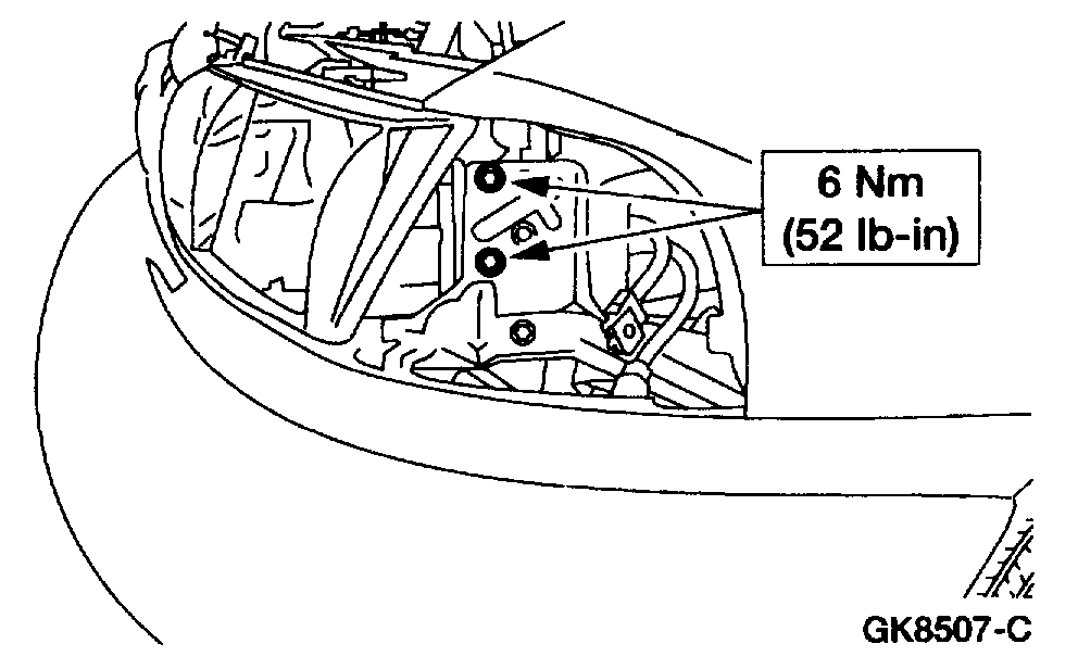

1. Position the parking lamp assembly aside.
1 Remove the screw.
2 Position the parking lamp assembly aside.
picture 2

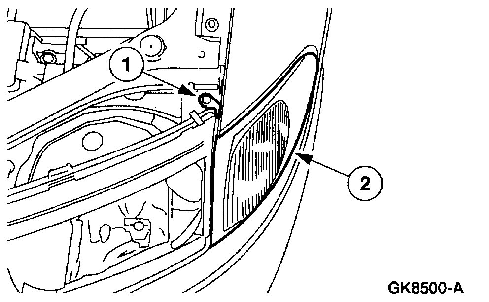

2. Remove the parking lamp assembly.
1 Disconnect the connectors.
2 Remove the parking lamp assembly.

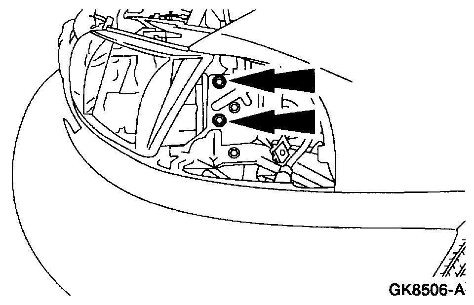

3. Remove the screws.
NOTE: For the RH headlamp, position the relay box out of the way.

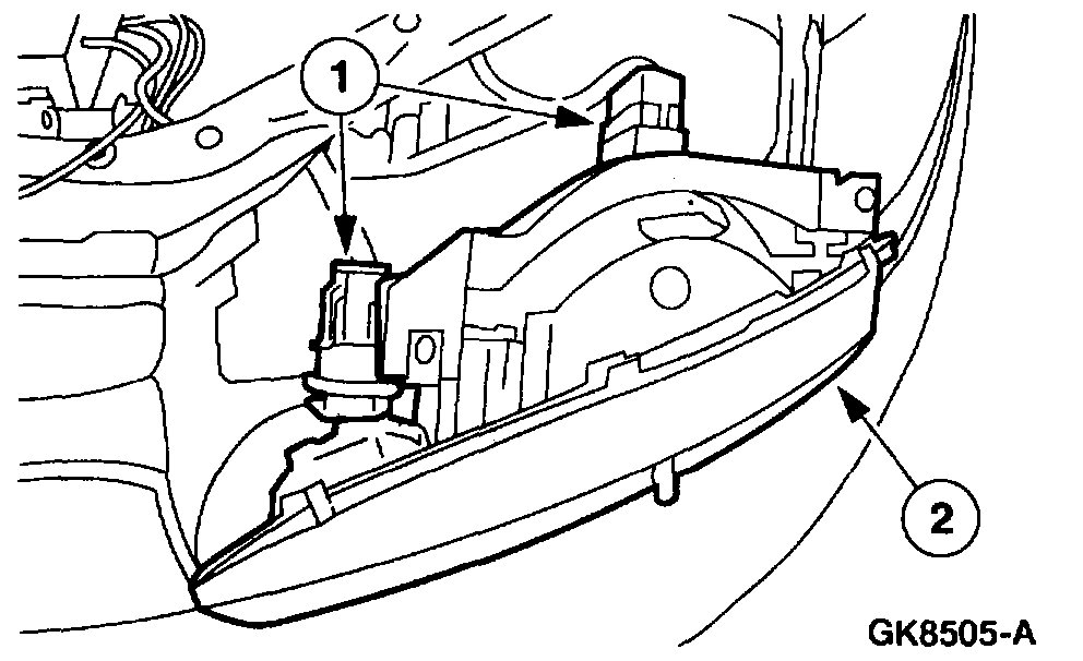

4. Position the headlamp assembly aside.
1 Remove the bolt.
2 Remove the nuts.
3 Position the headlamp assembly aside.

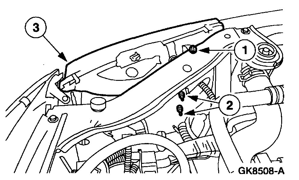

5. Remove the headlamp assembly.
2 Remove the headlamp assembly.

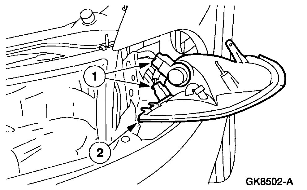

INSTALLATION
picture 6
picture 7
1. To install, reverse the removal procedure.
