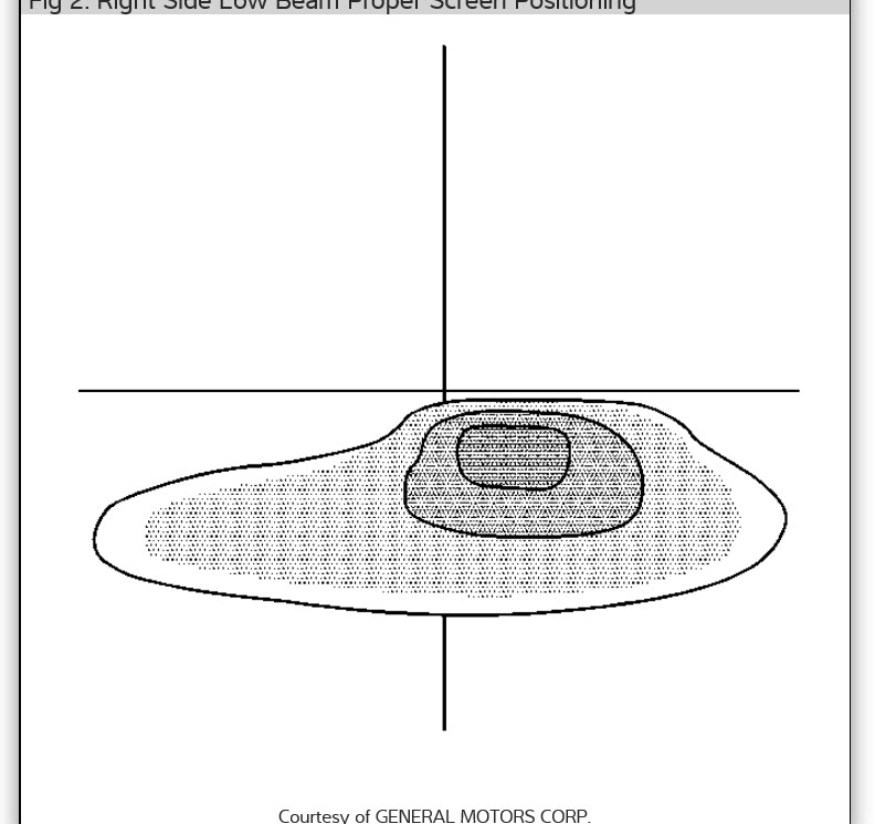

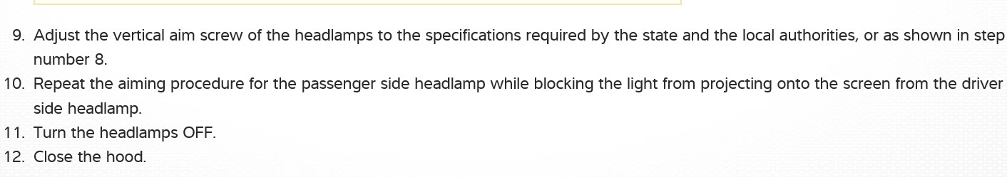

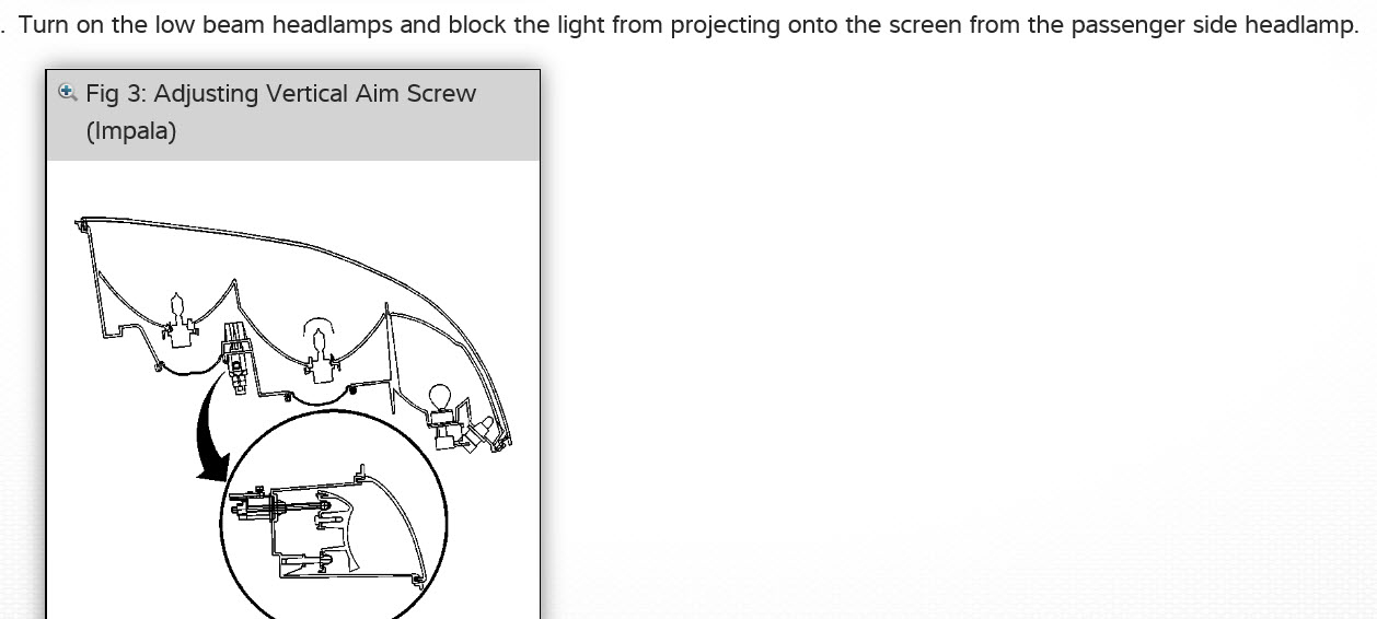

I need to set the proper aim on them, but cannot find any help. Can you help?
Jun 3, 2016 at 3:13 AM
HMAC300
  • 48,601 POSTS
see pictures this should be done from approximately 25 ft away and horizontal centerline should be no higher than 3 ft. make sure it has a full tank of gas and a person 160 lbs in front seat.
