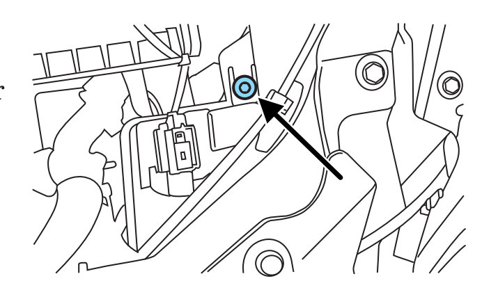

Headlight adjustment, where is the horizontal adjustment screw located?
2013 FORD EDGE
151,000 MILES • 3.7L • 6 CYL • 2WD • AUTOMATIC
DPRYOR0710
Both of my headlights shine off of the road on the passenger side making driving at night difficult. I've found the vertical adjustment screw but am unable to find a horizontal adjustment screw. Can you please advise?
Aug 3, 2022 at 12:29 PM
SQM
  • 6,383 POSTS
Have the headlights been replaced on this vehicle?
Because on this vehicle there is no horizontal adjustment for the headlights, only the vertical one that you have already found.
If the headlight bulb is not seated properly on the housing it can throw off the air of the light.
So might want to check that first.
Also, if the vehicle was in a collision and did not get fixed properly it can have this issue as well.
Let me know of any questions.
