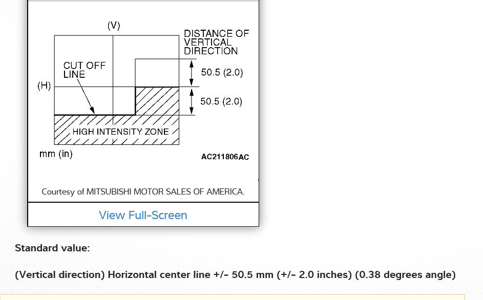

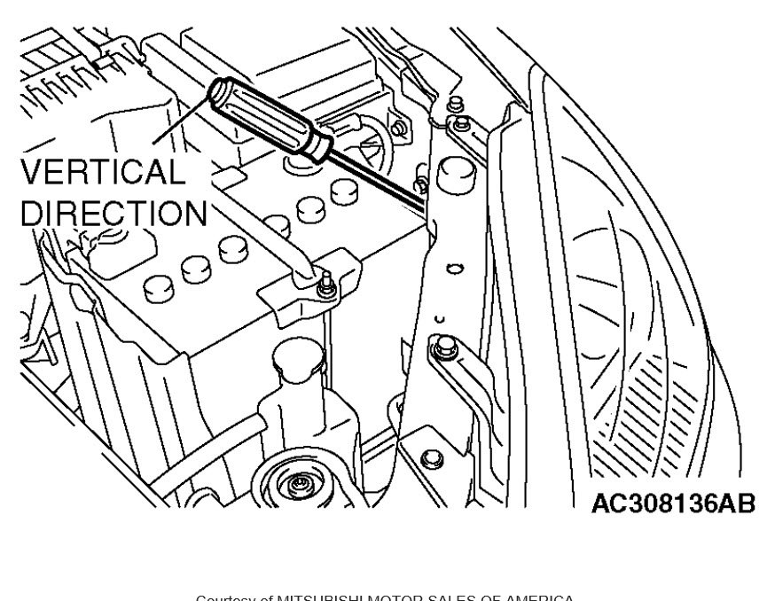

Which screw i have to adjust the left headlight to lower it?

There is no horizontal adjustment. Check out the diagrams (Below). Please let us know if you need anything else to get the problem fixed.

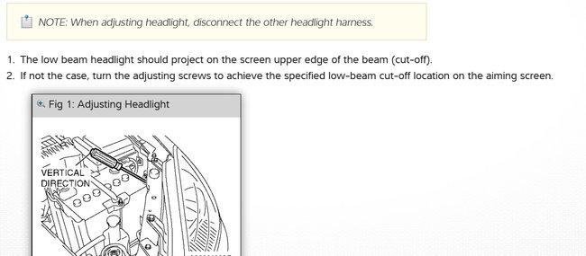

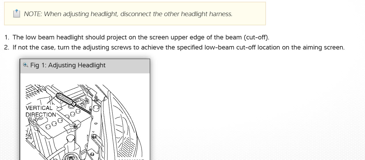

I World lié to know which screw have to adjust the headlight to get a little higher

there is no horizontal adjustment just vertical see pics will be in two separate emails
Apr 11, 2019 at 12:09 PM (Merged)
HMAC300
  • 48,601 POSTS
see pic
