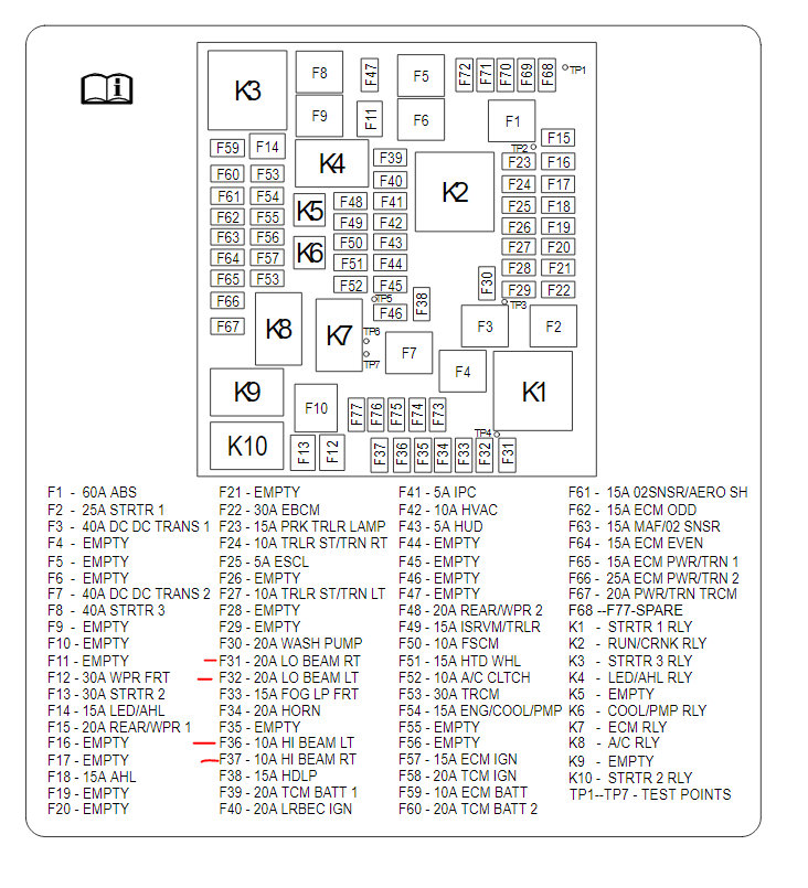

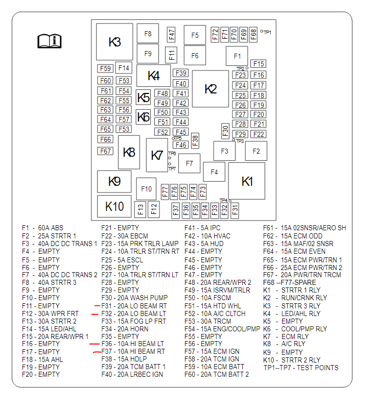

Where is the fuse for the headlights located?
2017 GMC ACADIA
50,000 MILES • 6 CYL • 4WD • AUTOMATIC
CALVIN286
I've looked at all 3 fuse panels and cannot find it. Pulled every fuse in the panel under the hood and the good headlight never went out.
Sep 25, 2021 at 3:04 PM
SQM
  • 6,383 POSTS
The head light fuse should be on the fuse panel under the hood. See diagram below. There are 4 fuses, 2 for low beams and 2 for high beams. Fuse number F31,F32, F36, F37.
Let me know if you are able to locate them.
