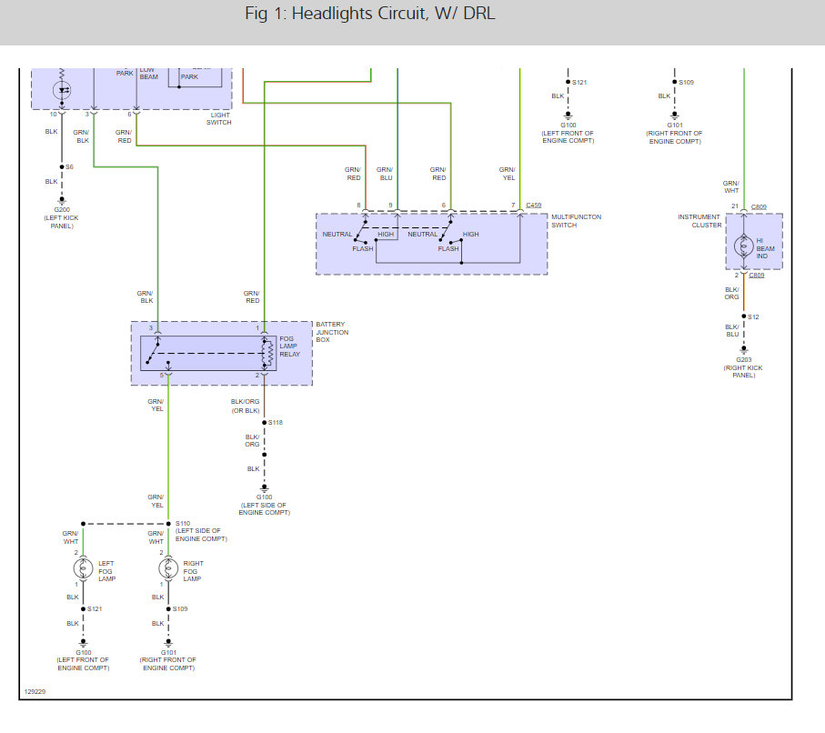

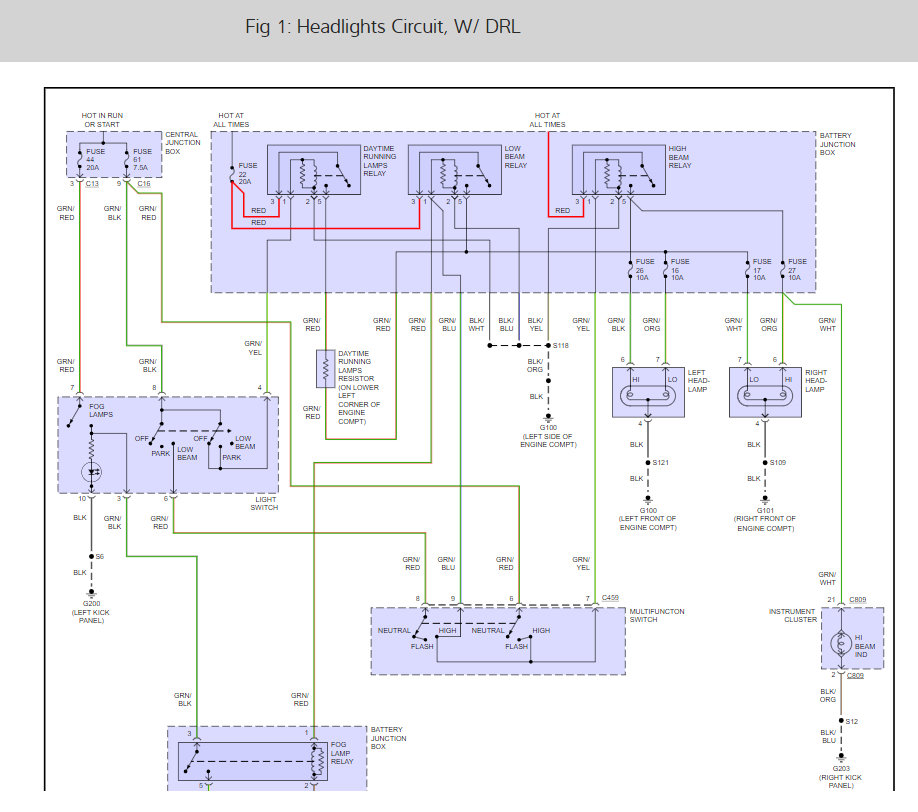

Front Headlight (right side) does not work. Servo-engine for adjusting the beam also.
all fuzes are okay?

Did you replace the bulb? If not here is a guide to help step by step with a diagrams below to show you how on your car also I have included the wiring diagrams so you can see how the system works.
https://youtu.be/LzdJeeeRvvs
If you have replaced the light use this guide to test to see where you lose power. Test for power at Fuse 26 and 16.
