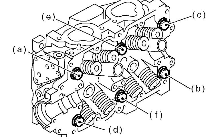

Hello.The head blew on it after it hit a deer and I was wondering if it would be safe to put a 2.2 head on a 2.5? Will it blow a valve or cause any other damage? Or should I stick with the OEM head?? Thank you very much!
Aug 22, 2019 at 6:33 AM
The 2.2 head mixed with the 2.5 head will cause the engine to run rough.
https://www.2carpros.com/articles/how-a-cylinder-head-works
You must use the correct head.

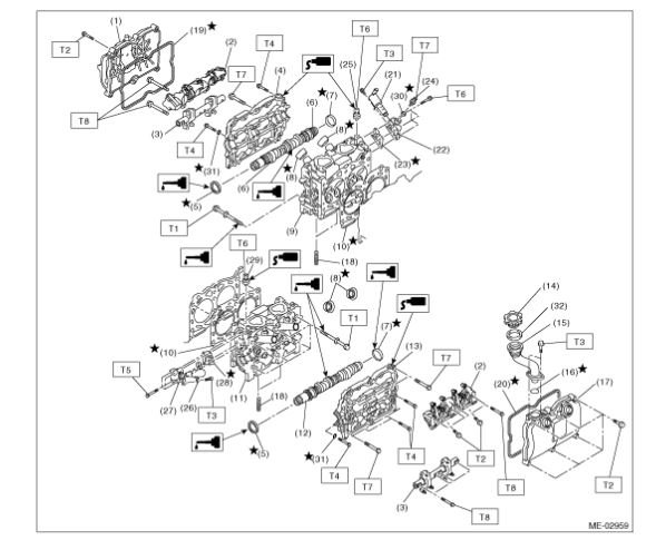

Cylinder Head
CYLINDER HEAD AND CAMSHAFT
CYLINDER HEAD AND VALVE ASSEMBLY

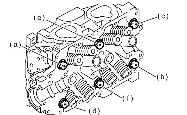

10. Remove the cylinder head bolts in alphabetical sequence as shown in the figure.
NOTE: Leave bolts (a) and (c) engaged by three or four threads to prevent the cylinder head from falling.
11. While tapping the cylinder head with a plastic hammer, separate it from cylinder block.
12. Remove the bolts (a) and (c) to remove the cylinder head.

3. Tighten all bolts to 40 Nm (4.1 kgf-m, 29.5 ft-lb) in alphabetical order.
4. Retighten all bolts to 95 Nm (9.7 kgf-m, 70.1 ft-lb) in alphabetical order.
CAUTION: If the bolt makes stick-slip sound during tightening, repeat the procedure from step (1). In this case, the cylinder head gasket can be reused.
5. Loosen off all bolts by 180° in reverse order of installing, and loosen them further by 180°.
6. Tighten all bolts to 10 Nm (1.0 kgf-m, 7.4 ft-lb) in alphabetical order.
7. Retighten all bolts to 30 Nm (3.1 kgf-m, 22.1 ft-lb) in alphabetical order.
8. Retighten all bolts to 60 Nm (6.1 kgf-m, 44.3 ft-lb) in alphabetical order.
9. Retighten all bolts by 80 - 90° in alphabetical order.
10. Retighten all bolts by 40 - 45° in alphabetical order.
CAUTION: The tightening angle of the bolt should not exceed 45°.
11. Retighten bolts (a) and (b) by 40 - 45°.
