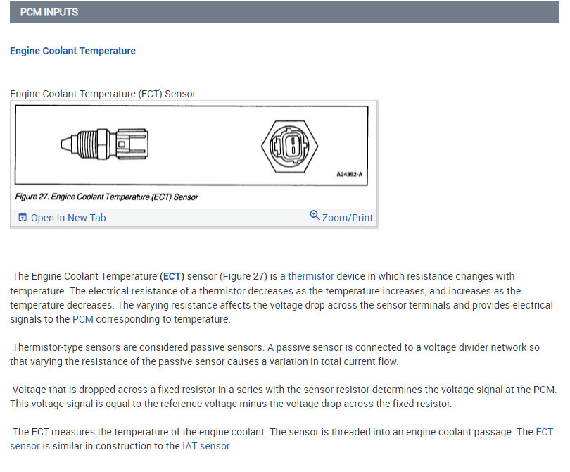

Also if the temperature on the gauge fluctuates so much, it can be due to a faulty temperature sensor. Because regardless of overheating or not it should not fluctuates that rapidly.
https://www.2carpros.com/articles/how-a-coolant-temperature-sensor-works
https://www.2carpros.com/articles/symptoms-of-a-bad-coolant-temperature-sensor
