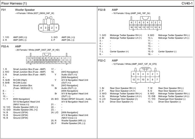

I bought the car, and the radio didn't work because the 15-amp multimedia fuse was pulled to keep it from draining the battery. When I put the fuse back in to diagnose the problem further the screen was stuck on the UVO power on screen and would do nothing, I found through some research that the head unit would need to be replaced, and there is a strong possibility that this is the problem with the voltage drain. Fast forward I replaced the head unit which I got from Crutchfield, along with the *idatalink maestro box and wiring to make everything work without having to tear into the factory harness. The back up camera, steering wheel controls, sub, and the driver side rear door speaker work great. The rest of the speakers don't do anything. I don't know what to do next or where to even start looking for a problem that was most likely already there before the new stereo components.

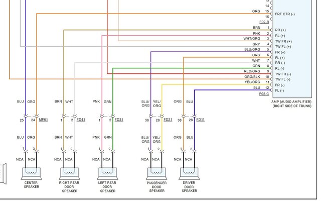

To narrow it down to the amp or something in the interface, the easiest way would be to go to the factory amp and use a speaker to test the outputs directly. I doubt that all the speakers failed, possible but doubtful. So, take the speaker you are going to use and connect it between like pairs. So, to test the right front you would connect to FR+ and FR- for the left rear it would be RL+ and RL- I would look at the back of the connector, you might be able to just slip the wires into the back of it to test. If say you get sound at the amp but not at its installed speaker then you would need to get to that speaker, but I sort of doubt that is the issue. The SPDIF unit doesn't really show how it gets the audio from the head unit, does it plug in to the audio output jacks as individual connections? The install book doesn't show it.

Okay, I'm checking amp now, it runs in with the main maestro box and the vehicle harness and has a separate set of RCA cables as well. So, it connects to the front RCA preout jacks as well as the box that is tied to the main wiring harness.

Okay, it sounds like they are sending the "speaker out" into the converter which turns it into the SPDIF signal to go to the amp. Check the RCA outputs. If those all work, then I suspect that box has an issue. Perhaps run it through the set-up again. The only other option would be to find something with the DPDIF signal and feed that to the amp and see if it works then.
