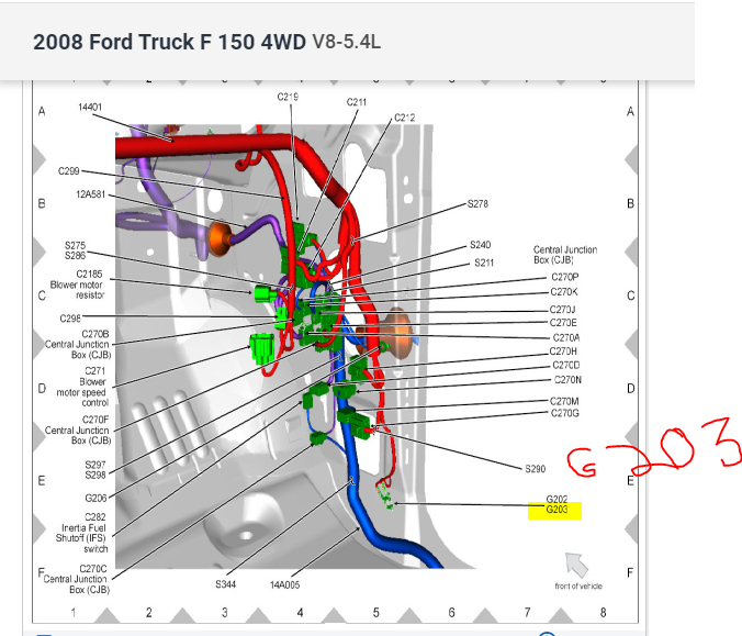

wired all up and my A/C fan won't work, and my light freaks out. has stock sub.

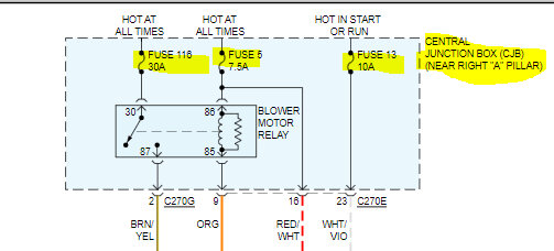

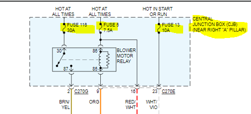

Have you first checked fuses for the blower motor? Also, which lights are acting odd? What are they doing?
First, check the fuses. I attached a pic below identifying three different ones for the blower motor to operate.

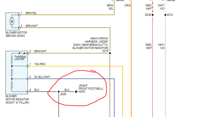

If they are all good and have power, I suspect you damaged a ground wire while working under the dash. If you look at pic 2 below, it shows a ground we need to check. It is G203. See pic for location.
Start with this and let me know what you find.
