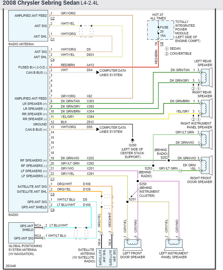

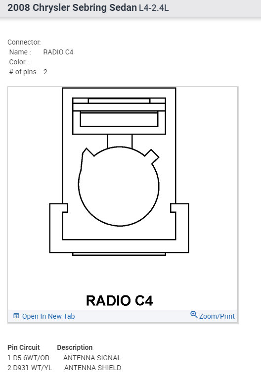

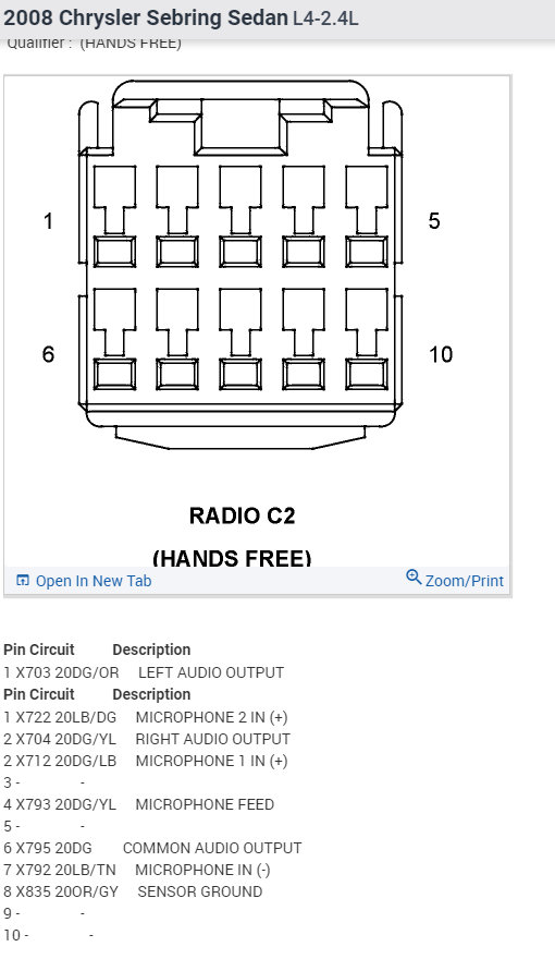

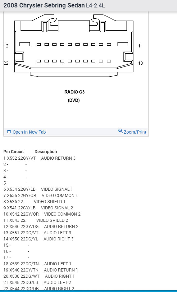

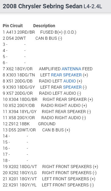

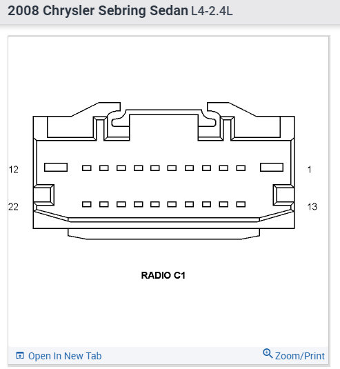

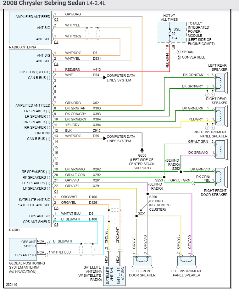

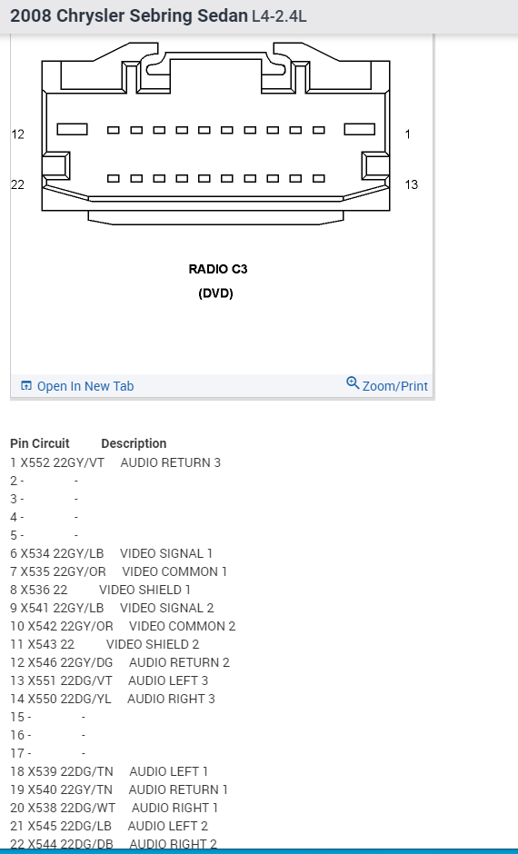

There are a few wires coming from my new head unit wiring harness that I'm not sure where to hook up. An orange wire labeled illumination, a purple wire labeled reverse input, a green wire labeled parking brake.
Dec 12, 2021 at 9:58 PM
SQM
  • 6,383 POSTS
Please note that many times the aftermarket units will have wires that do not apply to your specific vehicle.
Like the reverse camera won't have factory plug in. Unless of course you add a reverse camera then that will be the wire you want to tap into.
I have attached the pinout for the factory harness, it shows what each pin represents.
Take a look at the diagrams and let me know of any questions.

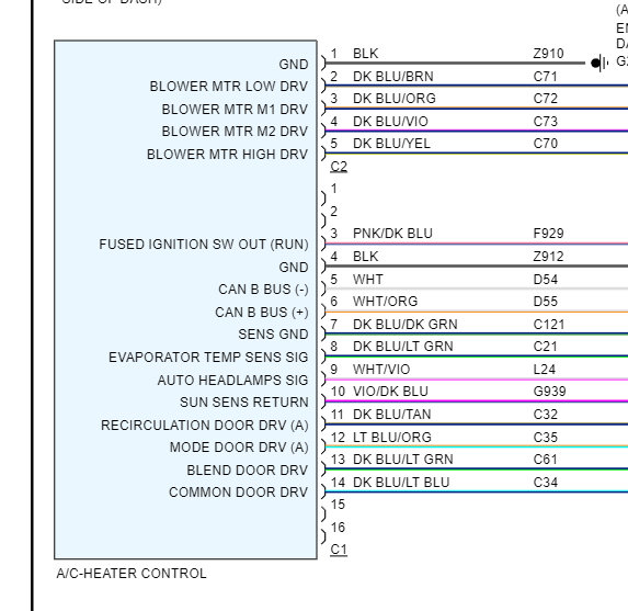

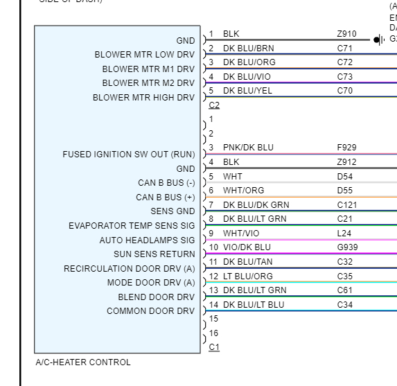

Good morning,
Why did you replace the control head?
Did you use a new OEM unit?
I attached the wiring diagram for you of the control head.
Please review.
Do you have manual or automatic climate control?
