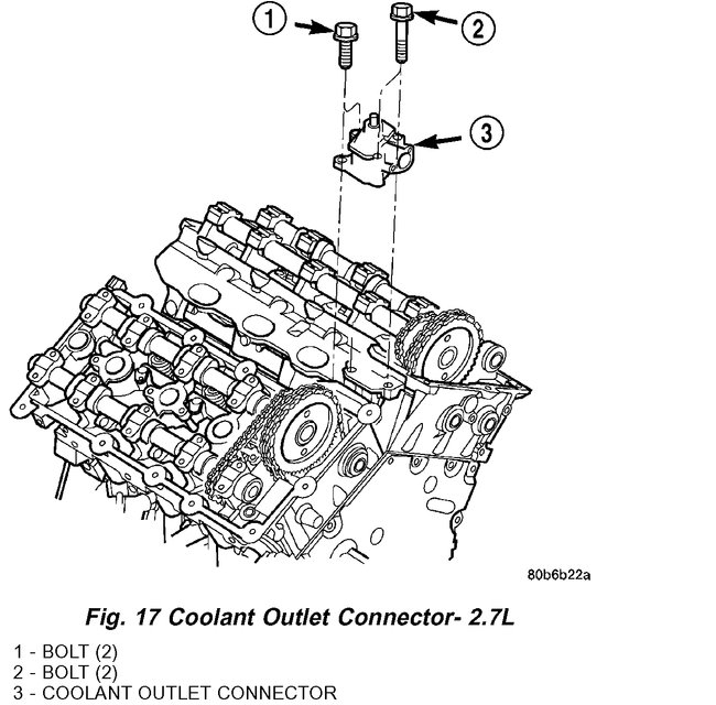

15. Remove coolant outlet connector (Fig. 17).

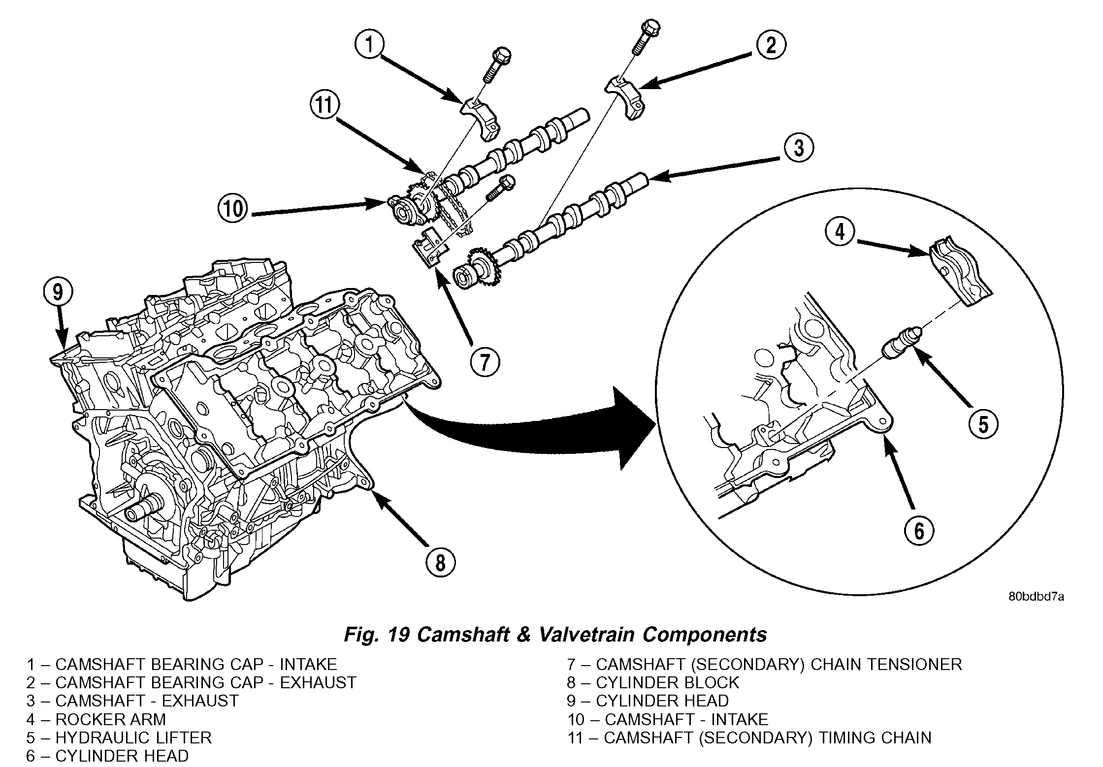

pic 2

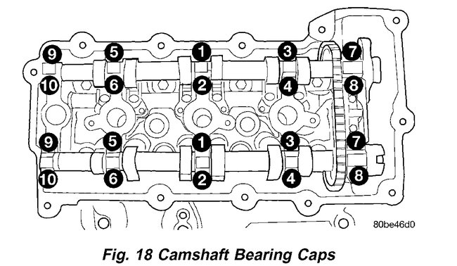

20. Remove camshaft bearing caps gradually in REVERSE sequence of installation (10-1) (Fig. 18).
pic 3
21. Remove camshafts and valvetrain components from cylinder head (Fig. 19). Note component locations for re-installation in original locations.

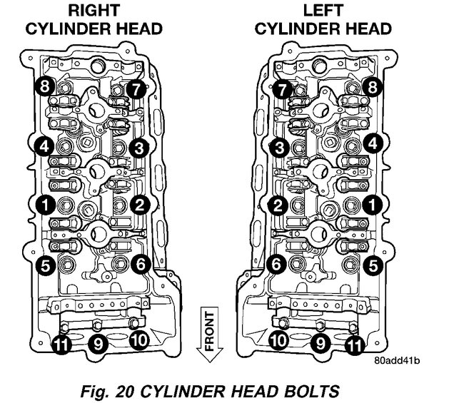

CAUTION: Ensure cylinder head bolts 11-9 (Fig. 20) are removed before attempting the removal of cylinder head, as damage to cylinder head and/or block may occur.
24. Remove cylinder head bolts in reverse sequence of installation (Fig. 20) starting with bolts 11-9, then bolts 8-1.

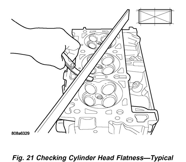

3. Check cylinder head for flatness (Fig. 21).
4. Cylinder head must be flat within:
^ Standard dimension = less than 0.05 mm (0.002 inch)
^ Service Limit = 0.2 mm (0.008 inch)
^ Grinding Limit = Maximum of 0.2 mm (0.008 inch) is permitted.
CAUTION: 0.20 mm (0.008 inch) MAX is a combined total dimension of the stock removal limit from cylinder head and block top surface (Deck) together.

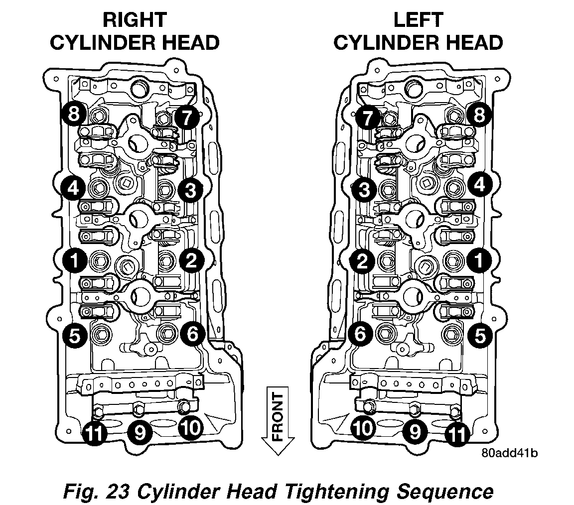

INSTALLATION
pic 6

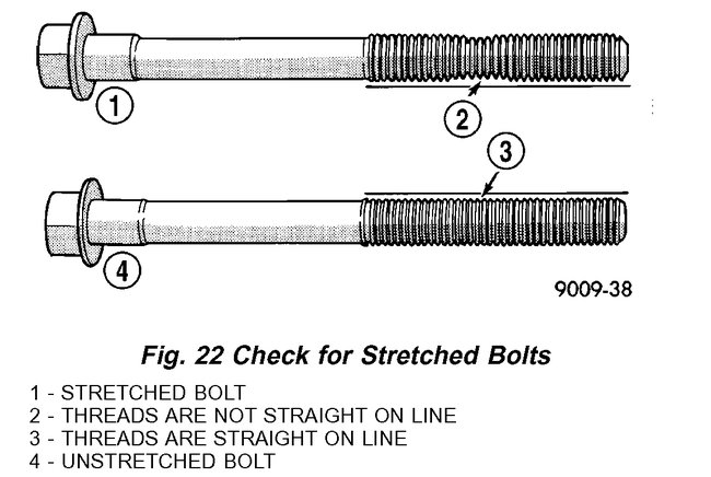

NOTE: The cylinder head bolts are tightened using a torque plus angle procedure. The bolts must be examined BEFORE reuse. If the threads are necked down the bolts must be replaced (Fig. 22)
Necking can be checked by holding a straight edge against the threads. If all the threads do not contact the scale, the bolt must be replaced (Fig. 22)
CAUTION: When cleaning cylinder head and cylinder block surfaces, DO NOT use a metal scraper because the surfaces could be cut or ground. Use ONLY a wooden or plastic scraper.
1. Clean sealing surfaces of cylinder head and block.
2. Install new head gasket over locating dowels.
3. Install cylinder head to block, assuring head is properly positioned over locating dowels.
4. Lubricate bolt threads with clean engine oil and install bolts.
pic 7
5. Tighten bolts in sequence shown in (Fig. 23), using the following steps and torque values:
^ Step 1: Bolts 1-8 to 48 Nm (35 ft. lbs.)
^ Step 2: Bolts 1-8 to 75 Nm (55 ft. lbs.)
^ Step 3: Bolts 1-8 to 75 Nm (55 ft. lbs.)
^ Step 4: Bolts 1-8 to +90° Turn. Do not use a torque wrench for this step.
^ Step 5: Bolts 9-11 to 28 Nm (250 inch lbs.)

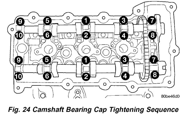

8. Install all valvetrain components and camshafts. Tighten camshaft bearing caps in sequence shown in (Fig. 24) to 12 Nm (105 inch lbs.).
