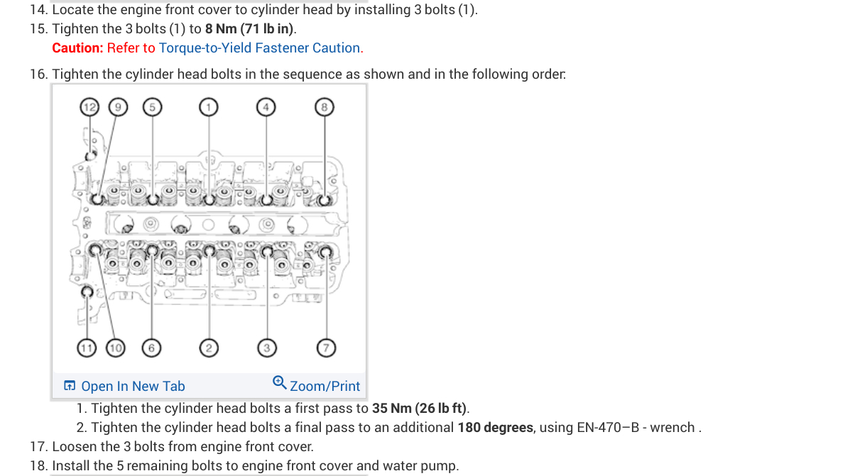

I'm trying to find torque specs for head bolts in foot pounds and the pattern for my car listed above ltz rs.

I have included the information that you requested in the diagrams down below. I hope that this helps.

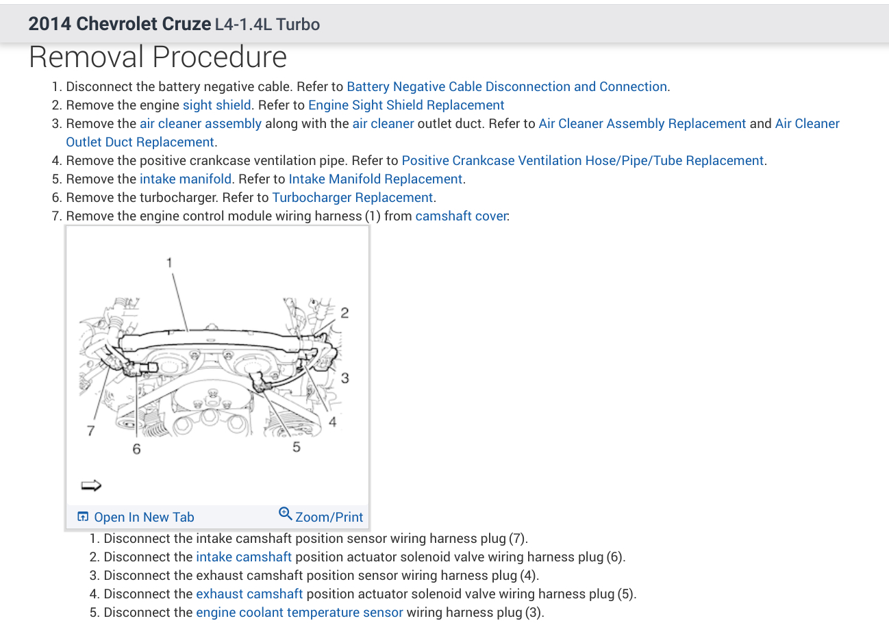

Yes, but can i have the full instructions?

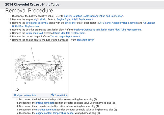

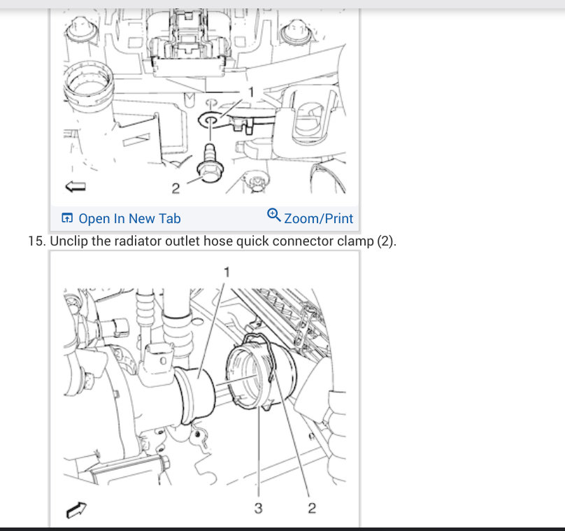

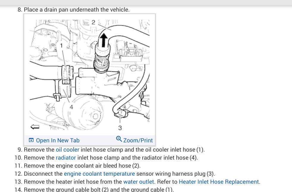

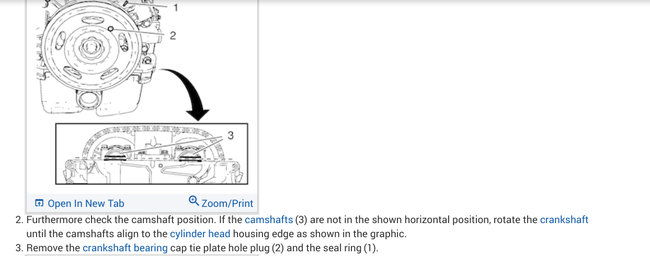

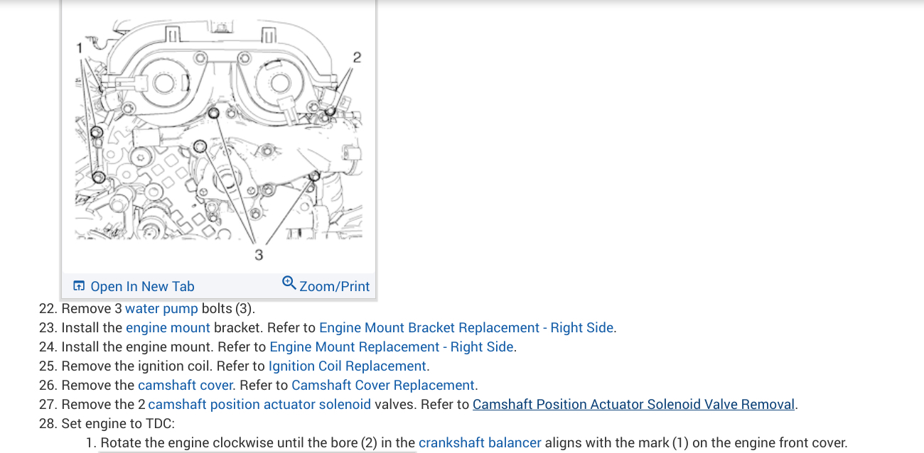

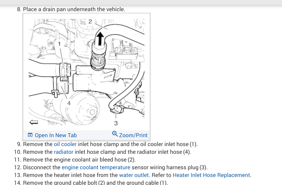

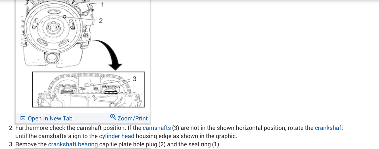

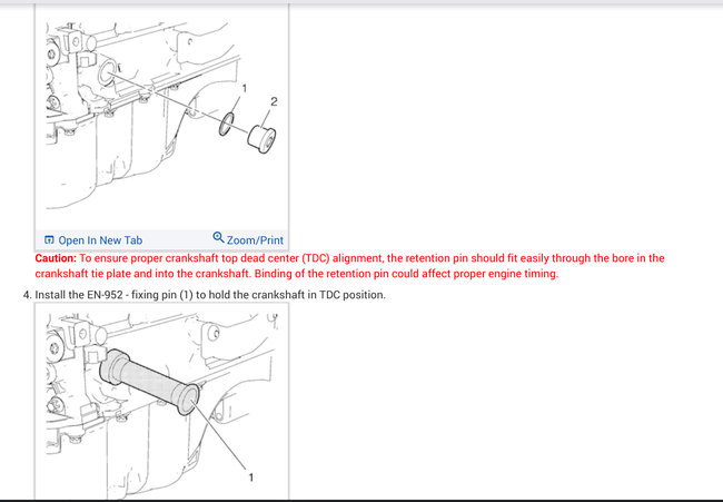

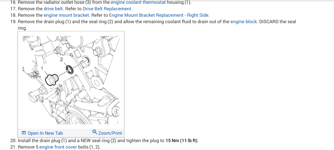

Hello again,
Okay, I have included the instructions for the removal and installation of your vehicle's cylinder head assembly in the diagrams down below. Please go through this guide and get back to us with how everything turns out.

Awesome. thank you so much.
