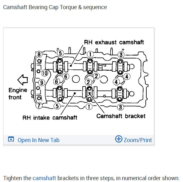

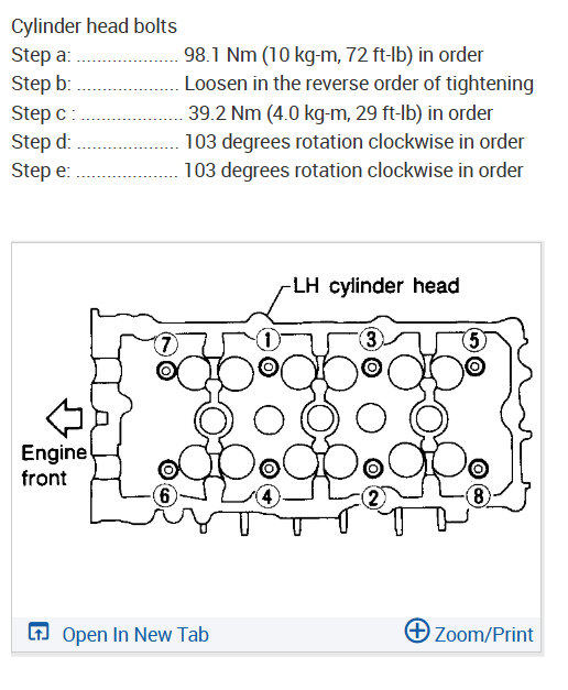

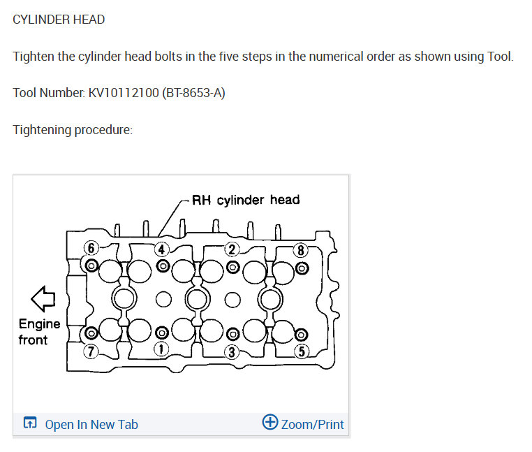

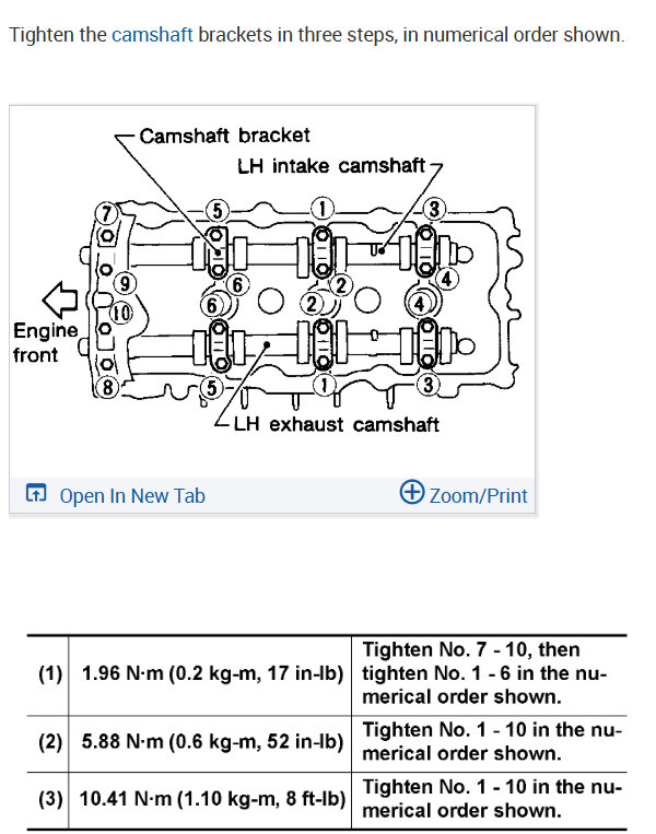

Do you have head bolt and cam torq specs for a 14 pathfinder 3.5l?
Jan 12, 2025 at 11:11 PM
  • 55,415 POSTS
Sure, here are the cylinder head and camshaft bolt tightening torque specs. It says you will need new head bolts because these are torque-to-yield. I have included the sequence as well for both the right and left cylinder heads. Check out the images (below). Let us know if you need anything else.
