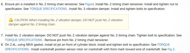

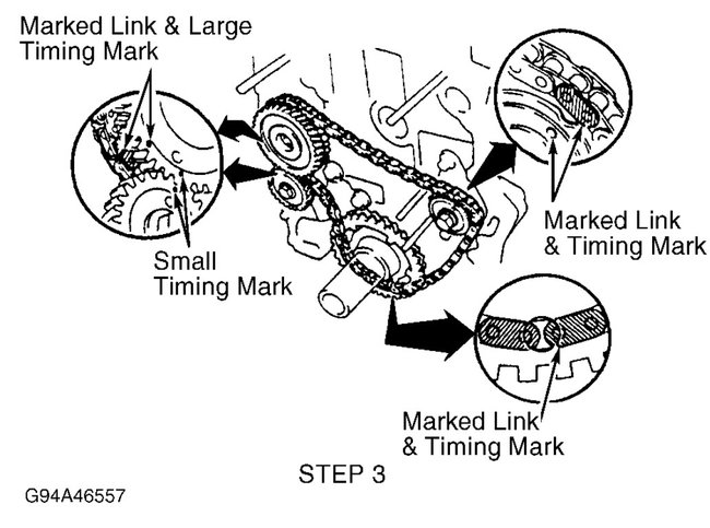

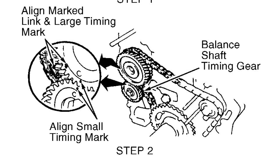

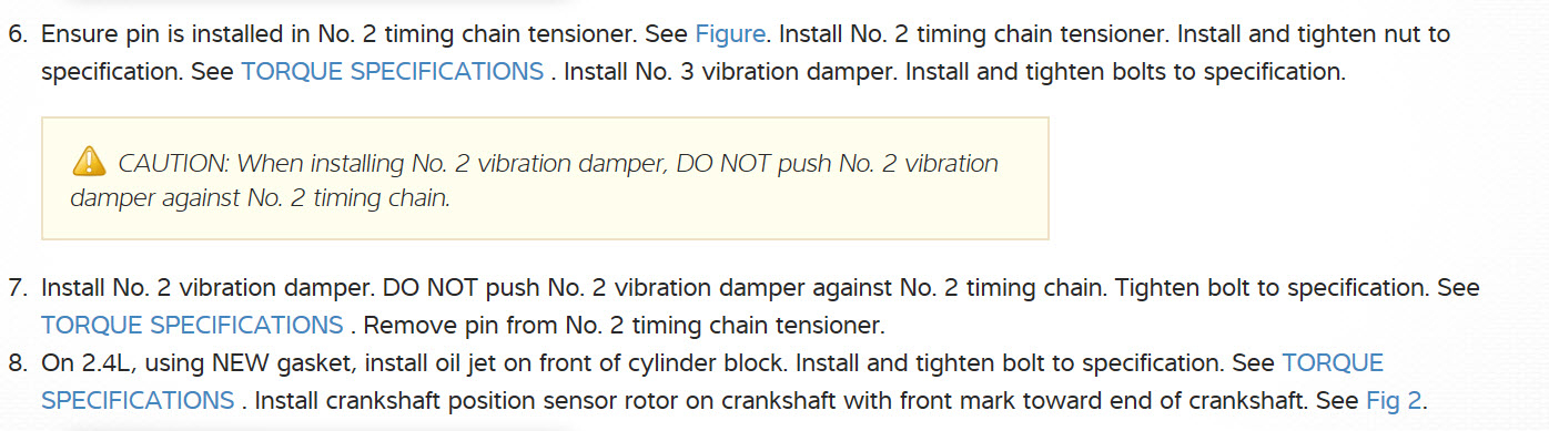

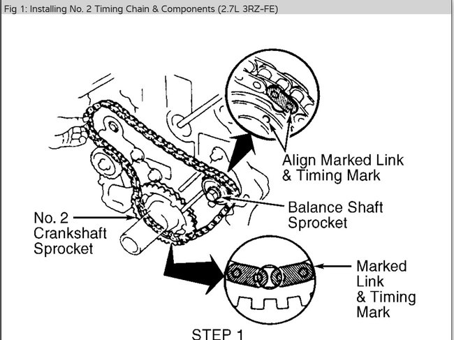

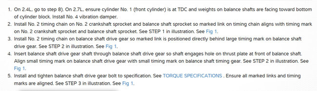

Timing instructions please.
Dec 24, 2016 at 9:51 AM
HMAC300
  • 48,601 POSTS
see pictures for instructions.
Dec 25, 2016 at 11:22 PM
