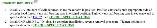

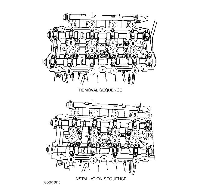

head removed & cams removed for resurfacing
1999 MITSUBISHI ECLIPSE
120,000 MILES • 2.0L • 4 CYL • FWD • AUTOMATIC
GM022552
how to re-install camshafts into head
Jul 8, 2014 at 6:19 AM
HMAC300
  • 48,601 POSTS
torque caps in sequence to 106 inch lbs. see pic for instructions. this is for a non turbo engine
