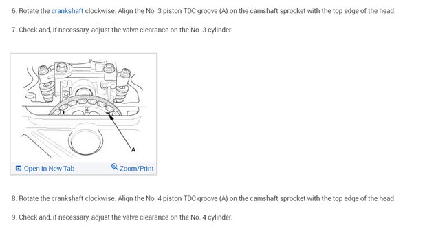

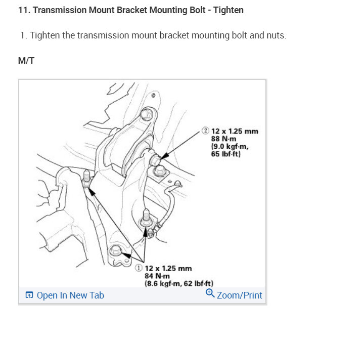

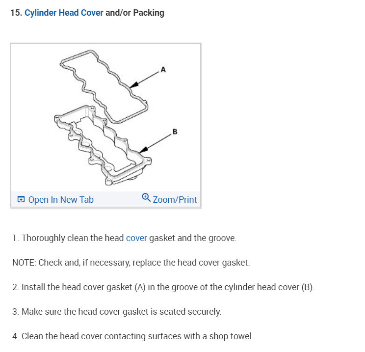

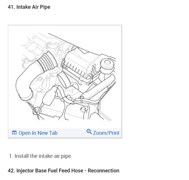

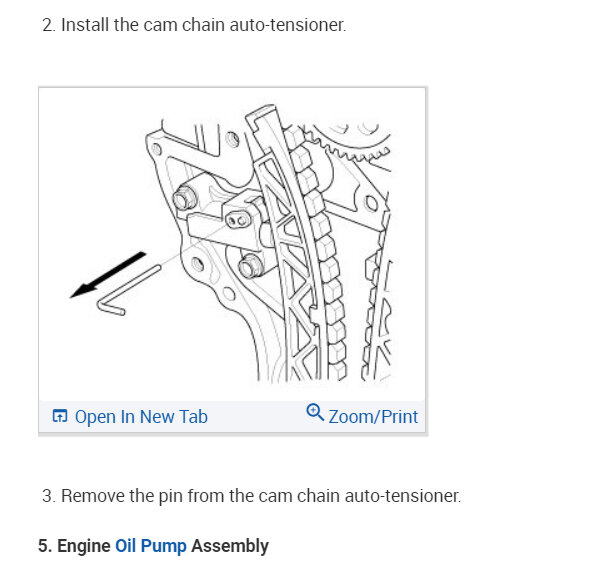

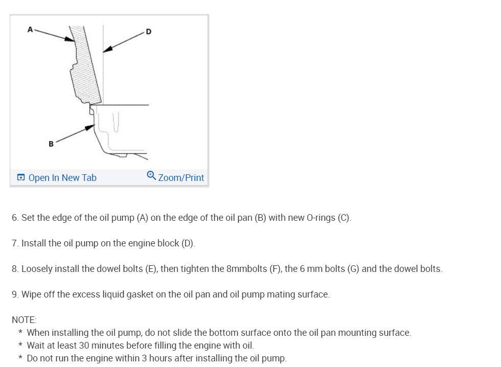

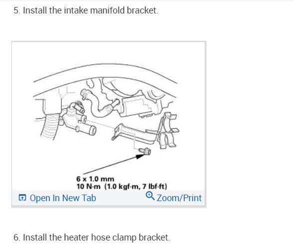

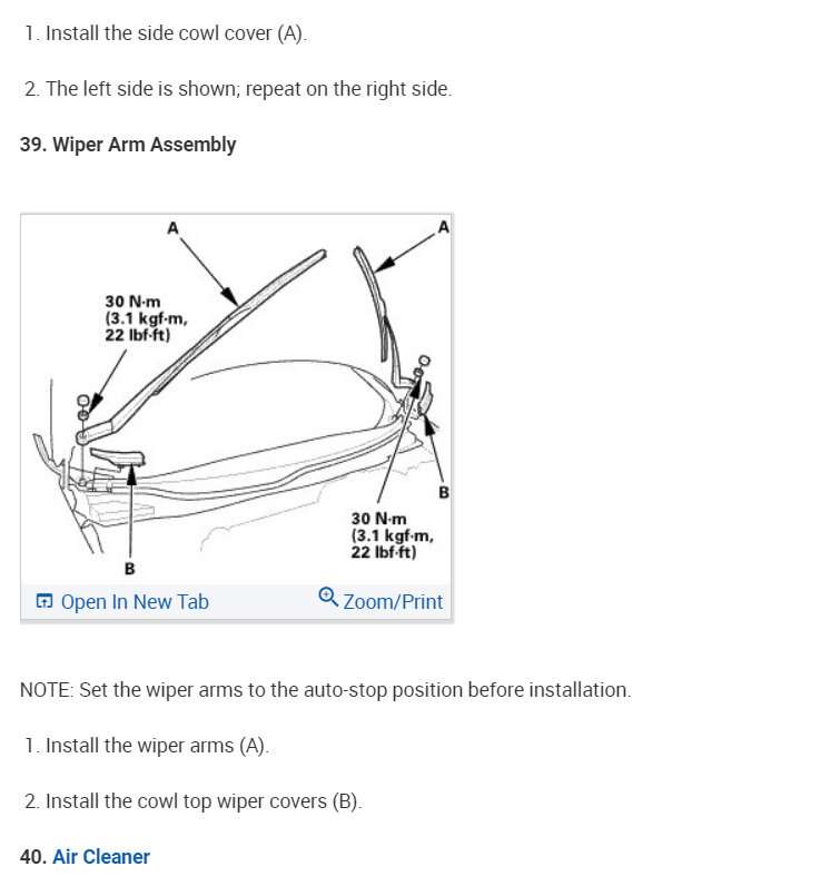

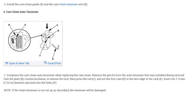

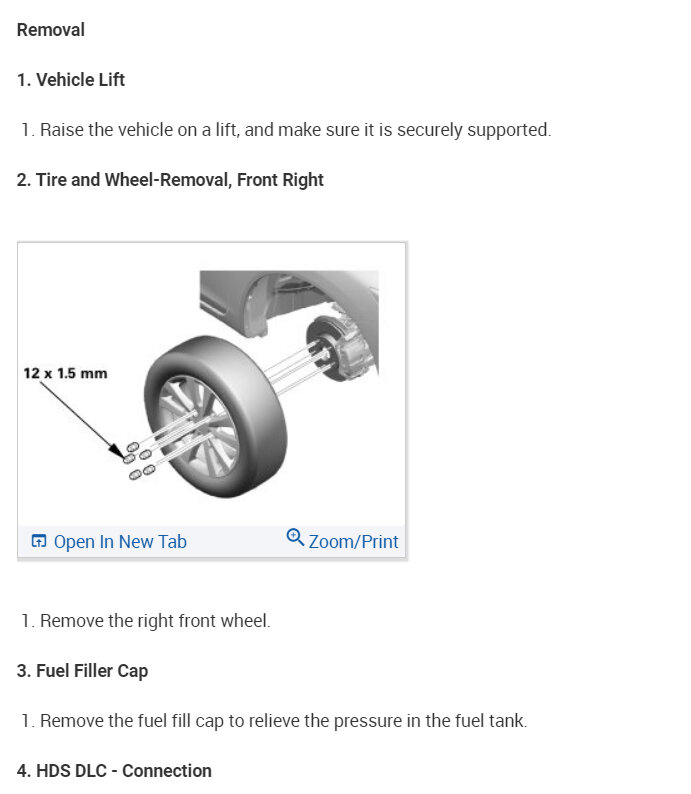

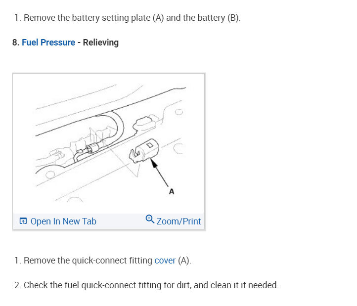

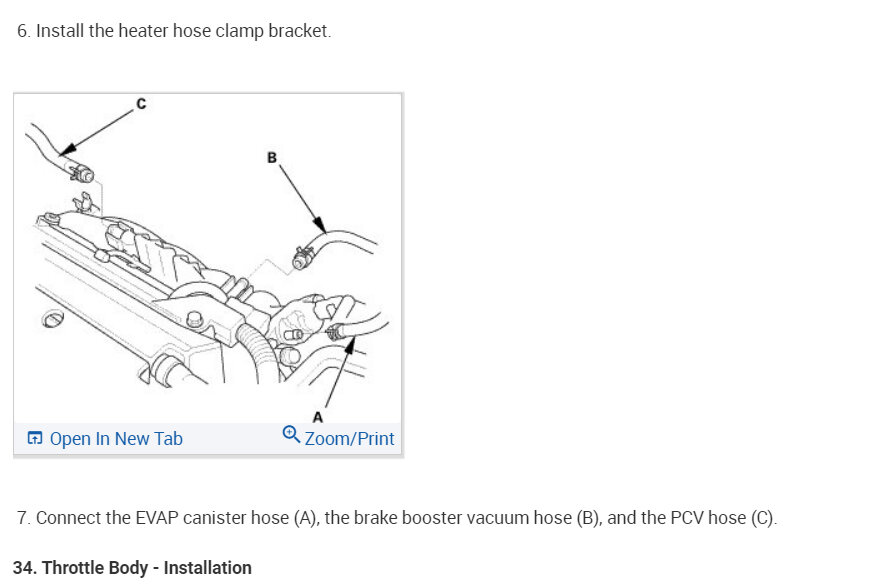

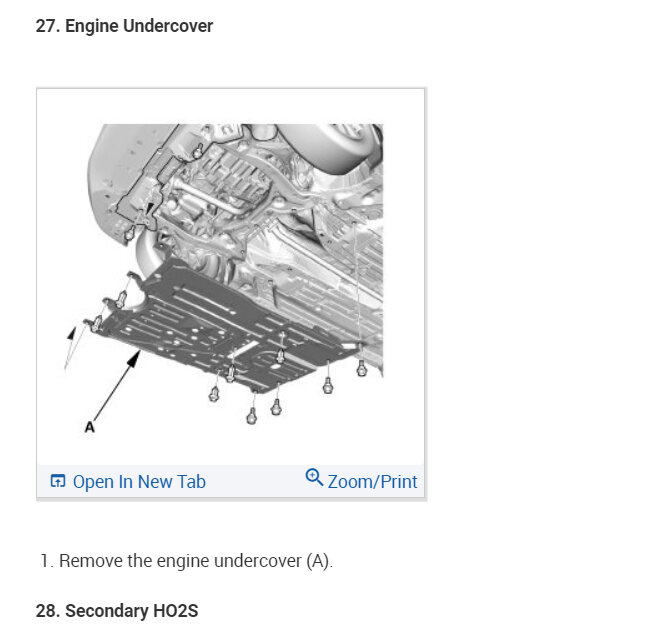

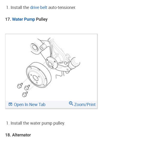

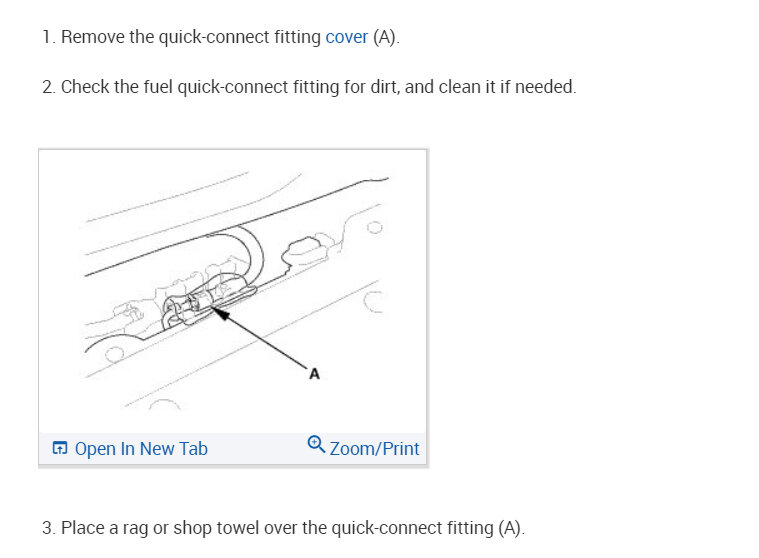

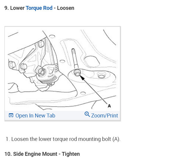

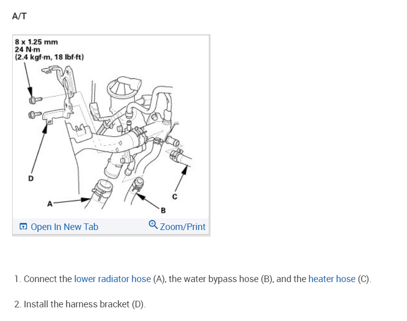

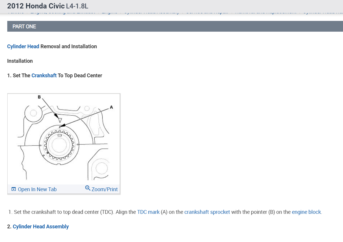

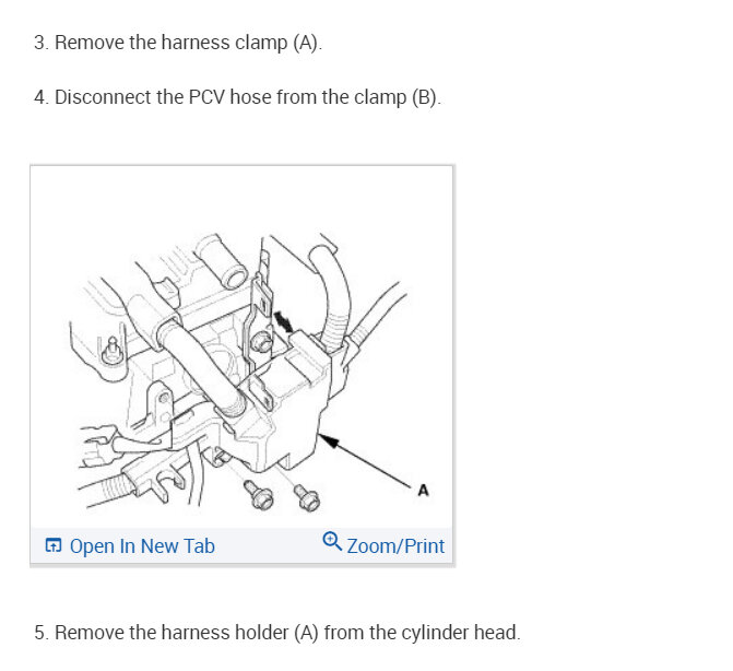

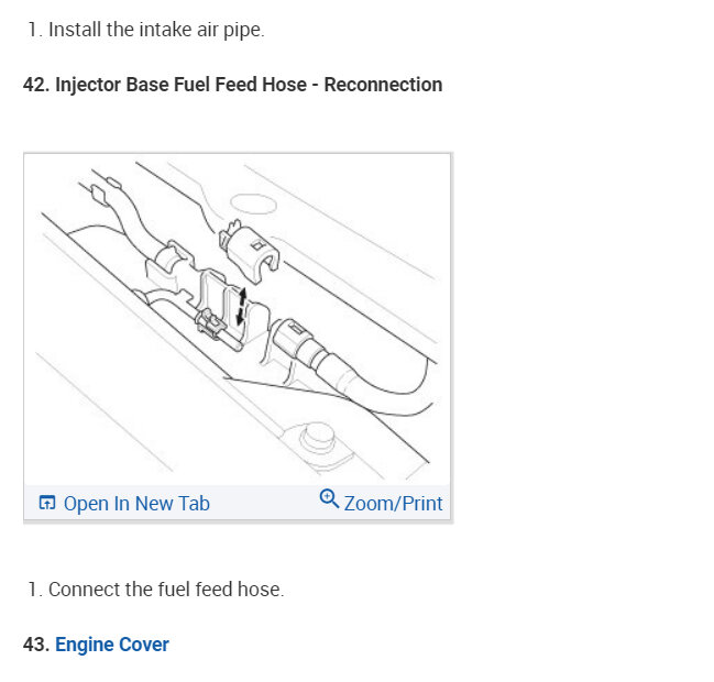

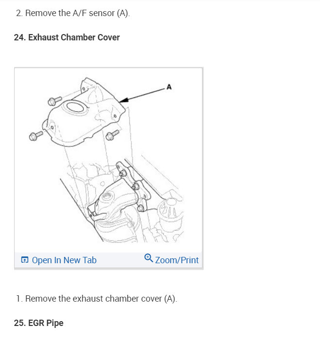

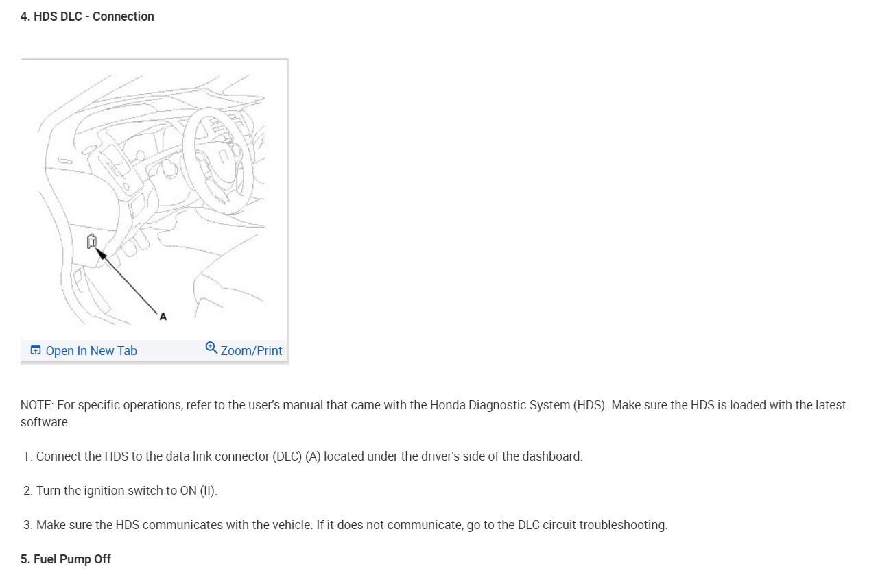

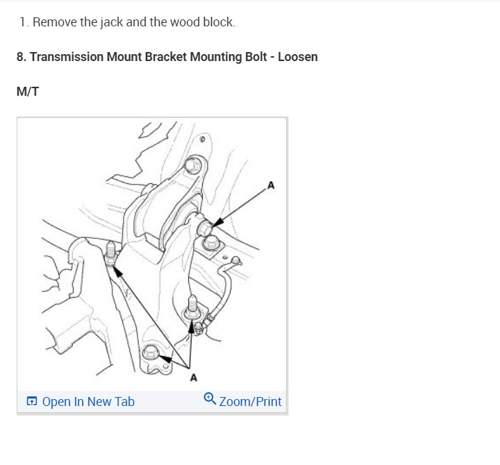

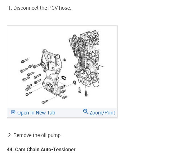

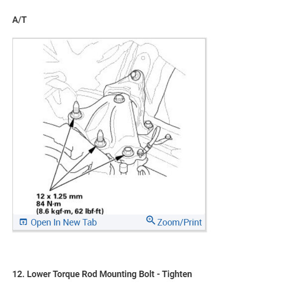

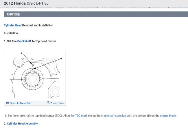

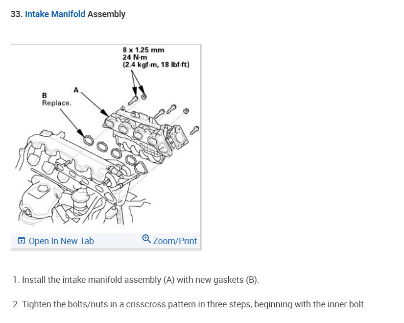

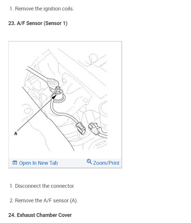

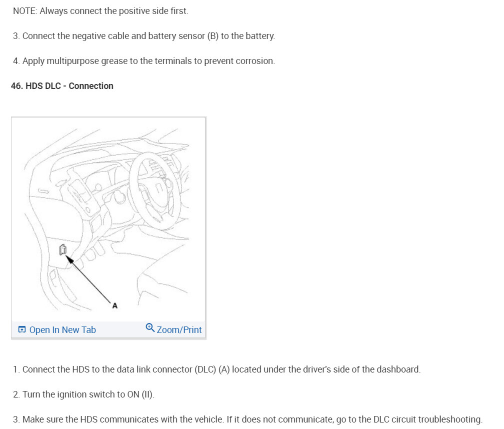

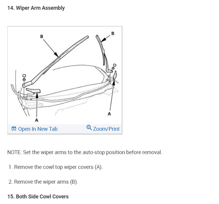

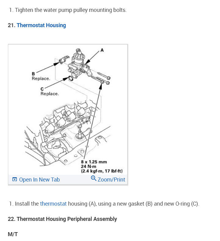

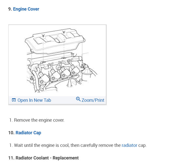

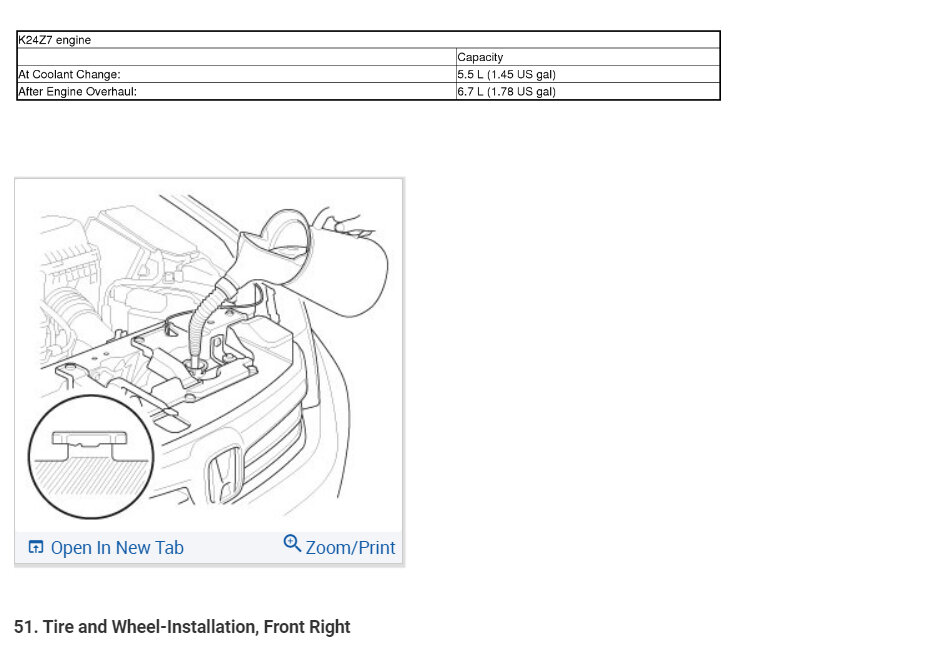

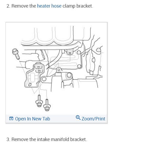

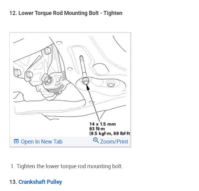

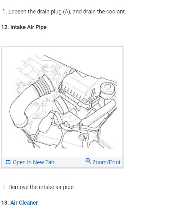

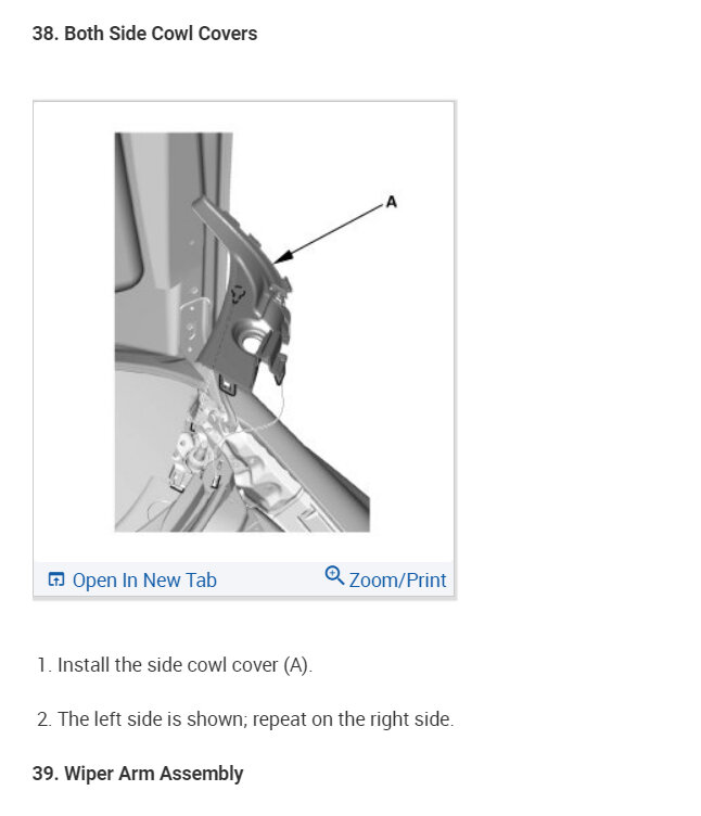

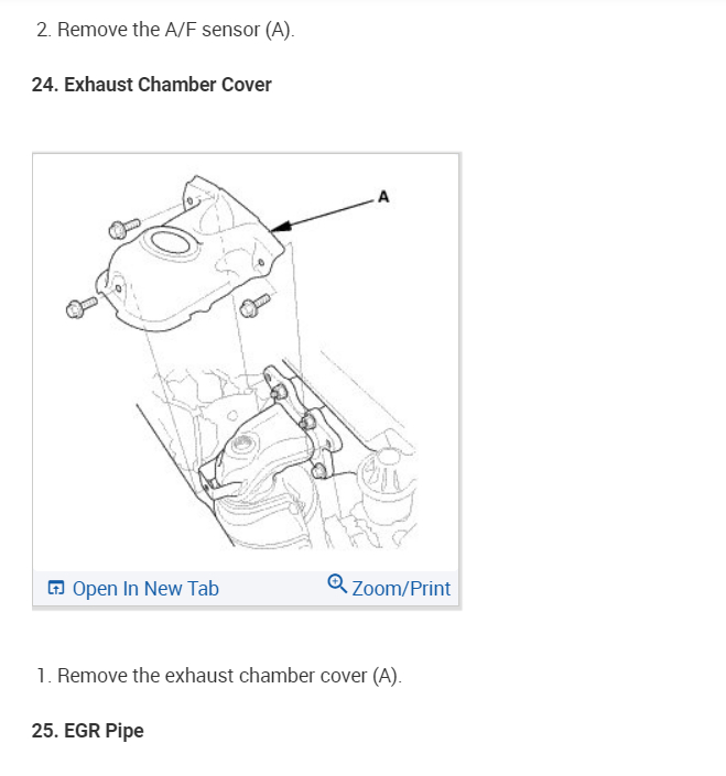

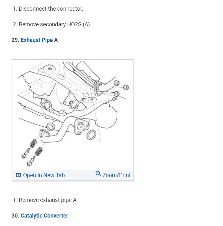

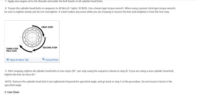

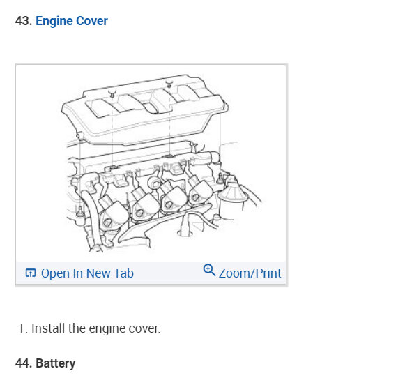

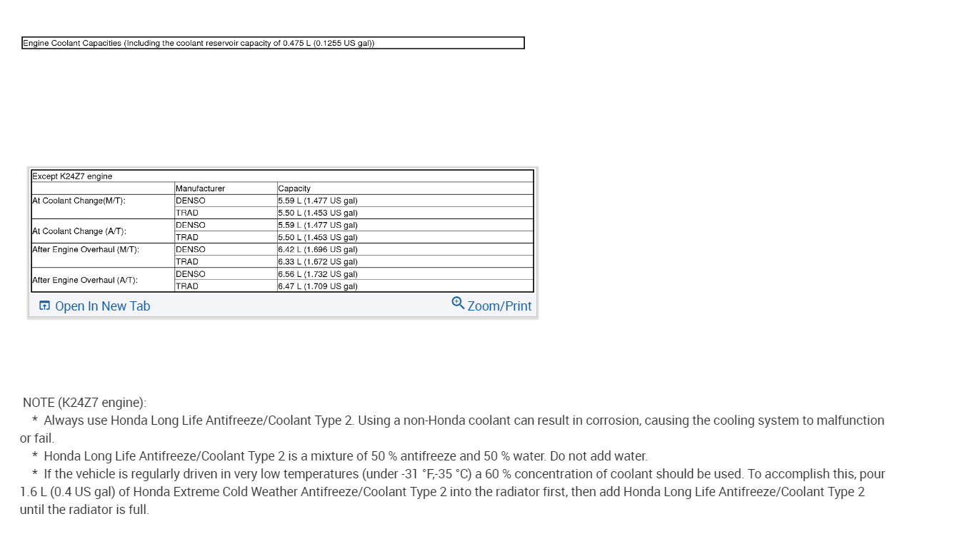

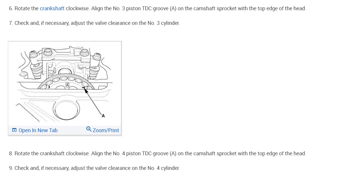

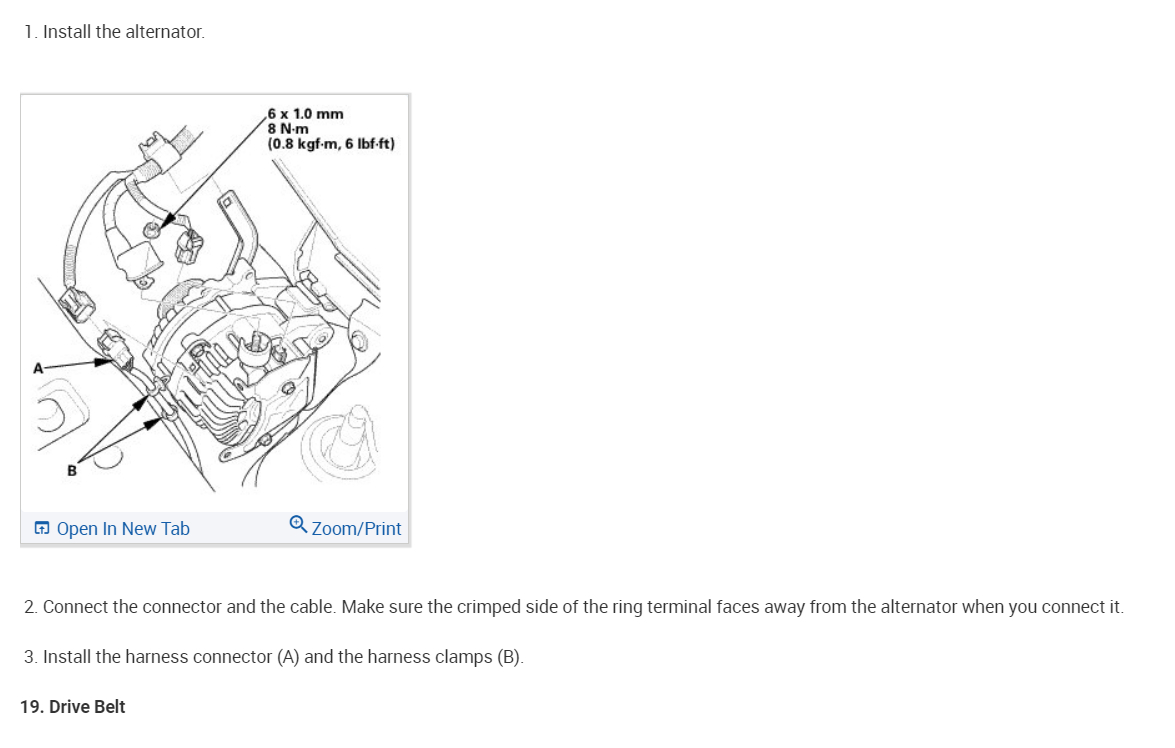

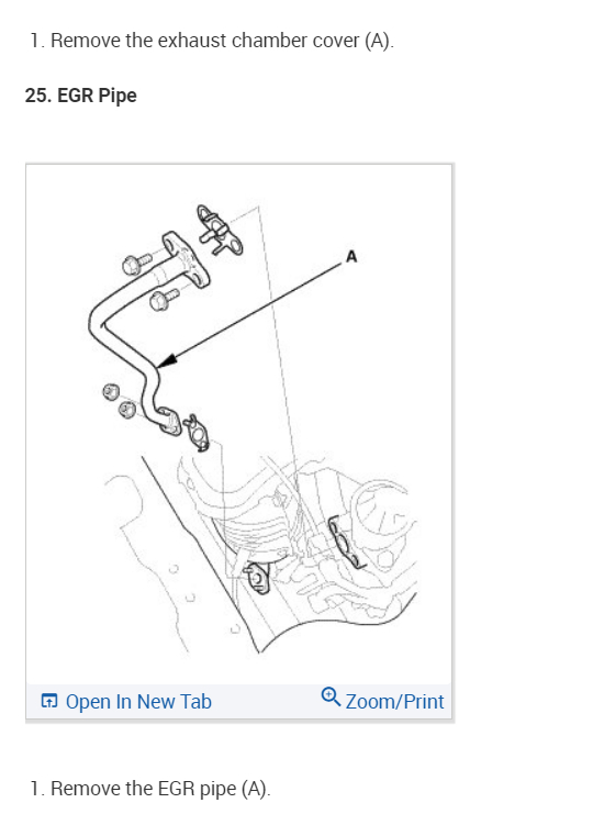

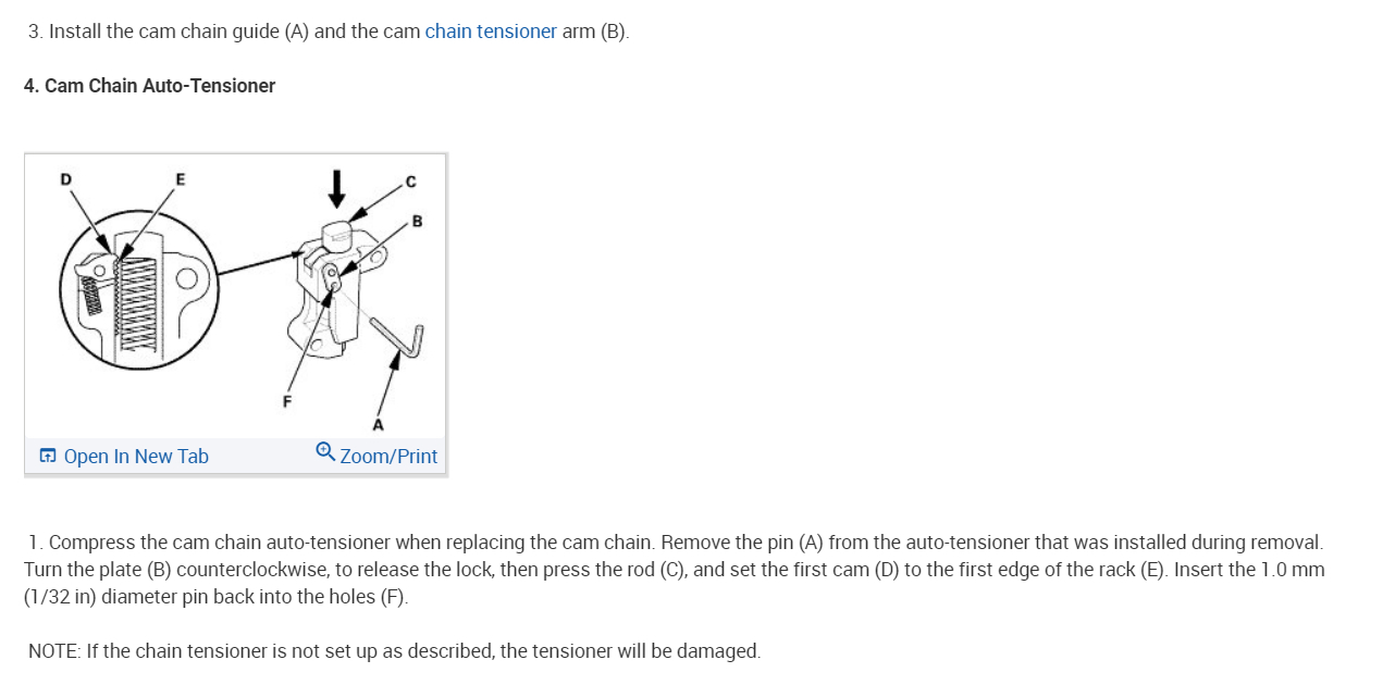

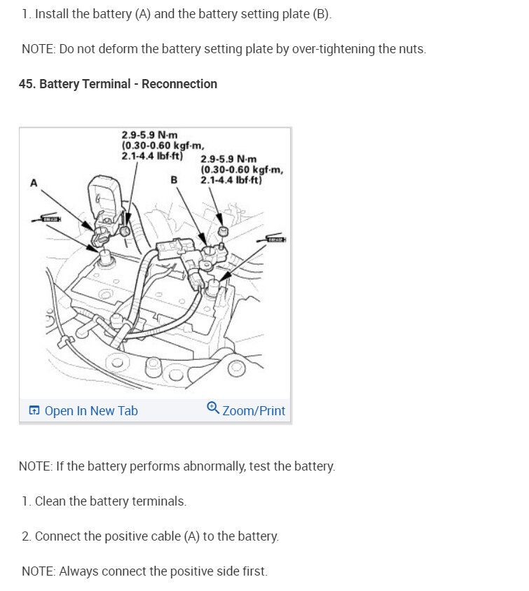

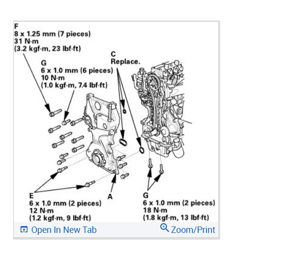

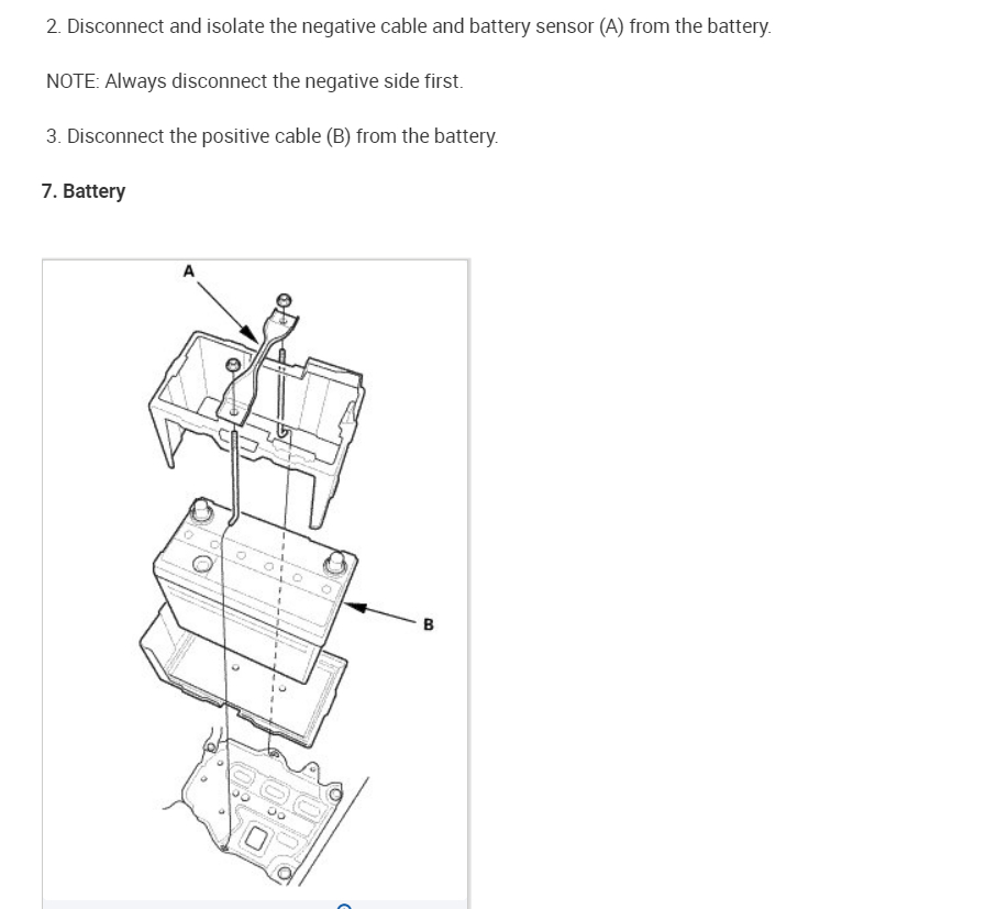

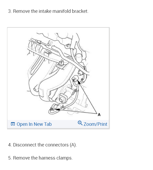

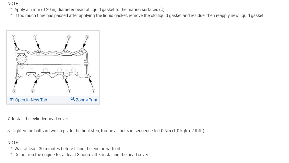

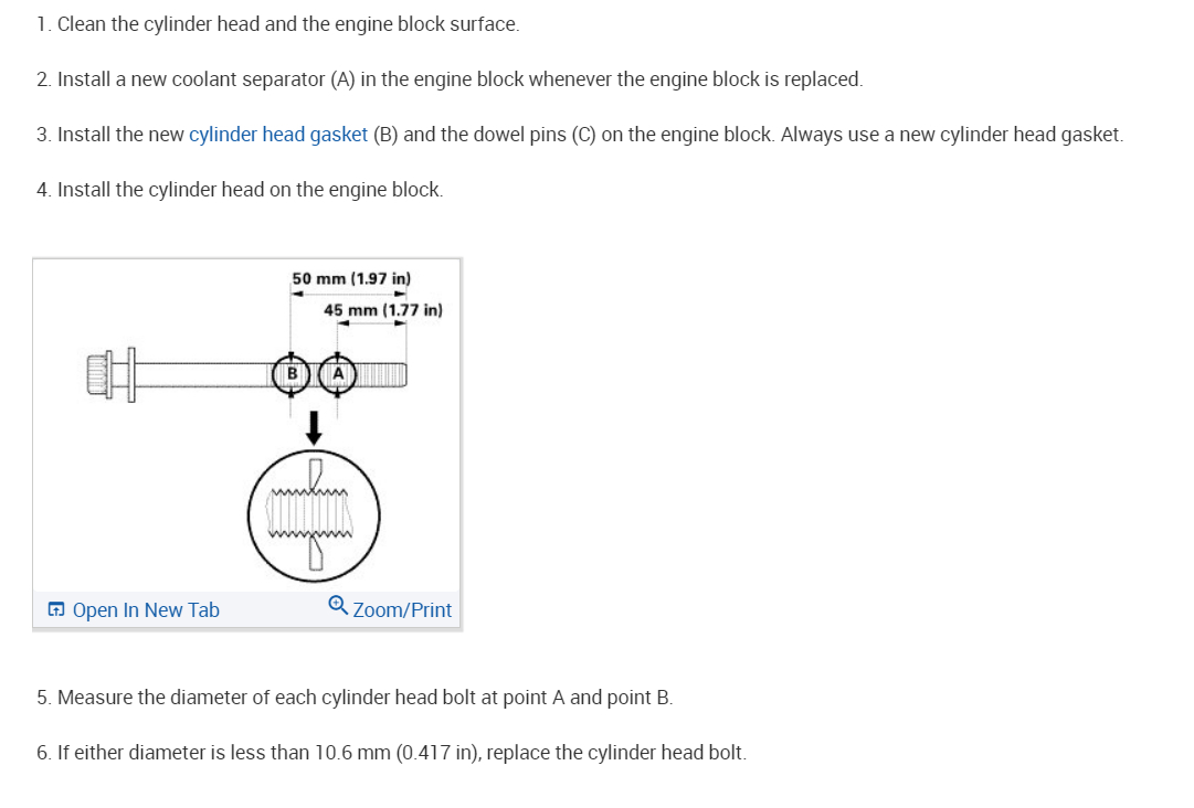

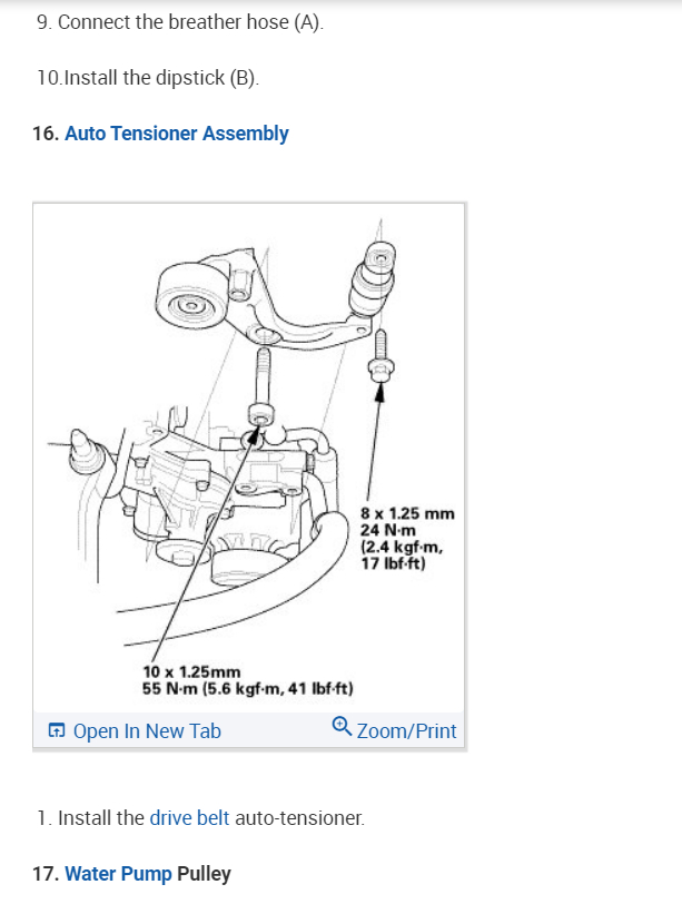

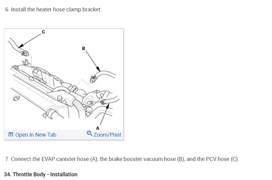

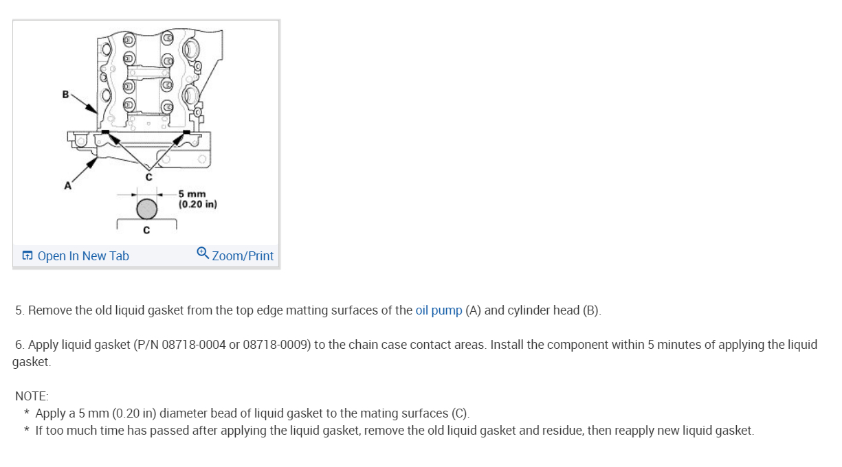

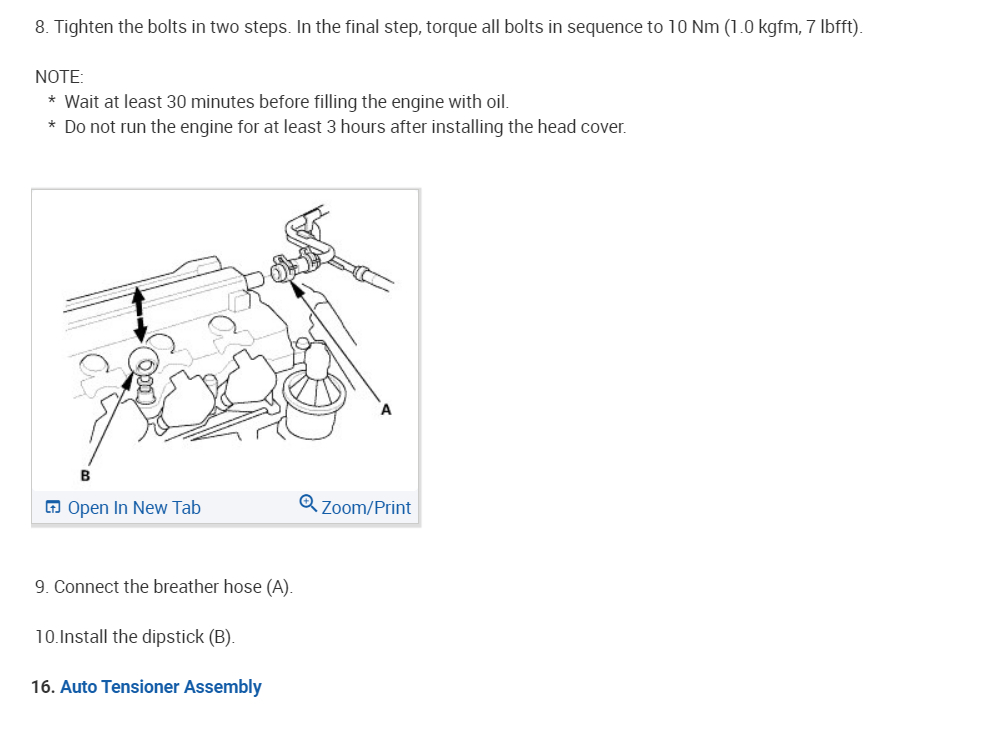

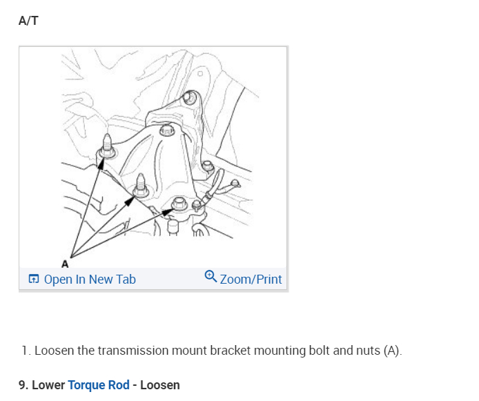

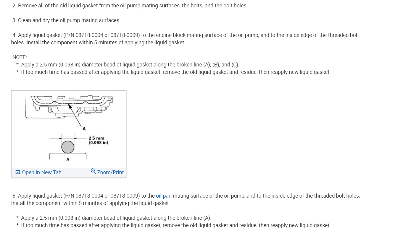

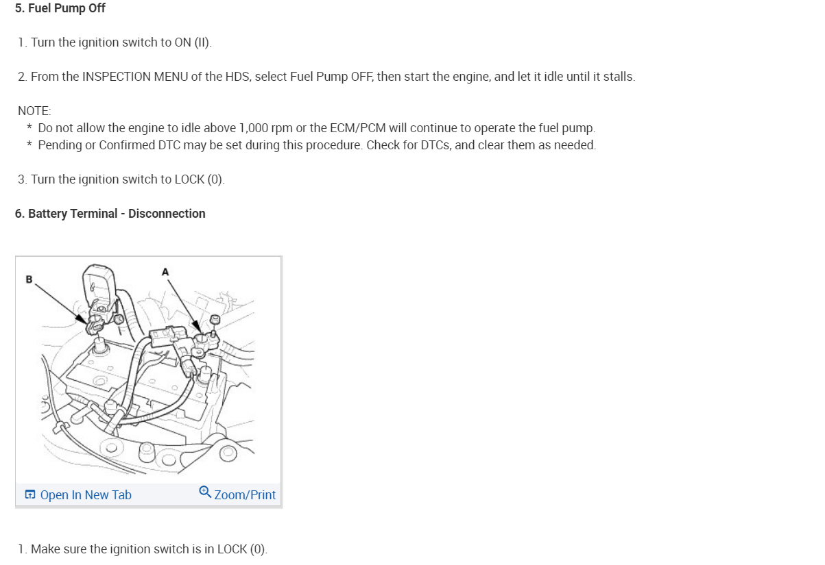

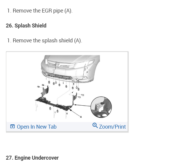

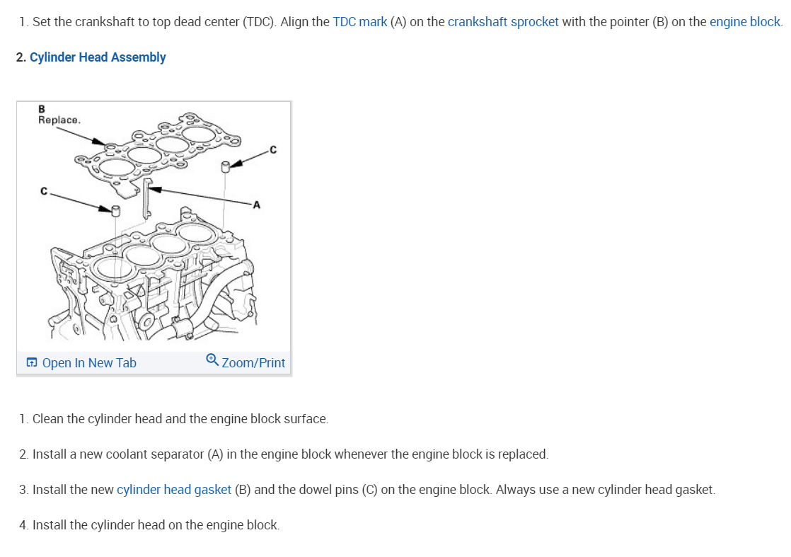

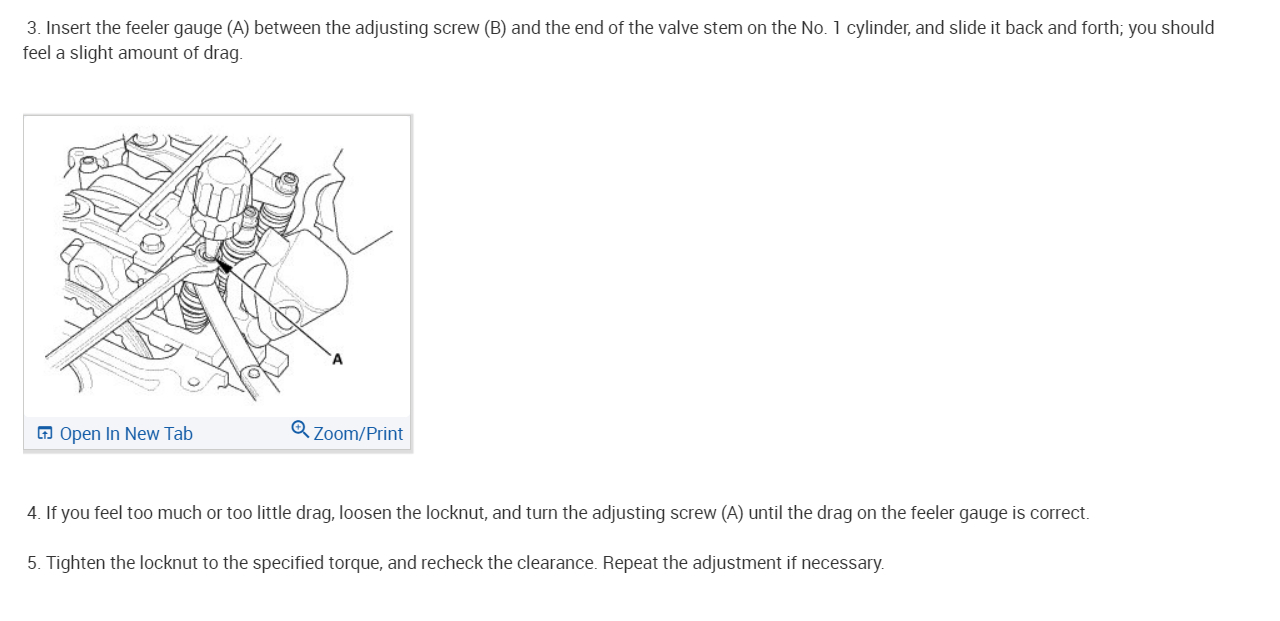

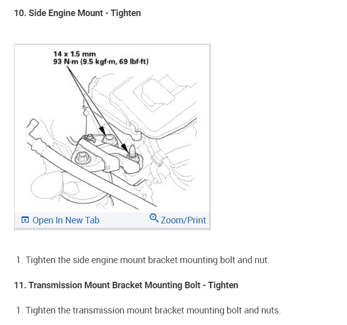

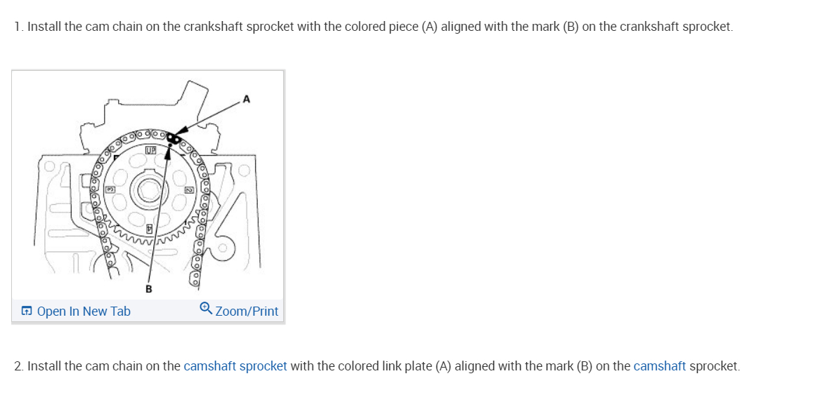

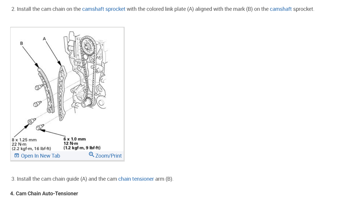

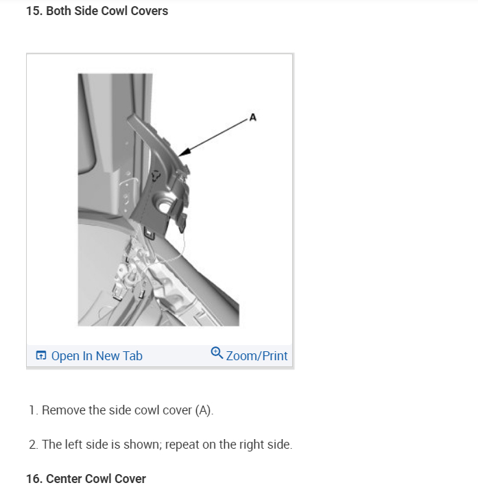

I had my cylinder head rebuilt and need instructions on how to put it back together. It is a natural gas fueled vehicle.
Mar 25, 2023 at 9:06 AM
  • 55,694 POSTS

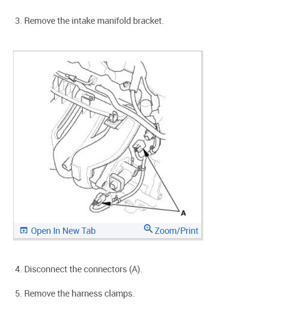

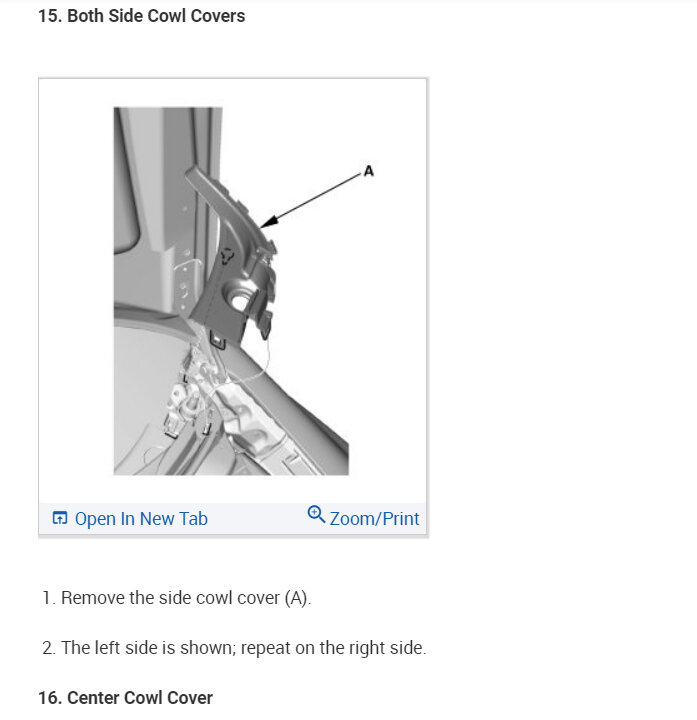

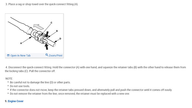

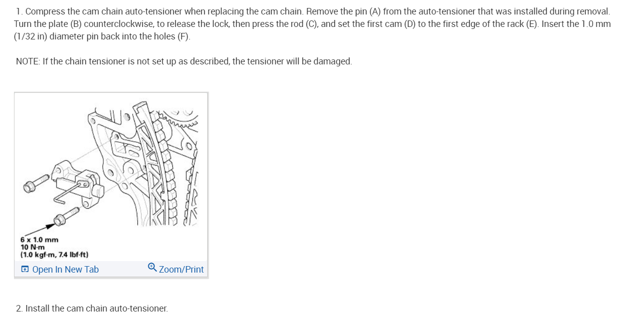

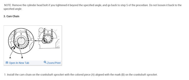

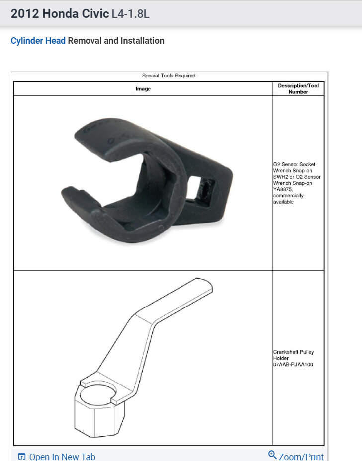

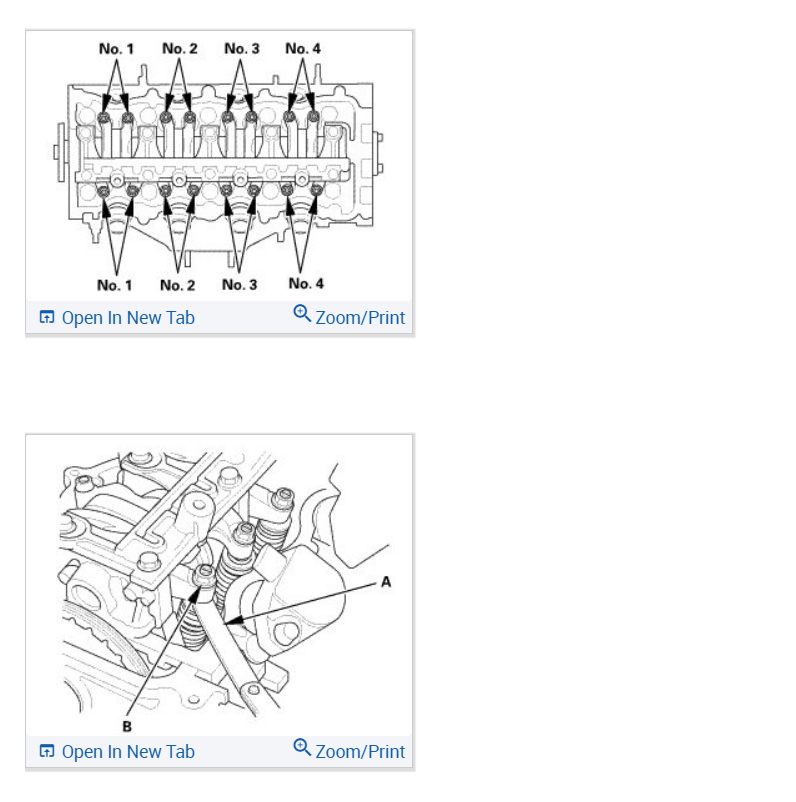

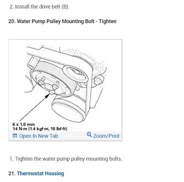

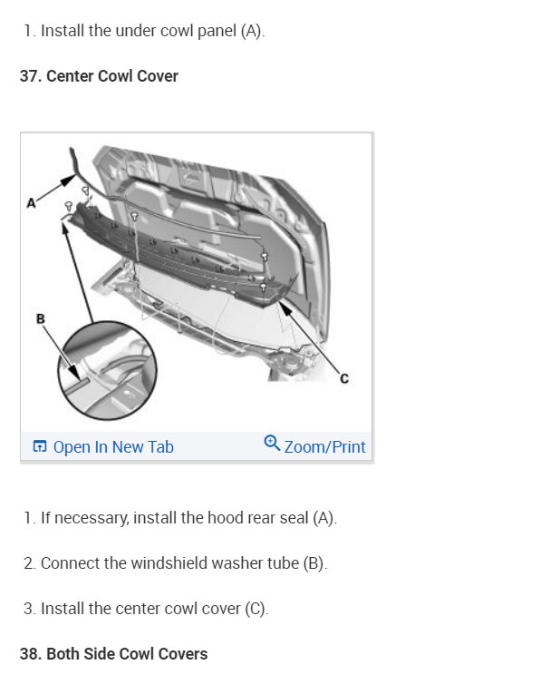

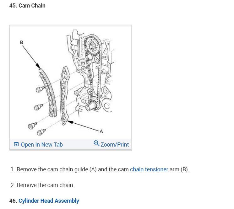

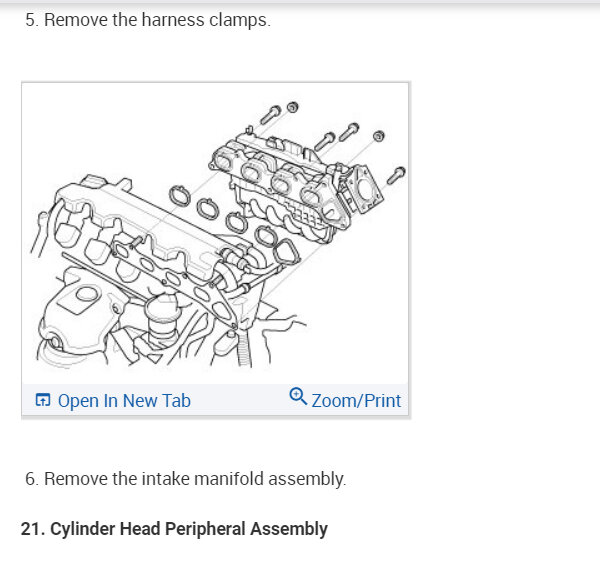

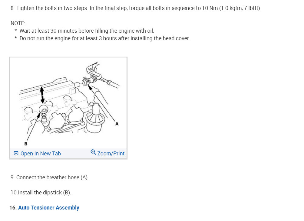

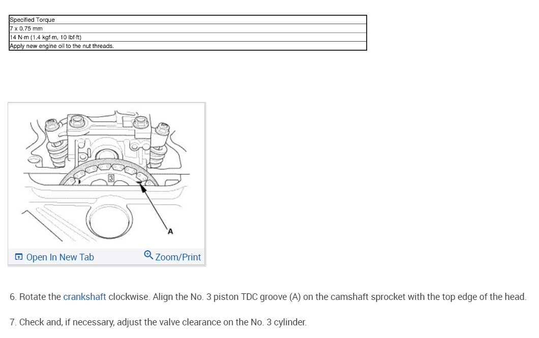

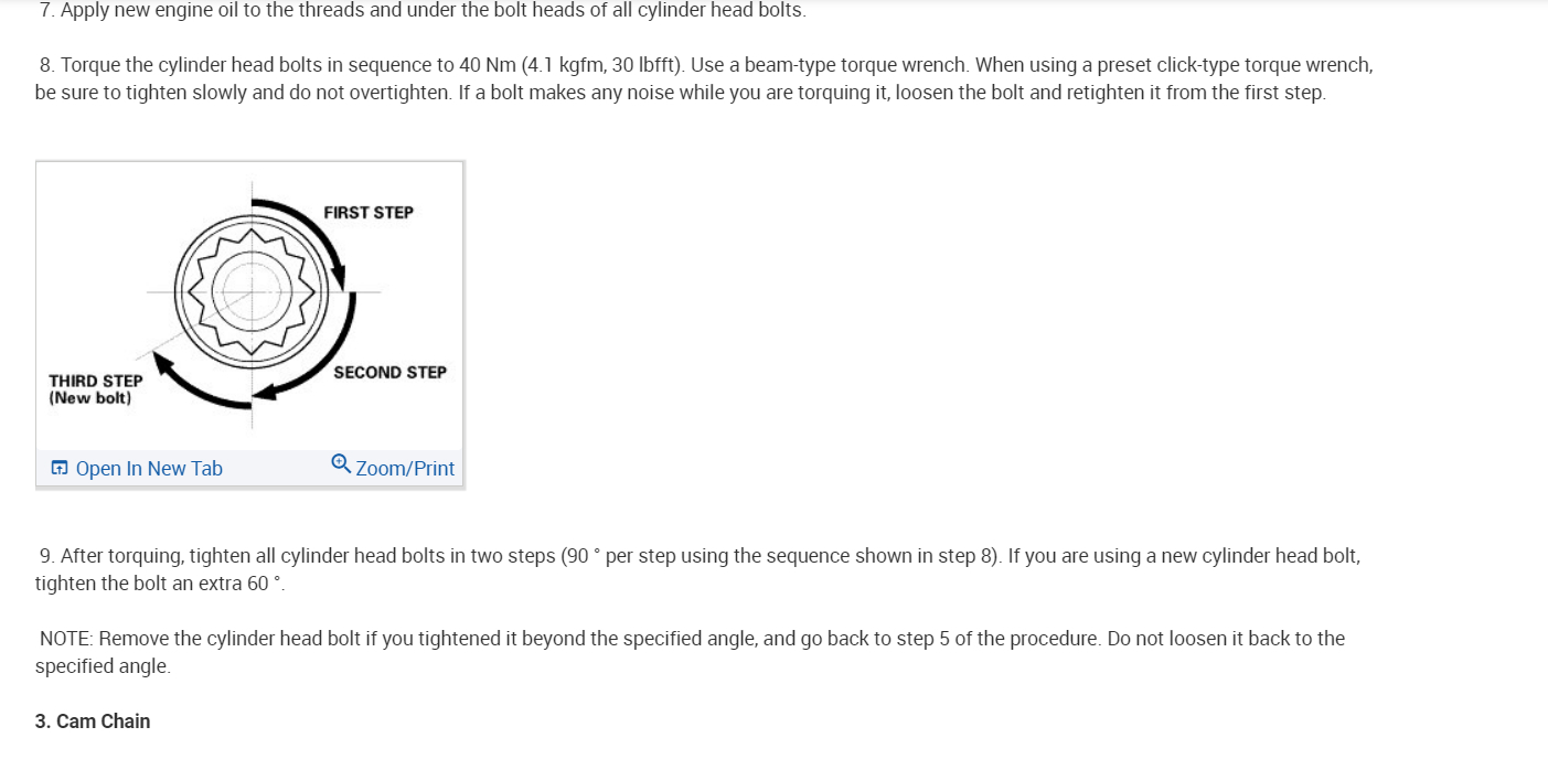

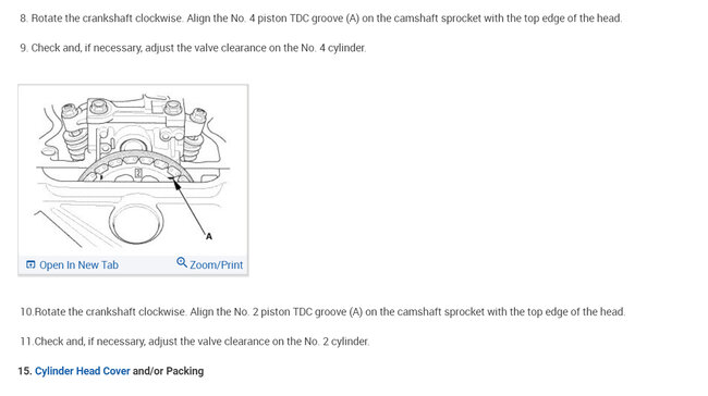

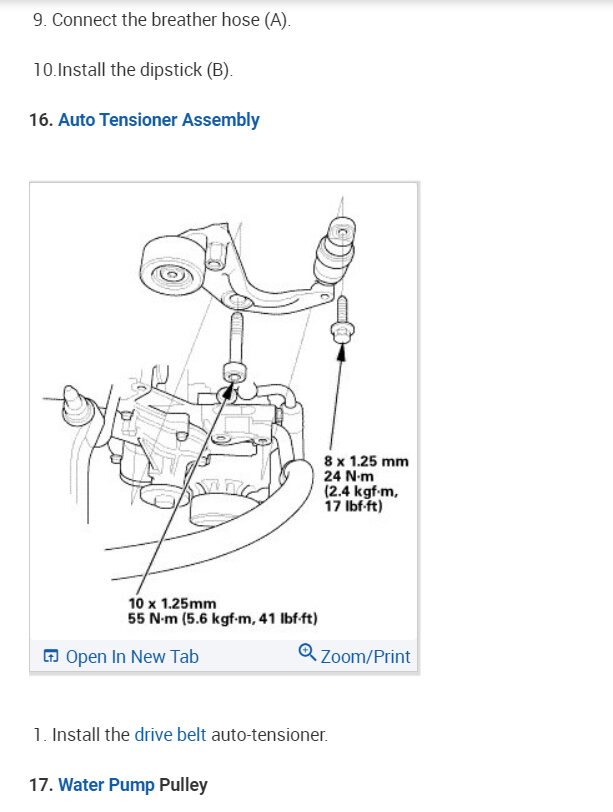

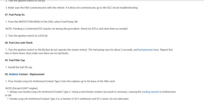

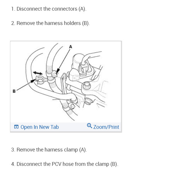

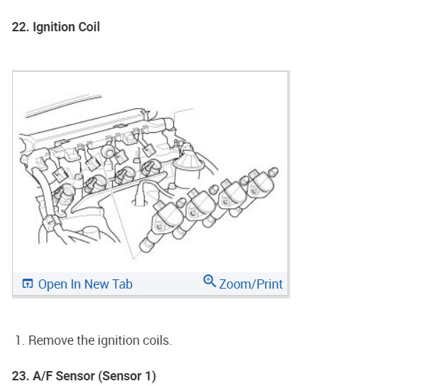

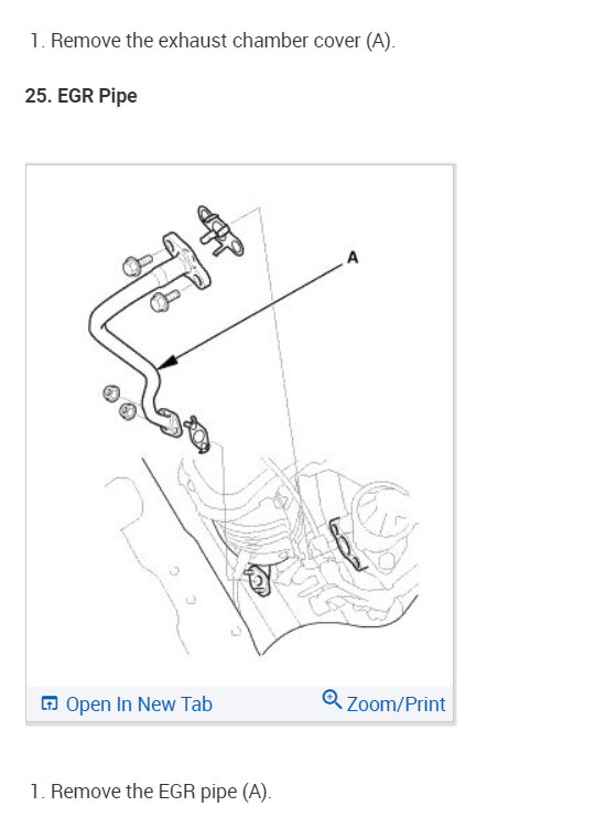

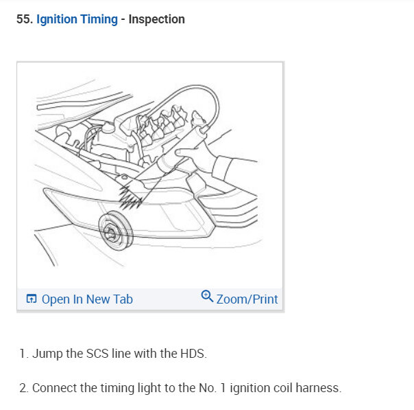

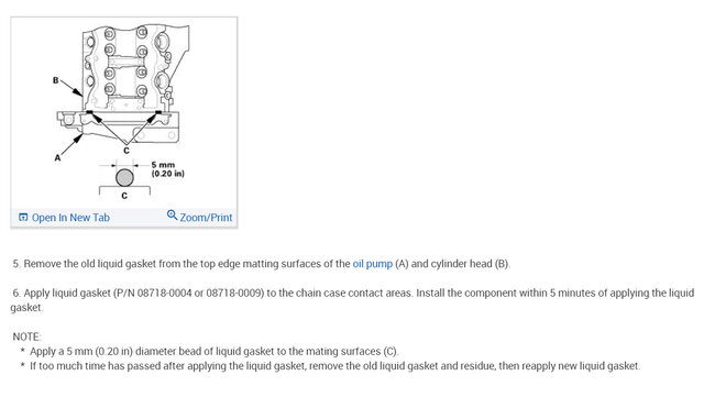

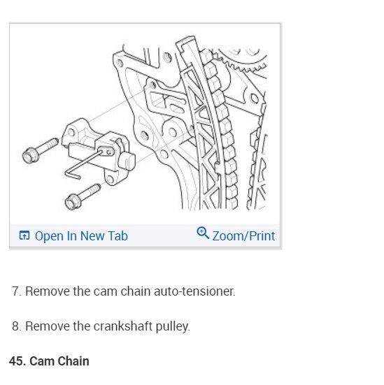

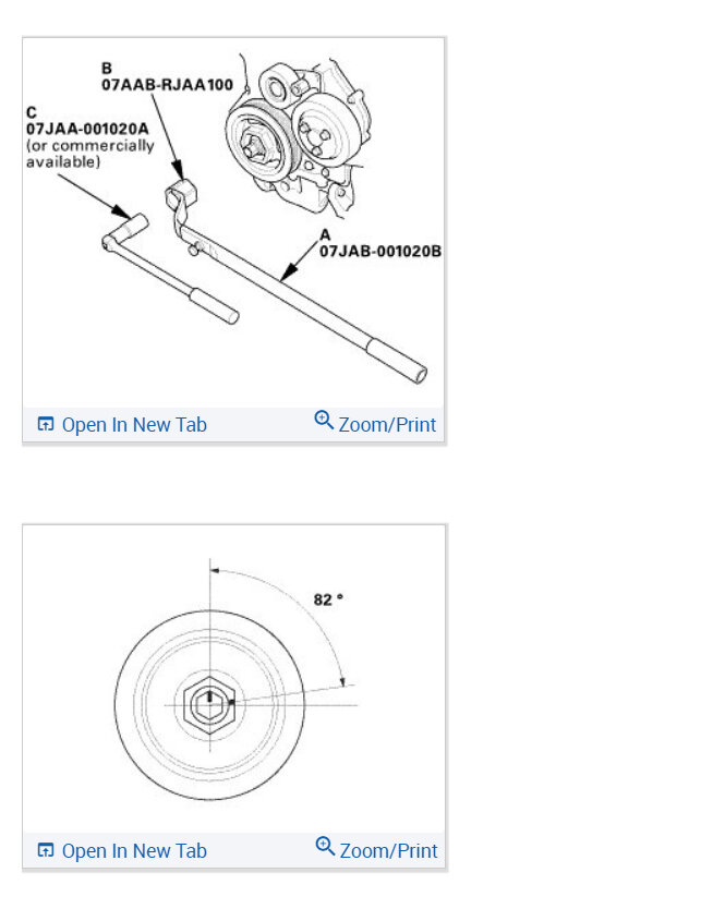

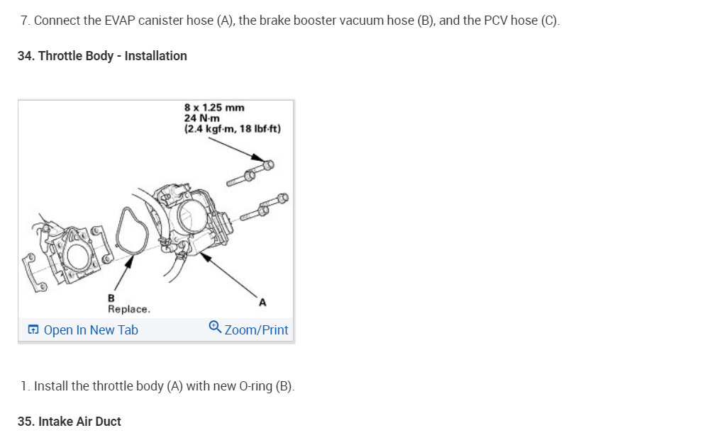

Here is the way you can remove the cylinder head and I have included the reinstallation instructions in the second post because there are many of them. Check out the images (below). Please let us know if you need anything else to get the problem fixed. There are some special tools I have included as well.
Mar 26, 2023 at 10:20 AM
  • 55,694 POSTS

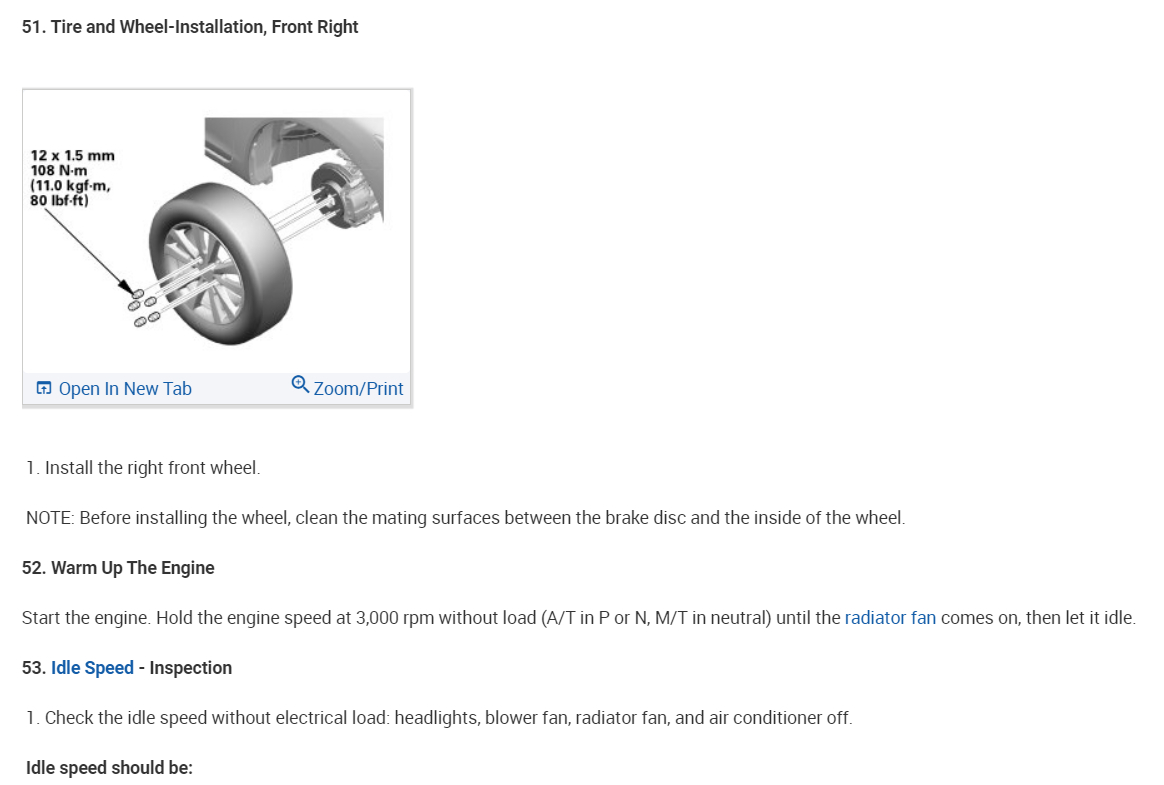

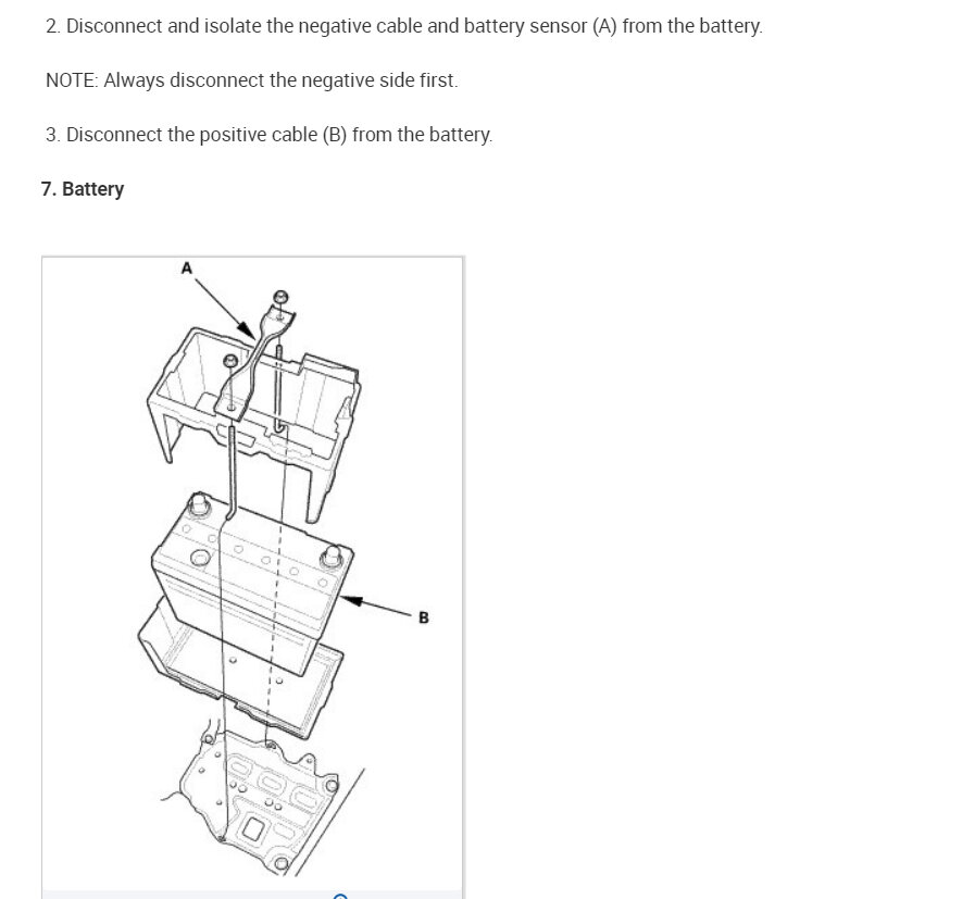

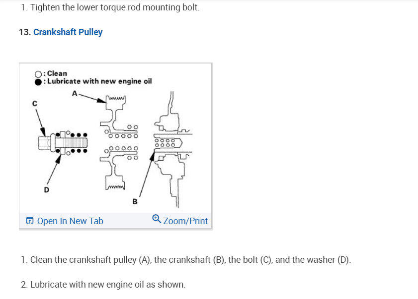

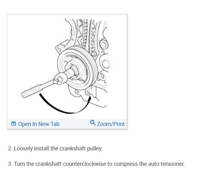

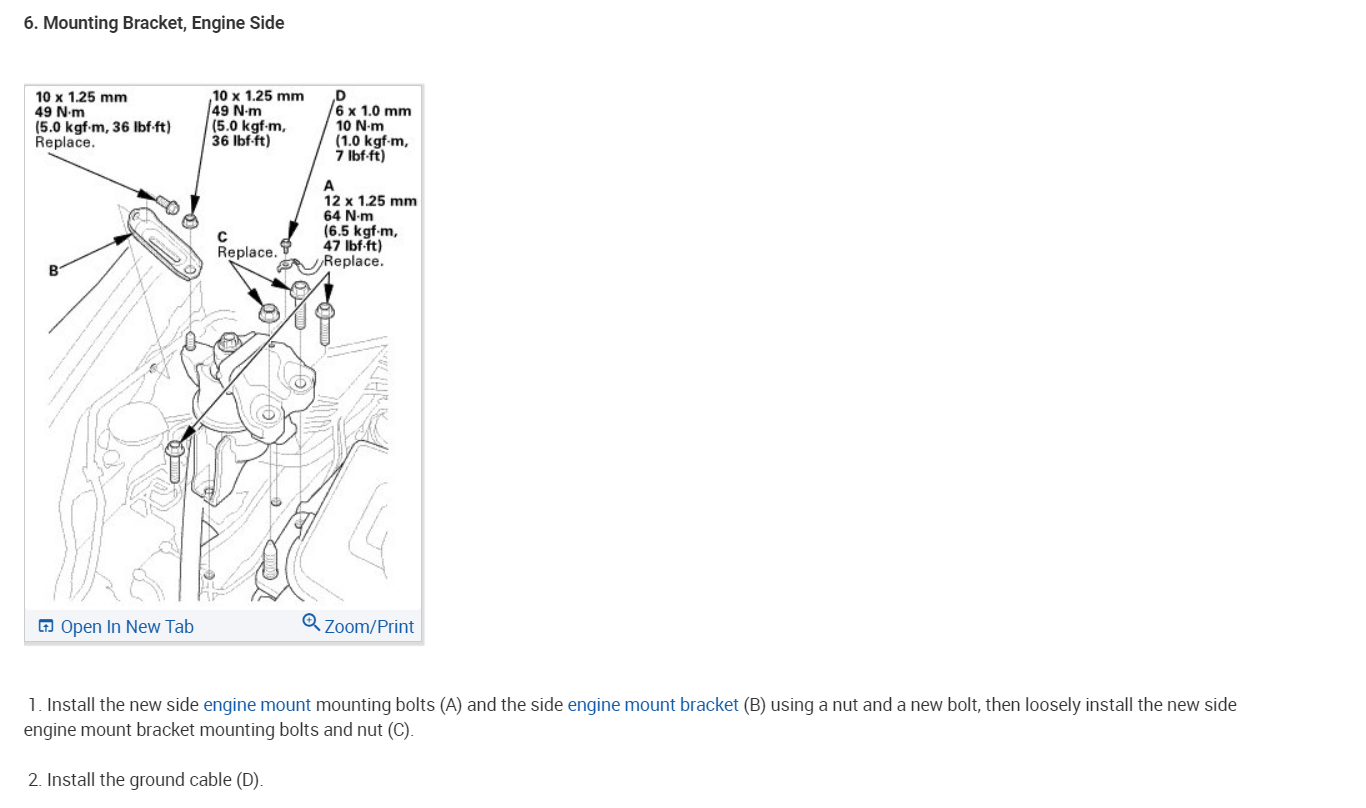

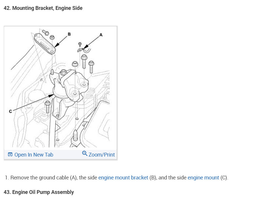

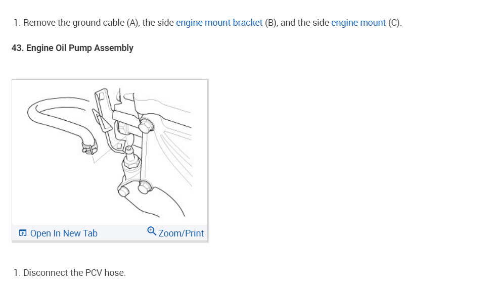

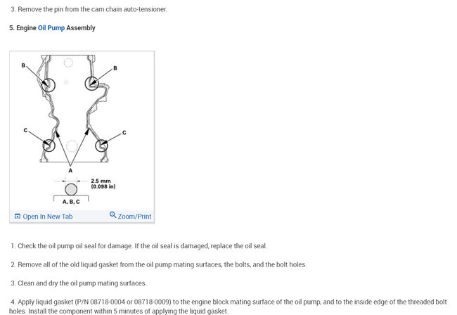

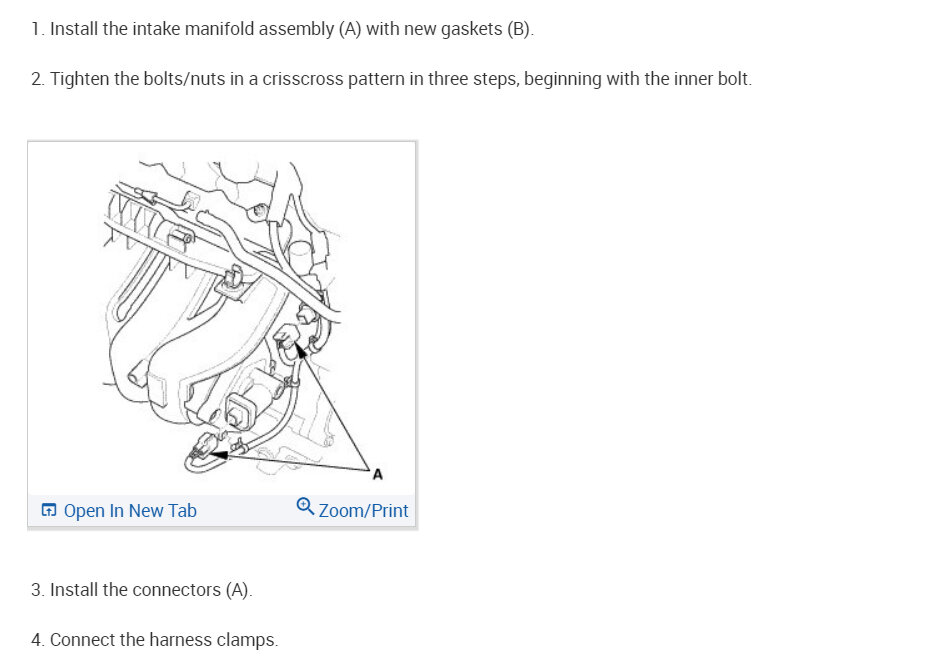

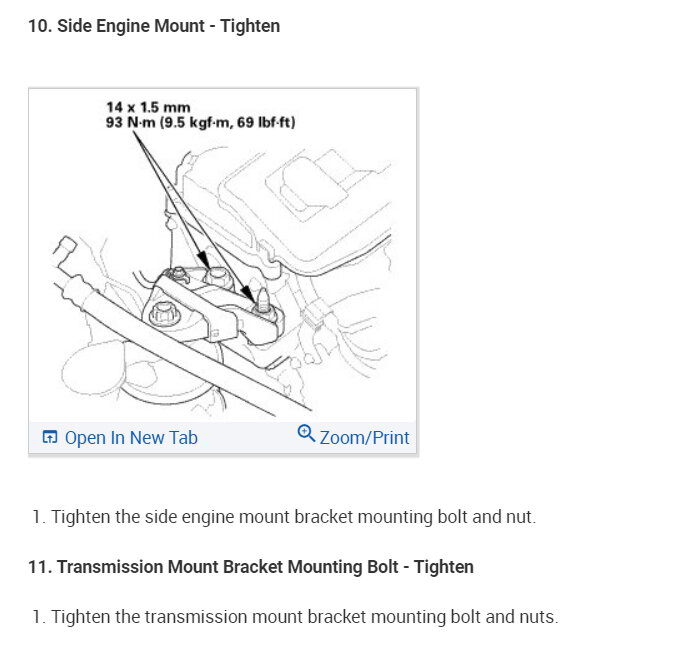

Here are the remainder of the reassembly of the cylinder head instructions.
Mar 26, 2023 at 10:37 AM
JAY T FRANDSEN
Wow, this is excellent!
