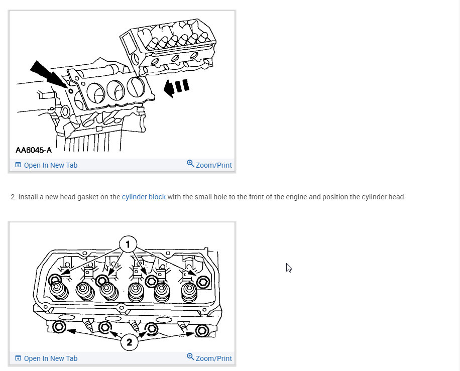

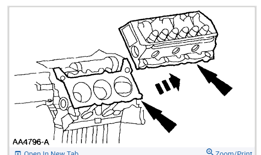

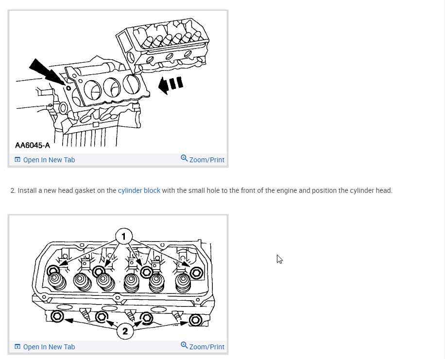

What is the correct head placement for my van?
Nov 8, 2019 at 8:51 AM
I am not sure I understand what you mean by head placement. Do you mean the cylinder head? If so, what is meant by placement? Installation direction? Do the attachments help? These are for the left hand side head. If not, just give me a little more detail about what you are looking for.
