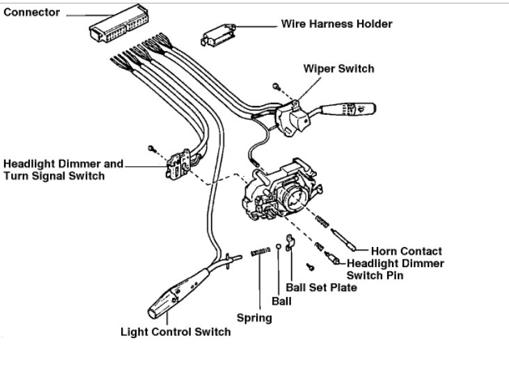

My headlights just stop working right along with my tail lights and if i click my high beams they do not stay on. if i pull the signal switch towards me and hold them then the high beams with come on but the right and left blinker and hazard lights work. so basically i can only drive my car is the daytime and only if it is not raining. i check on the fuses the relay fuse under the hood and under the steering wheel they are all good.
Please help me so I can fix this.

It sounds like you have a problem with the headlight control switch which is common on these older cars. Check the wiring through the switch to confirm the issue.
Below are diagrams to help you get it changed out.
