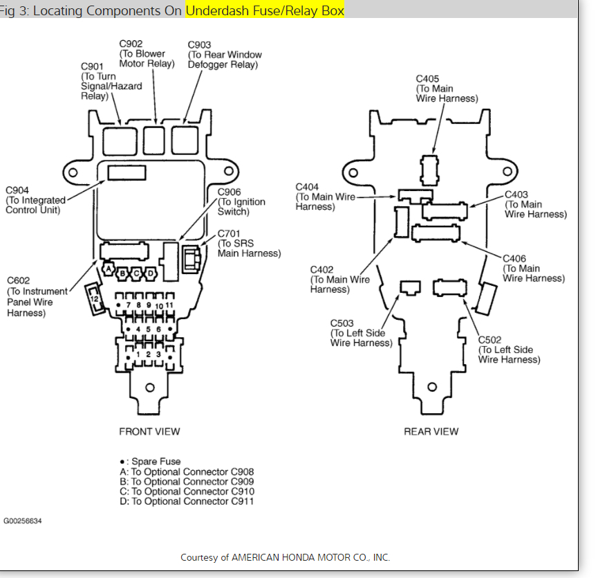

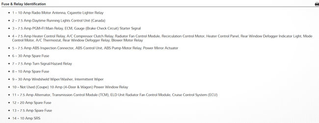

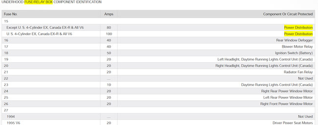

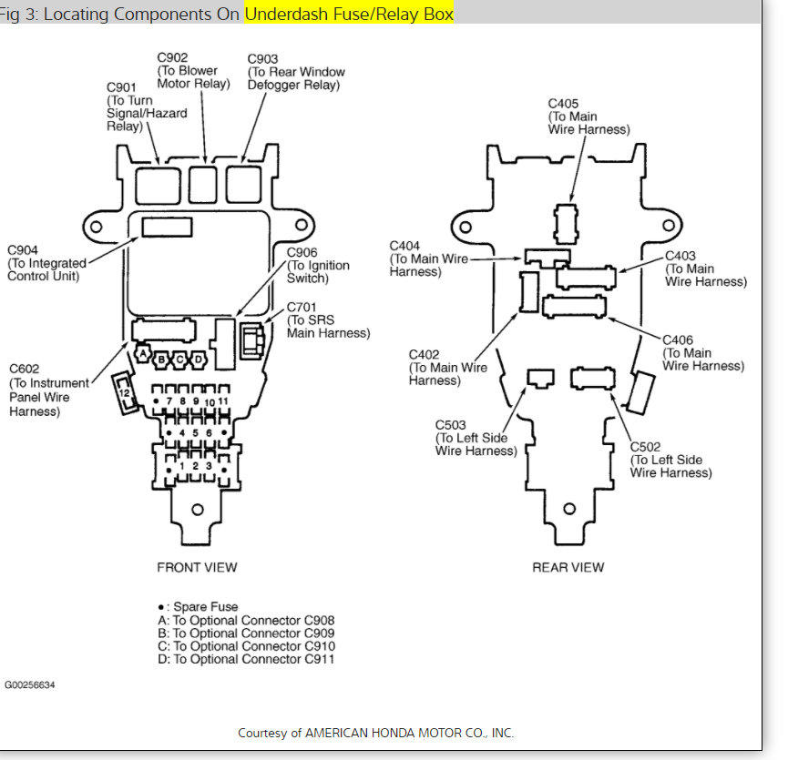

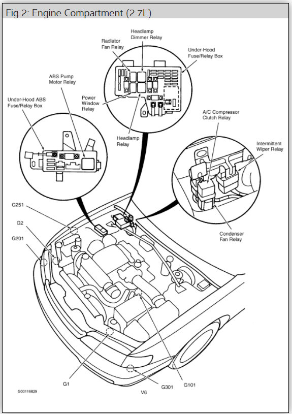

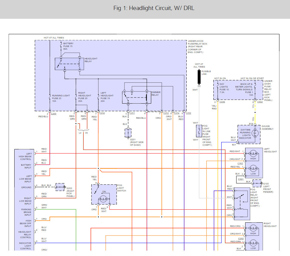

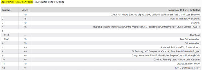

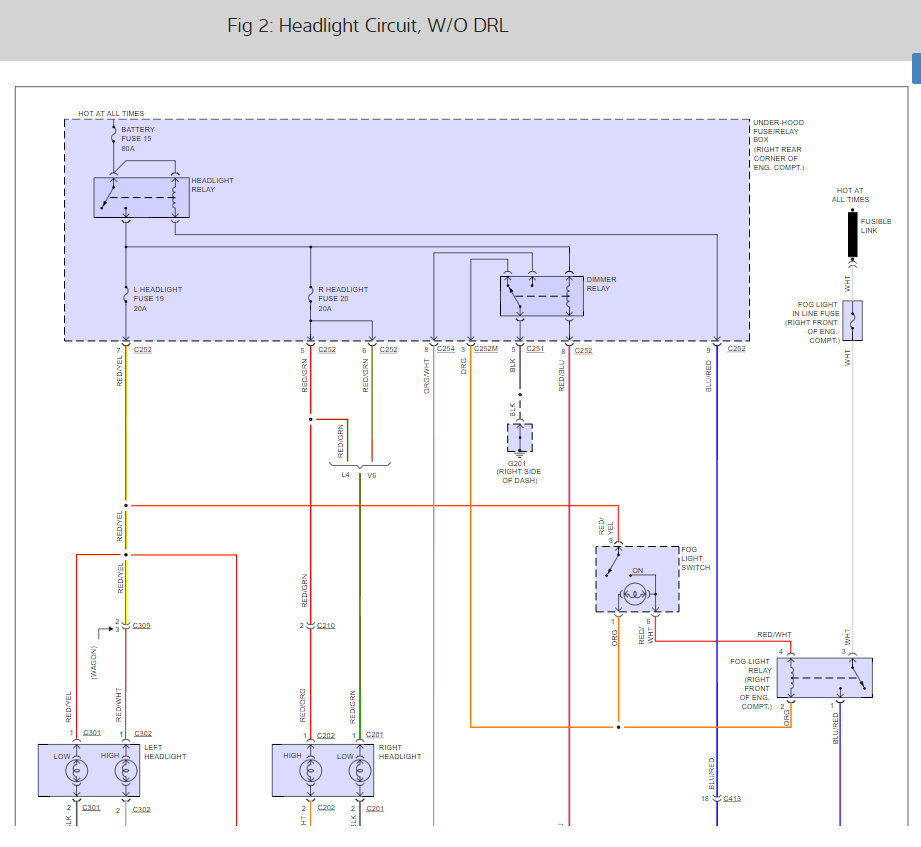

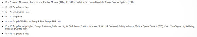

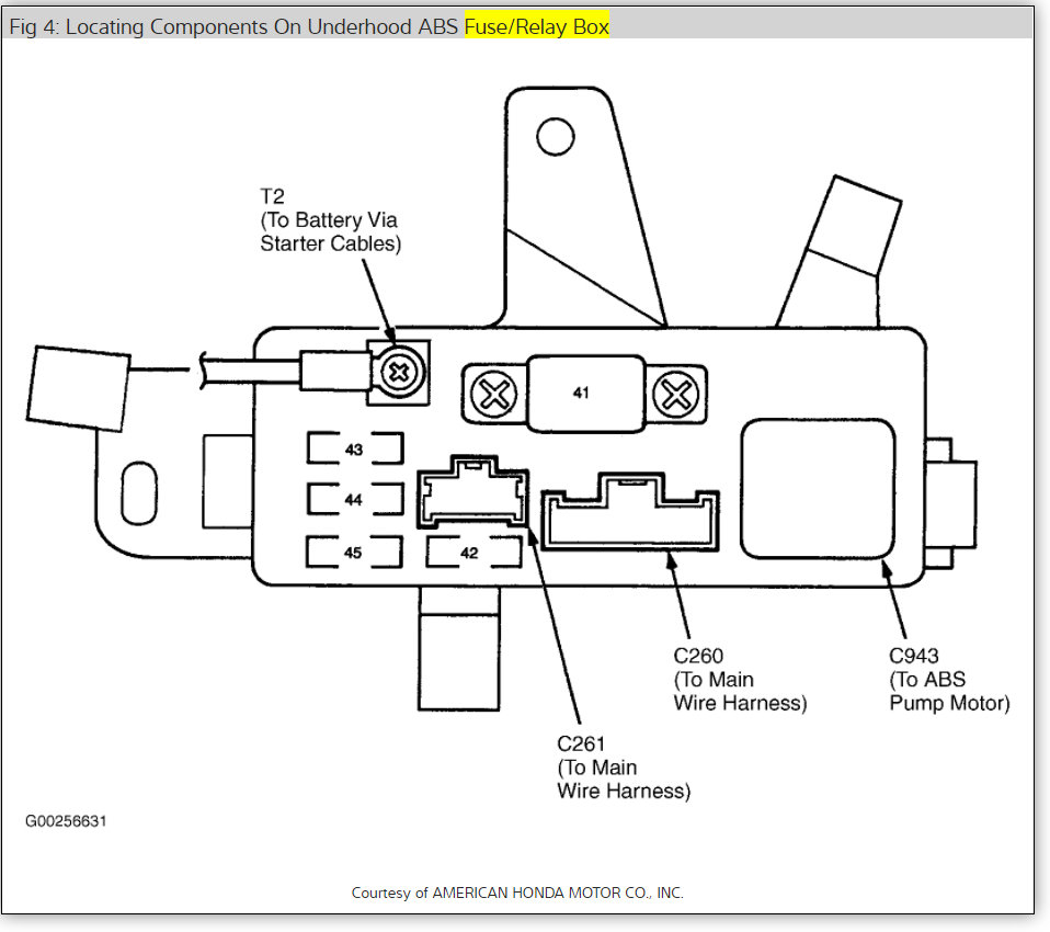

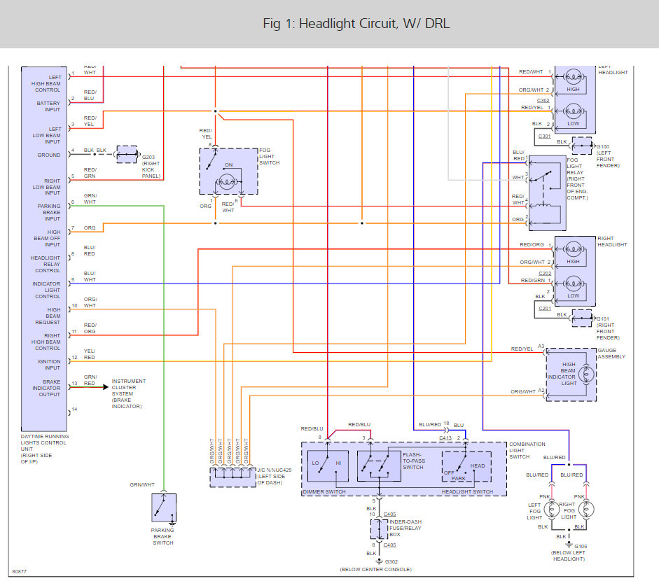

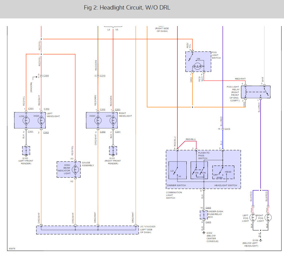

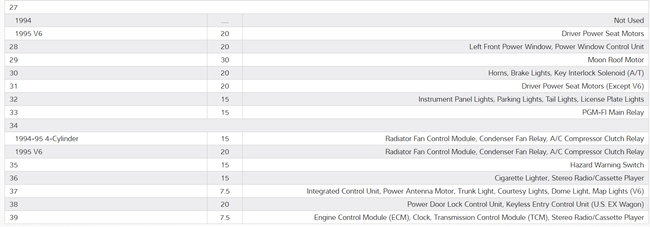

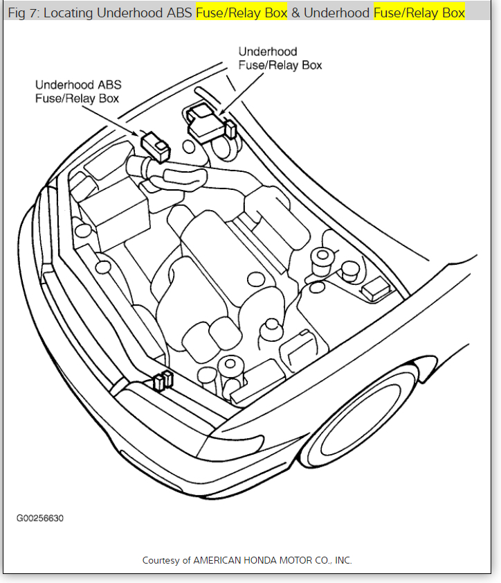

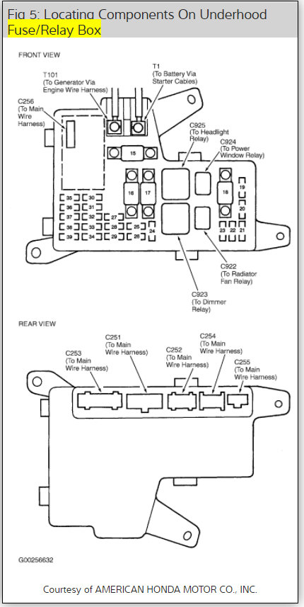

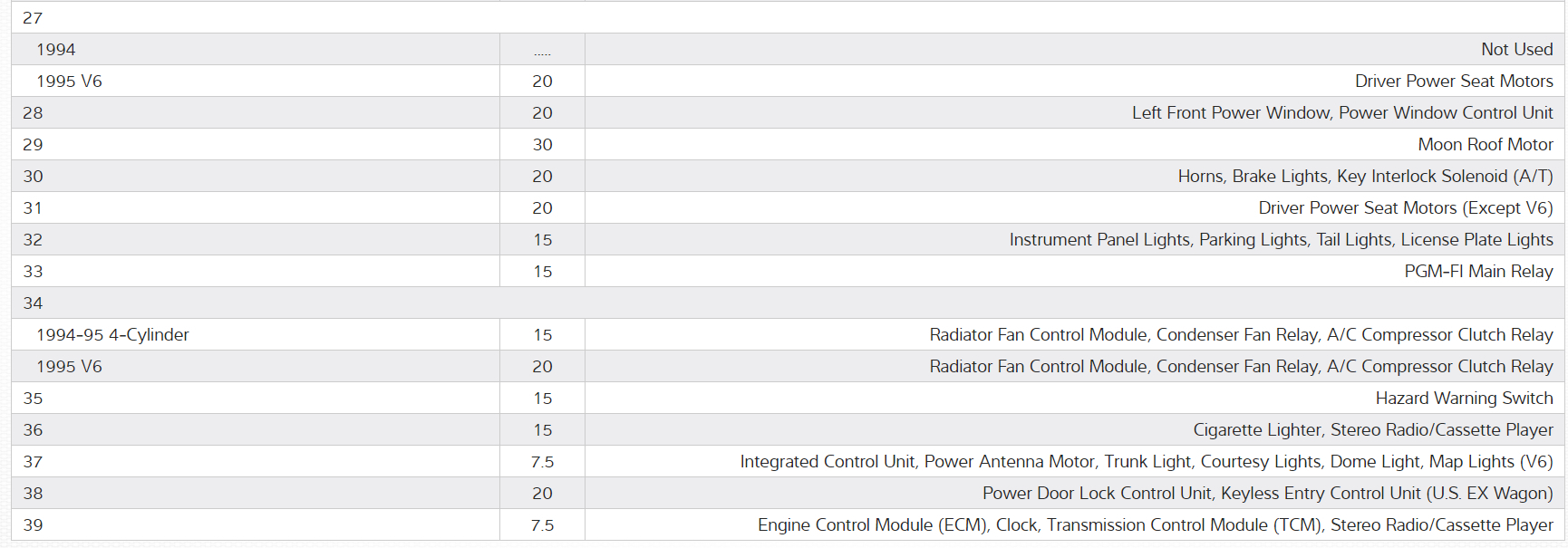

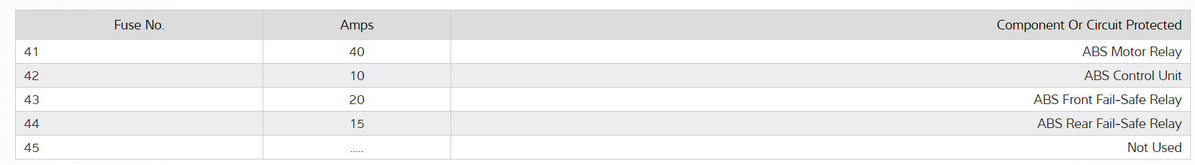

low beam headlight do not work even though high beams works. I change the fuses .
Mar 12, 2018 at 4:10 AM
Experienced Mechanic
55,658 POSTS
There is a headlight relay that sounds like it is out. Here is the location of the relay and a test guide to help you confirm the issue:
Images (Click to enlarge)
