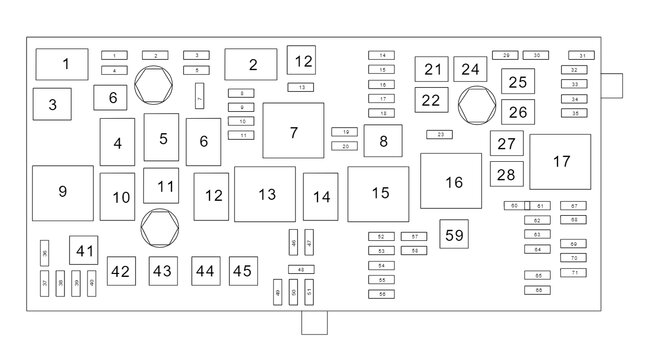

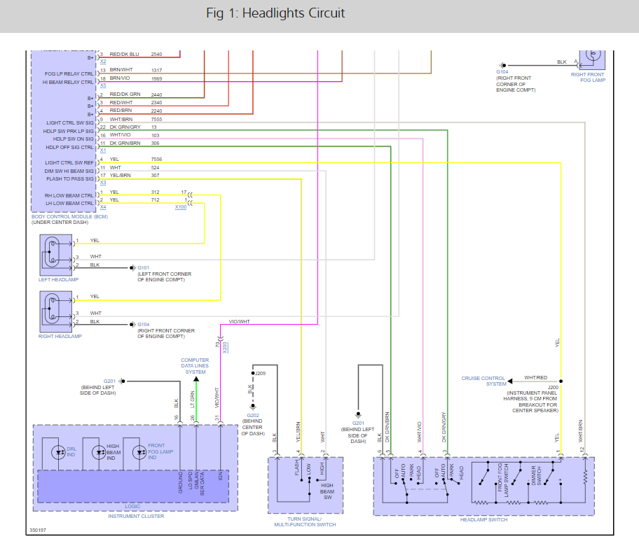

High beams work low beam does not?
2012 CHEVROLET CRUZE
150,000 MILES • 0.5L • 4 CYL • 2WD • AUTOMATIC
LORI CUBIT
Jan 21, 2023 at 2:42 PM
  • 54,832 POSTS

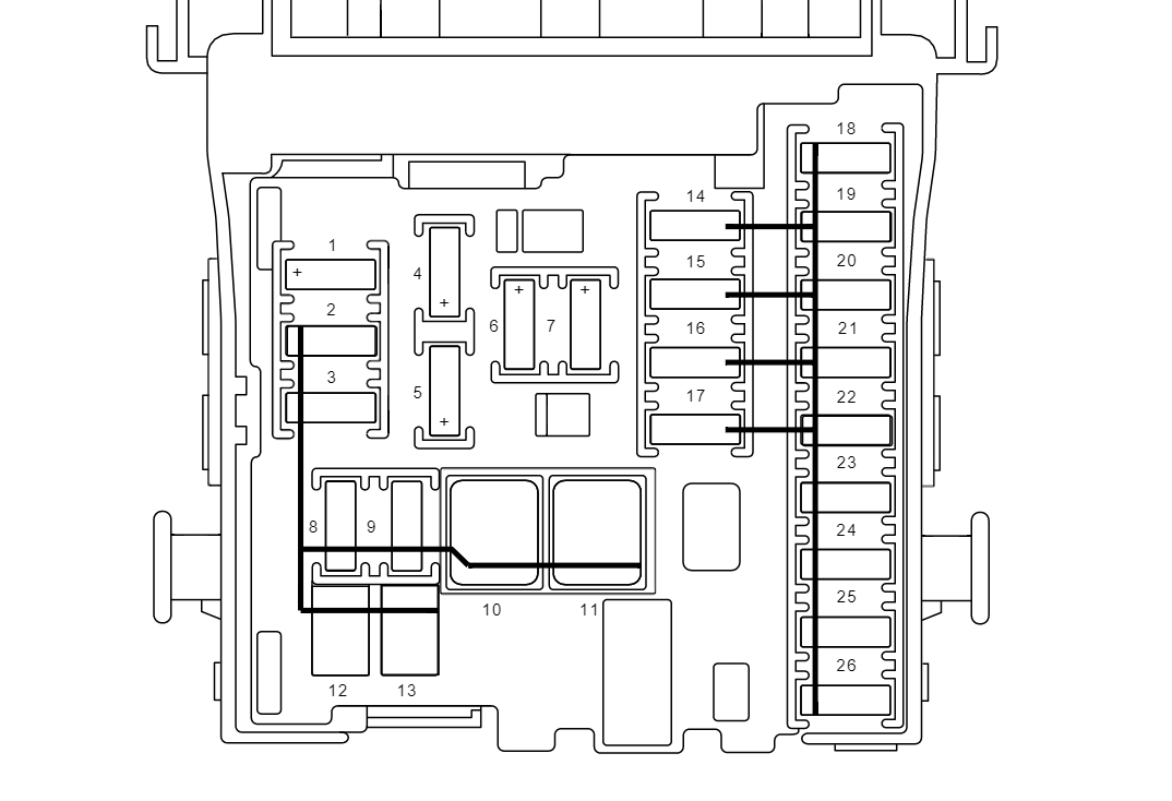

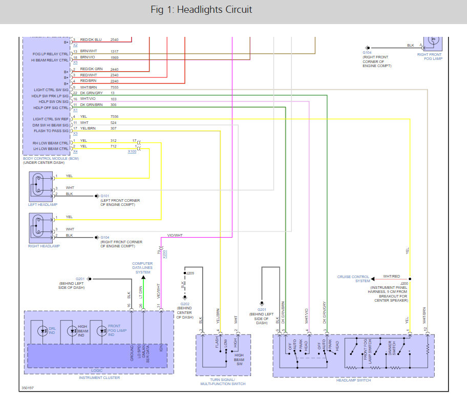

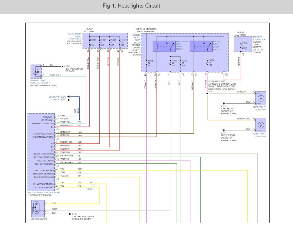

First we need to check the 5 fuses that run the system, # 3, 9, 8, 24 in the interior fuse panel and fuse # 52 in the under-hood fuse panel. Here is a guide to help and I have included the fuse locations and the headlight wiring diagrams so you can see how the system works:
Check out the images (below). Please let us know what you find. We are interested to see what it is.
