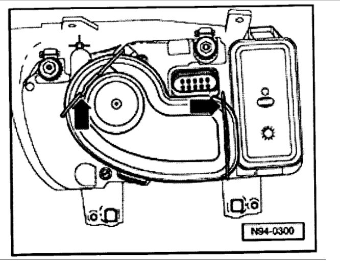

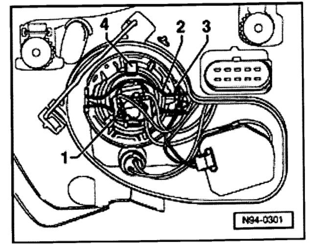

How do you change the headlights? they are halogen bulbs. I do not like paying the $30.00 installation charge for a $10.00 bulb.
Apr 26, 2017 at 12:06 PM
Experienced Mechanic
55,627 POSTS
Here is the instructions for replacing the headlight bulbs in your car with a guide to give you and idea on what you are in for.
https://www.2carpros.com/articles/how-to-replace-a-headlight-bulb
Check out the diagram below.
