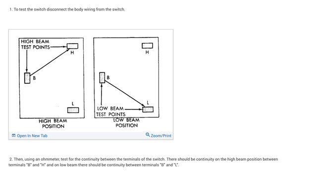

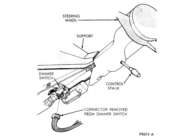

While driving down the road the headlights shut off until I flip the dimmer switch. now a week later they've completely quit working unless I hope the dimmer switch on bright.
Dec 25, 2019 at 9:12 PM
SCGRANTURISMO
  • 4,897 POSTS

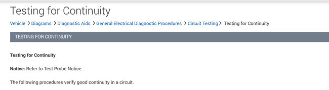

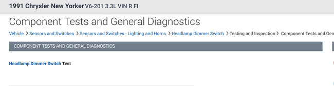

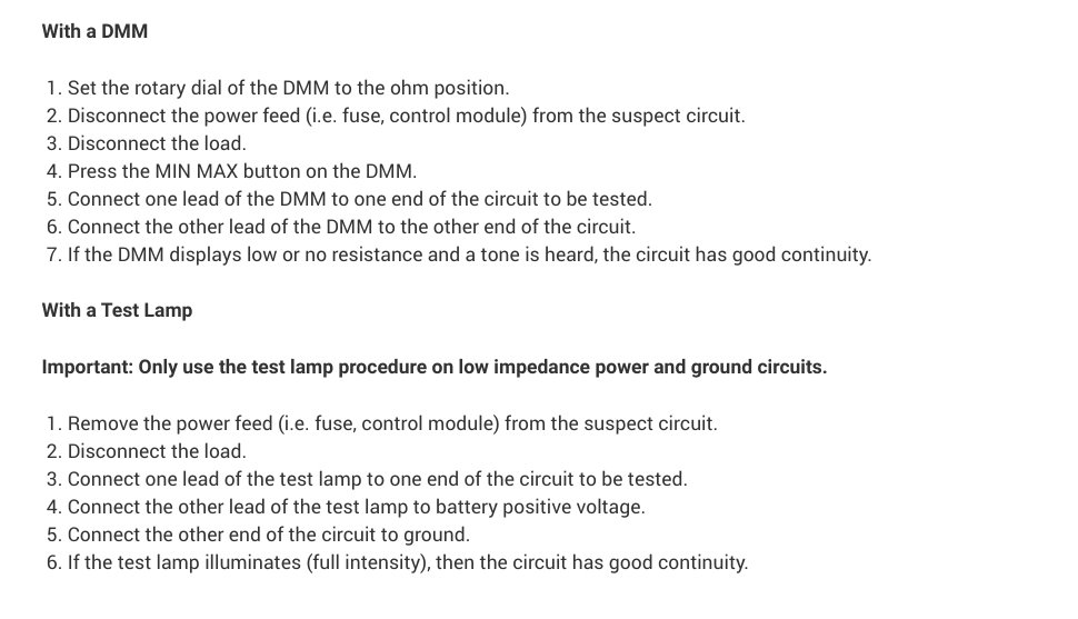

In the diagrams down below I have included the diagnostic test for your vehicle's headlamp dimmer switch from the vehicle manufacturer in the diagrams down below. I have also included a guide on how to test continuity for you as well. You will need to use a Digital Altimeter [DMM], so here is a link below explaining how to use one:
Please go through these guides and get back to us with what you are able to find out.
